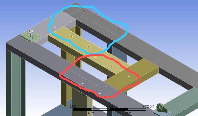

NOT ABLE TO APPLY LOAD Krunal Dhaygude 20 Aug, 2023 01:47 PM I WANT TO APPLY A LOAD OF 300 KG EACH IN BOTH REGIONS AS SHOWN IN THE PICTURE BUT THE PROBLEM IS ALL ARE DIFFERENT FACES AND I WON'T BE ABLE TO SELECT FACES....IS THERE ANYTHING IM MISSING? WhatsApp Image 2023-08-20 at 6.31.21 PM.jpeg 1 Answer Muhammed Altamash Khan Answered on 23 Aug, 2024 01:55 PM Use filter option face select by pressing shortcut key 'Ctrl + F' then select the face.
