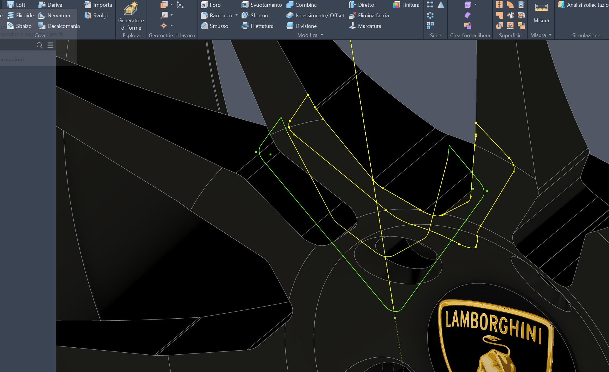

Projected profile extrusion Mauro 24 Dec, 2024 04:55 PM How can I extrude by cutting this projected profile by 10 mm? Thank you. Screenshot 2024-12-24 175004.png 1 Answer Bob Wiley Answered on 24 Dec, 2024 05:13 PM You can only extrude a 2d sketch. A projected 3d sketch cannot be extruded. What you may try is to sweep a simple 2d sketch along that 3d sketch using it as a path.
