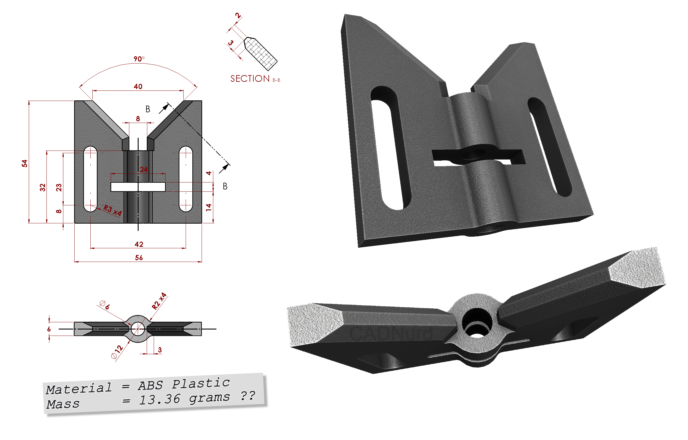

After the astonishing results of our last challenge, SolidTweaks suggested making this new challenge based on this question we got earlier today...
It's better to model it using these dimensions, especially since the resulting mass is included in the image and that can be used as a reference while modelling this part.
Let's see what you'll come up with!
It may seem trivial at the first glance, especially since one might suggest making it like this:Â Extruded Boss > Extruded Cut > Chamfer, but I suggest you take a closer look at the chamfer :)

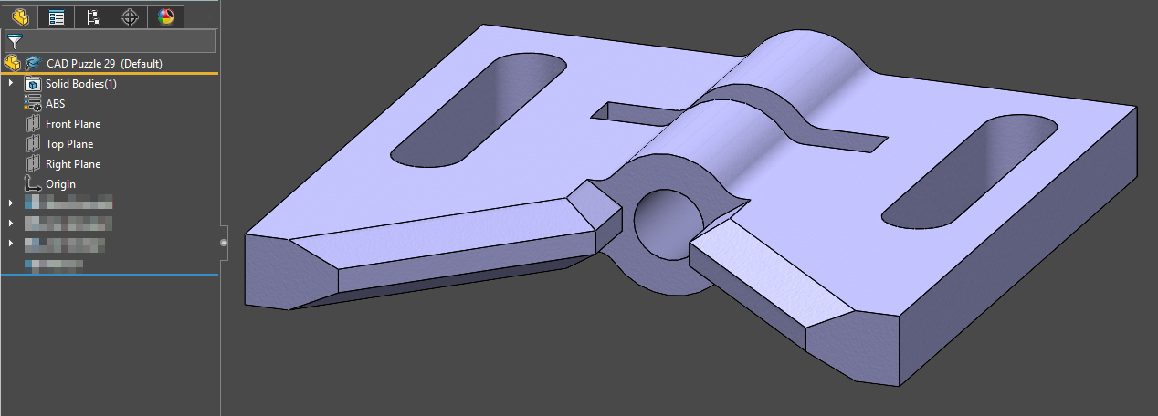

This is my first attempt using 4 features:

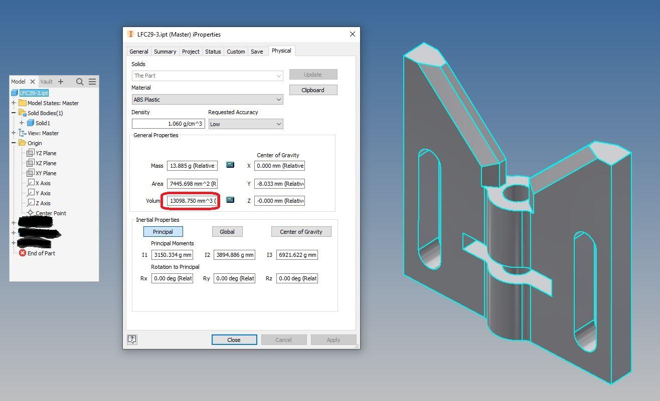

3 simple features. Inventor evidently uses a different density for ABS so we'll have to compare volume which looks correct.

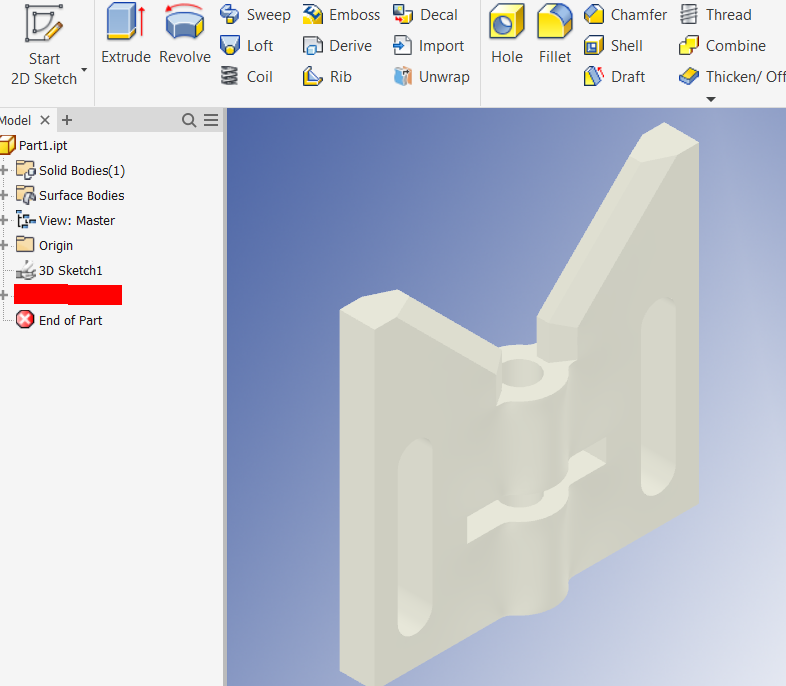

well I waited for a while but here she is with only 1 feature. Would never ever do it this way as it takes ages,
