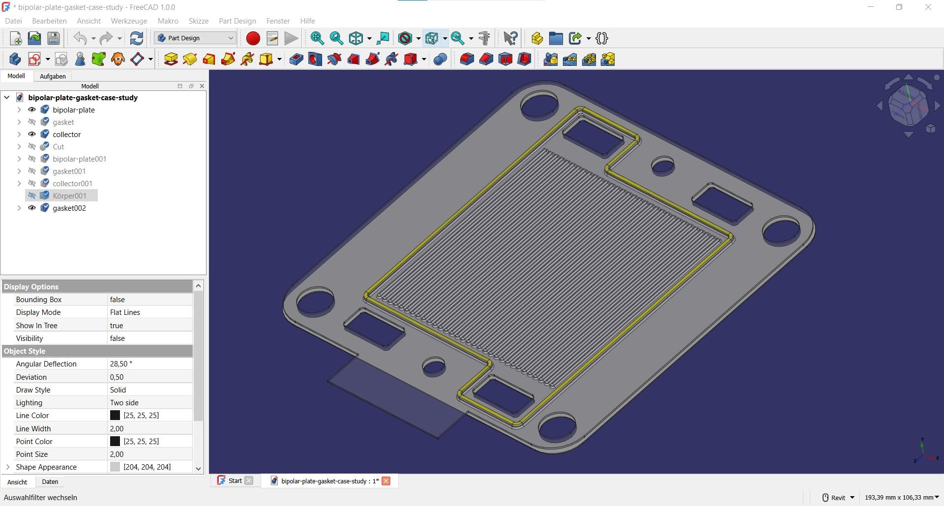

  1. Creating the CAD model in FreeCAD:

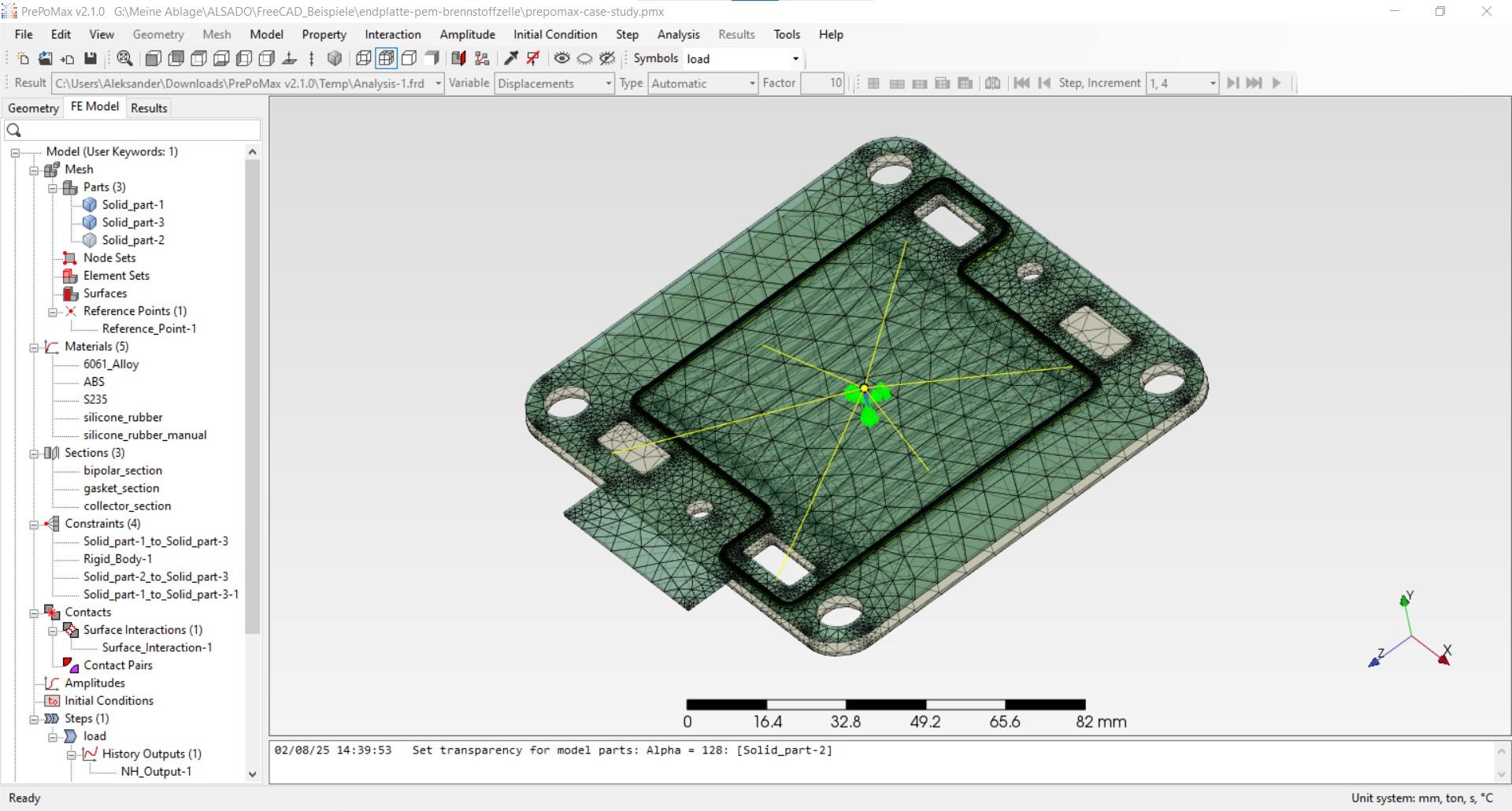

  2. Setting up the FEM study by meshing the CAD model and setting the boundary conditions in PrePoMax:

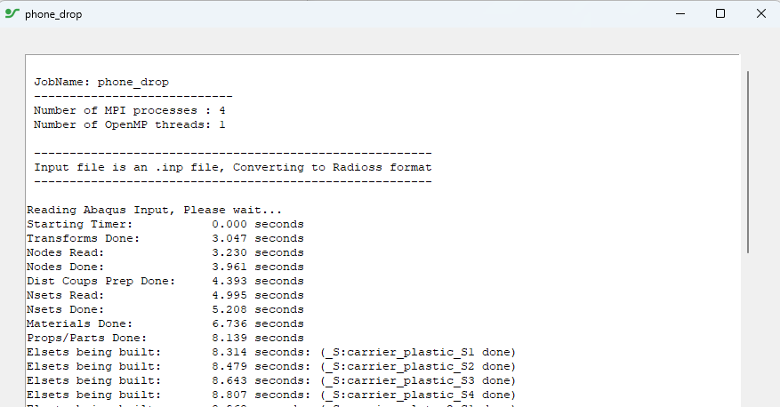

  3. Solving the case study from the PrePoMax INPUT-file in OpenRadioss:

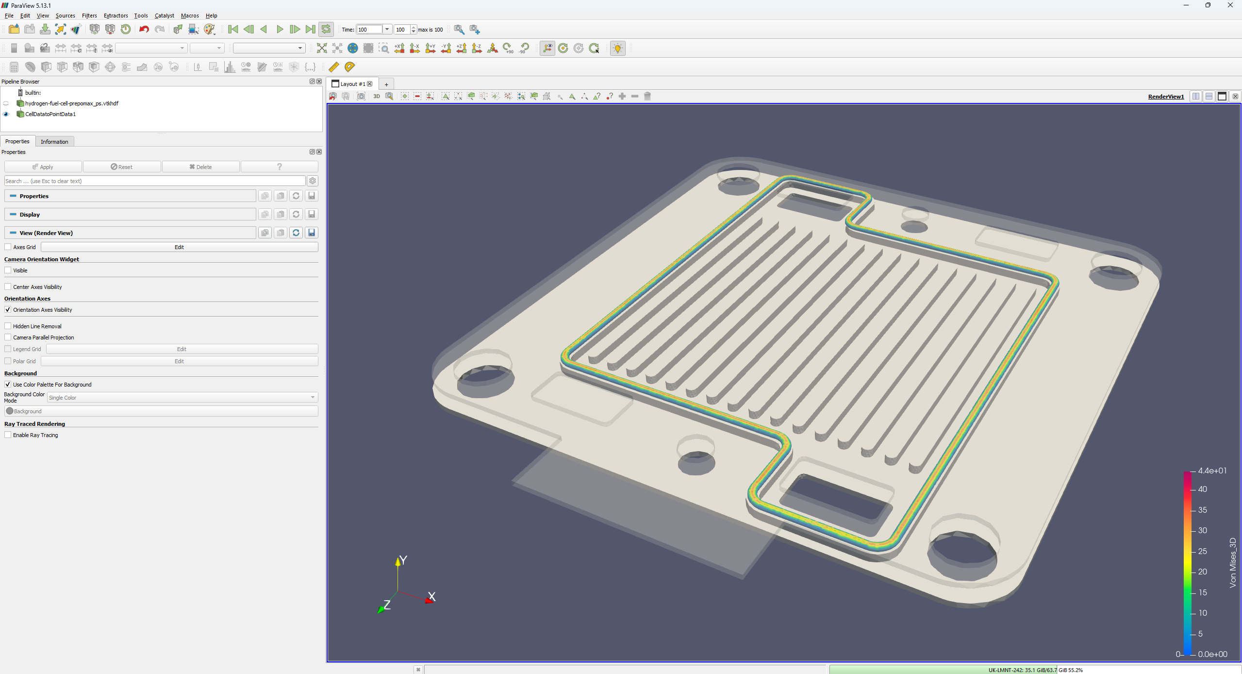

  4. Visualizing the results in ParaView:
