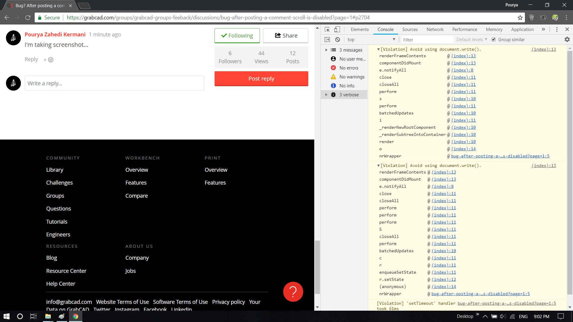

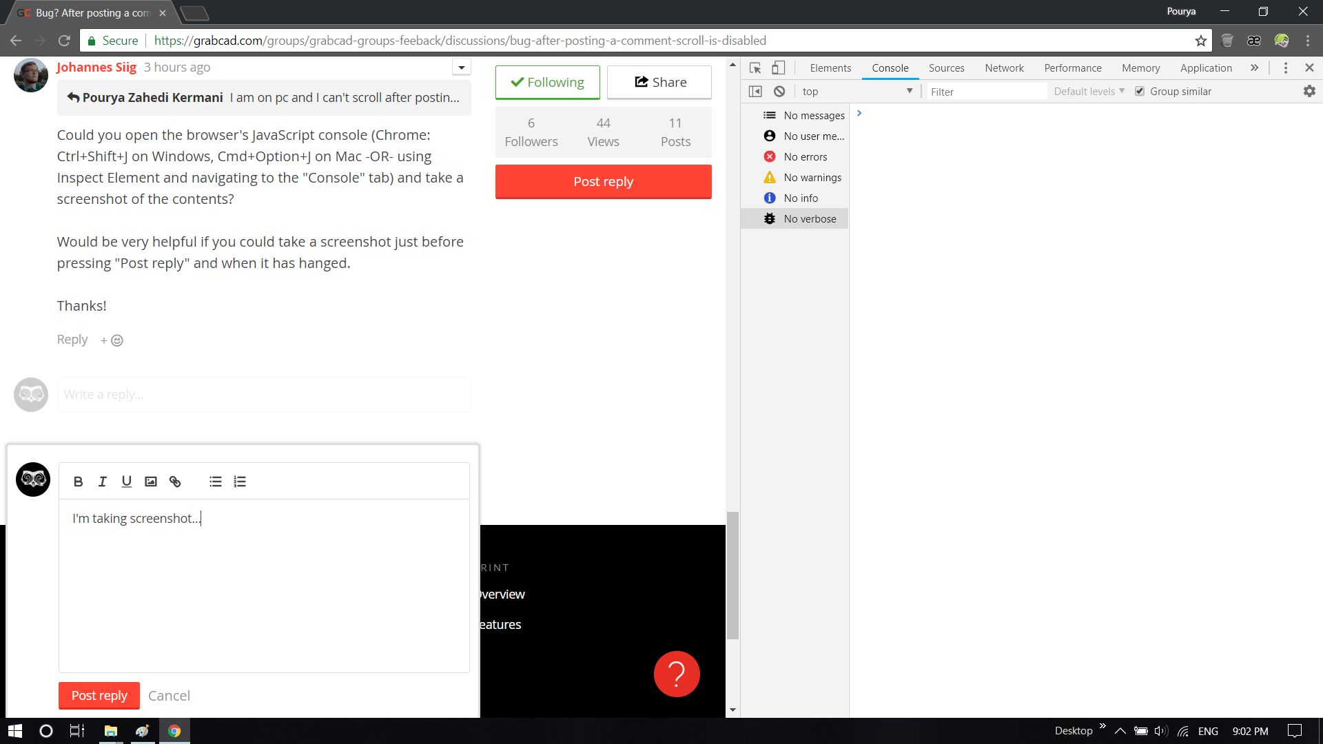

Could you open the browser's JavaScript console (Chrome: Ctrl+Shift+J on Windows, Cmd+Option+J on Mac -OR- using Inspect Element and navigating to the "Console" tab) and take a screenshot of the contents?
Would be very helpful if you could take a screenshot just before pressing "Post reply" and when it has hanged.
Thanks!
Thanks!
