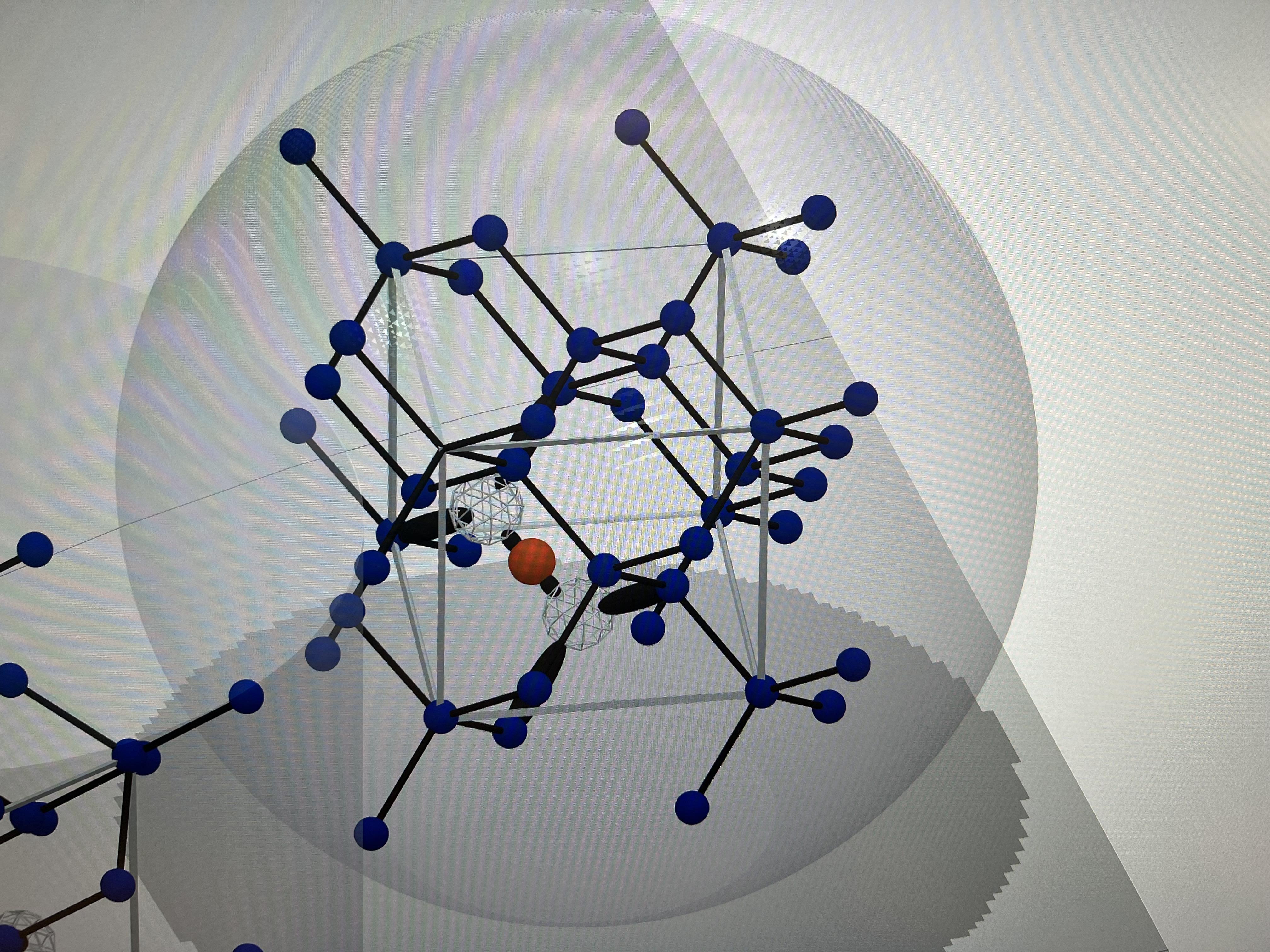

I then made a SolidWorks assembly of those parts and loaded that assembly into GrabCAD Print. There was no option to choose a priority for the components of the assembly, so I thought GrabCAD was smart enough to do the Boolean subtraction. Everything showed properly on-screen, and I was able to assign materials to each component of the assembly.

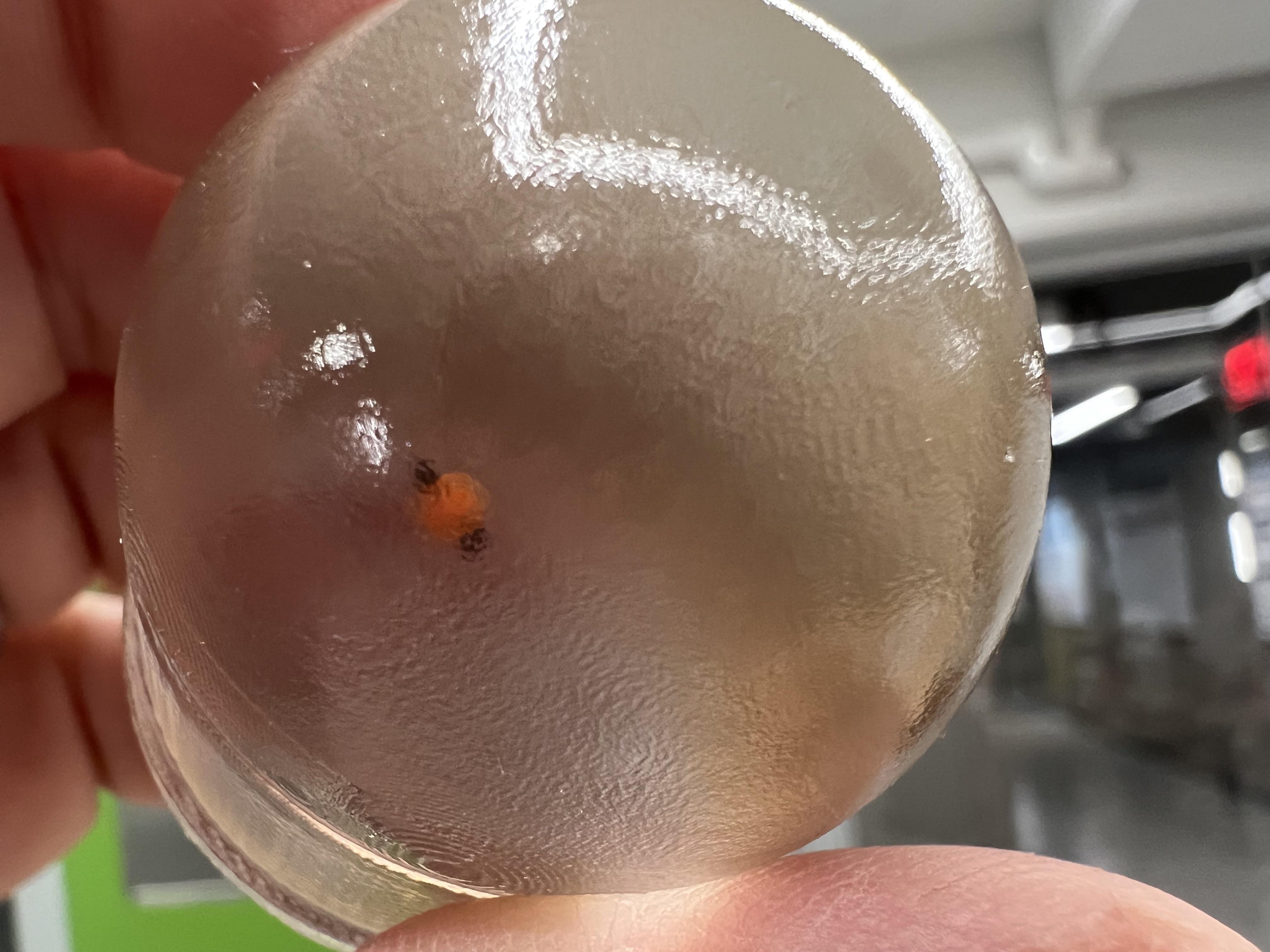

It did not print as it appeared on the screen. Oddly, one of the assembly components and two parts of another did show up inside the clear portion. Nothing about the order in the assembly file explains what happened.
