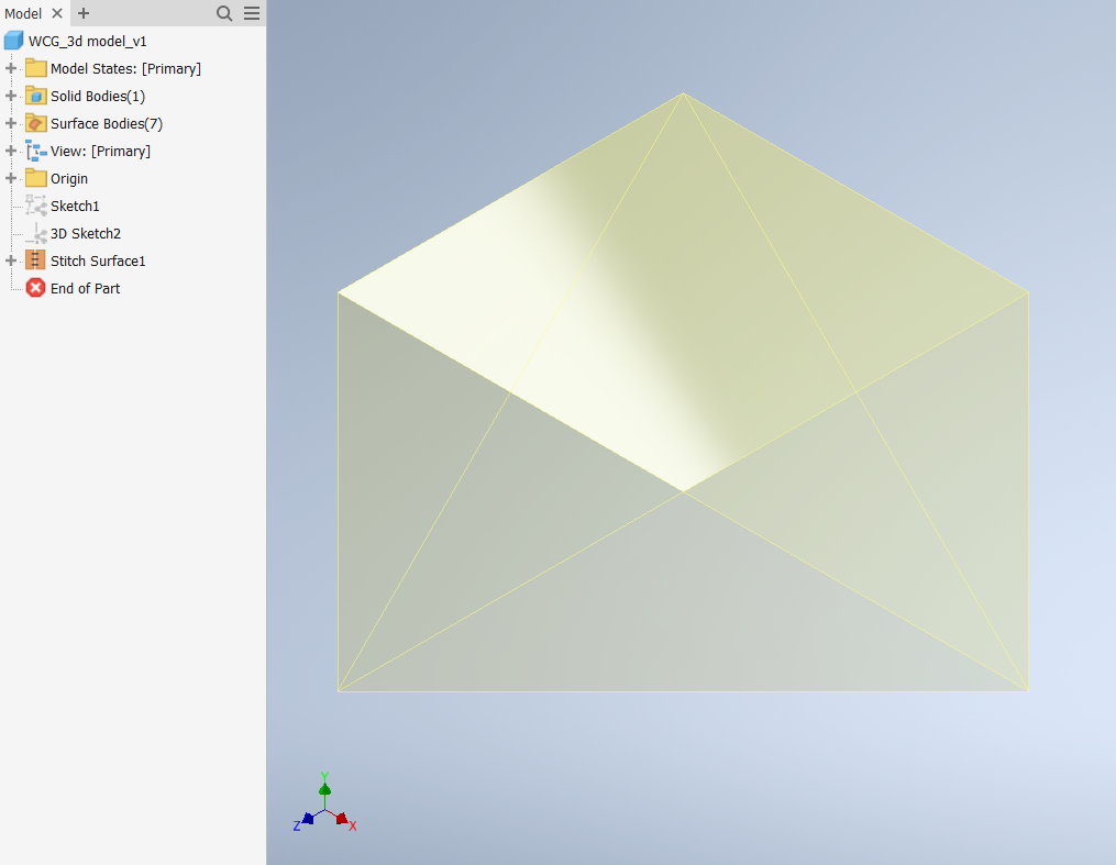

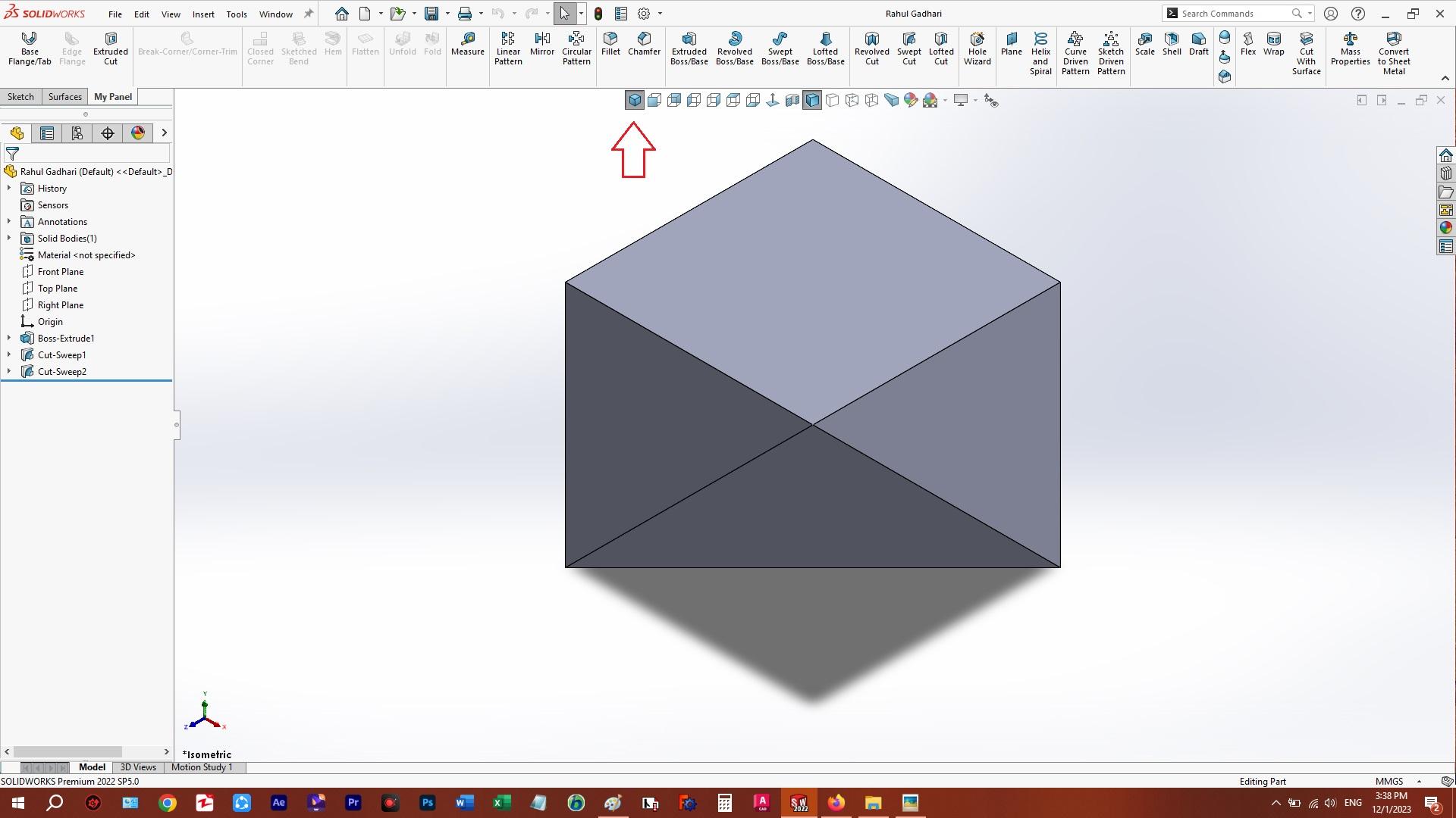

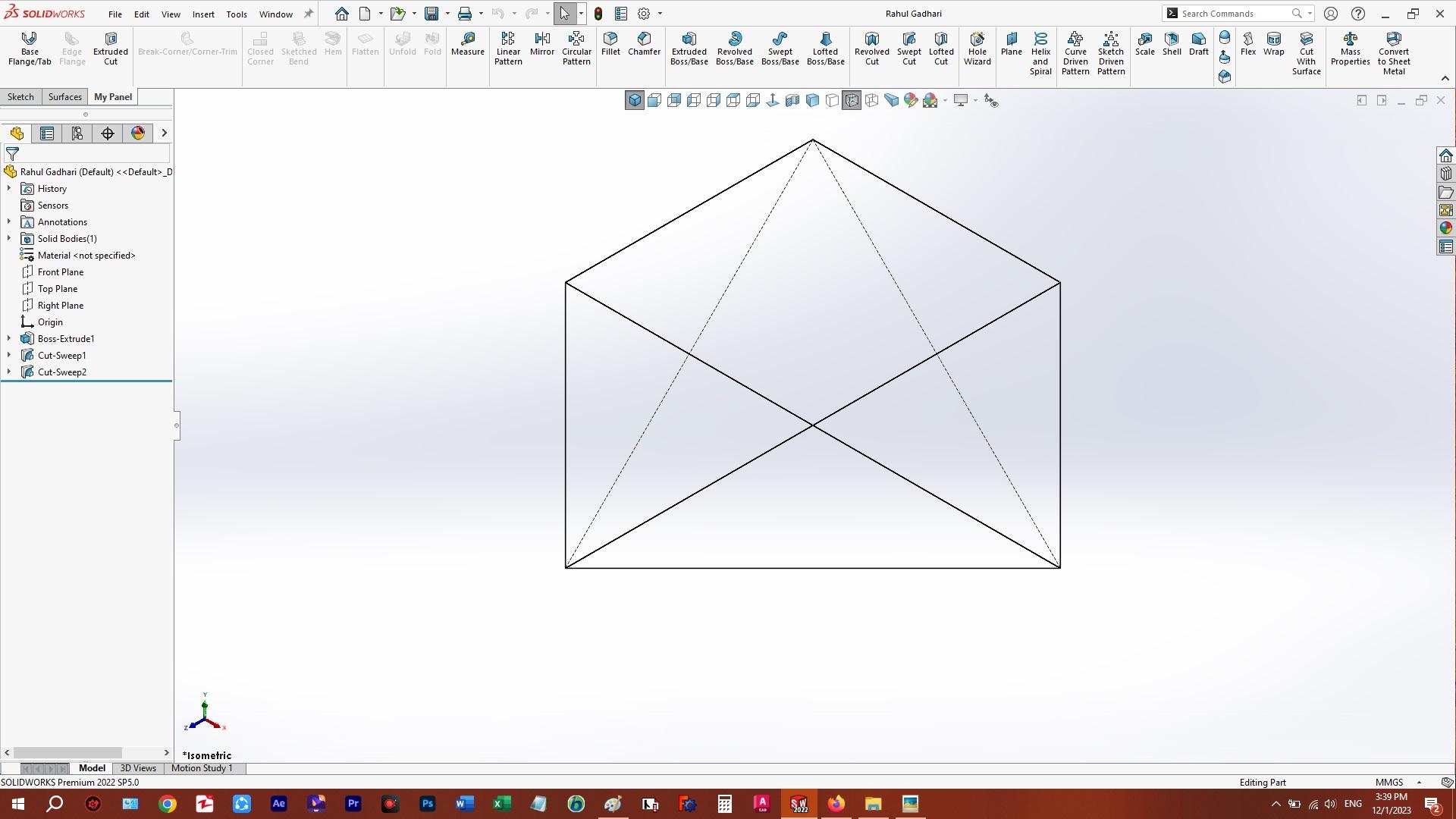

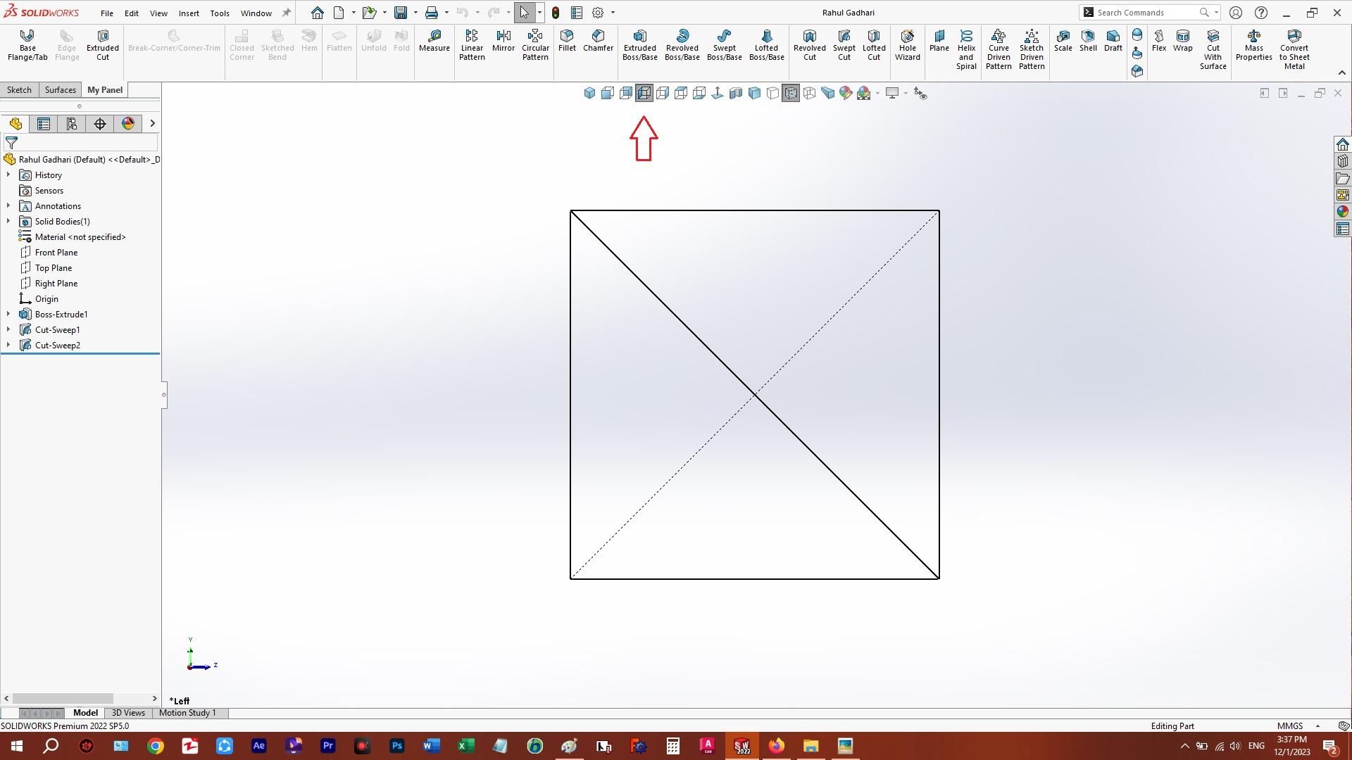

Hello Rahul!

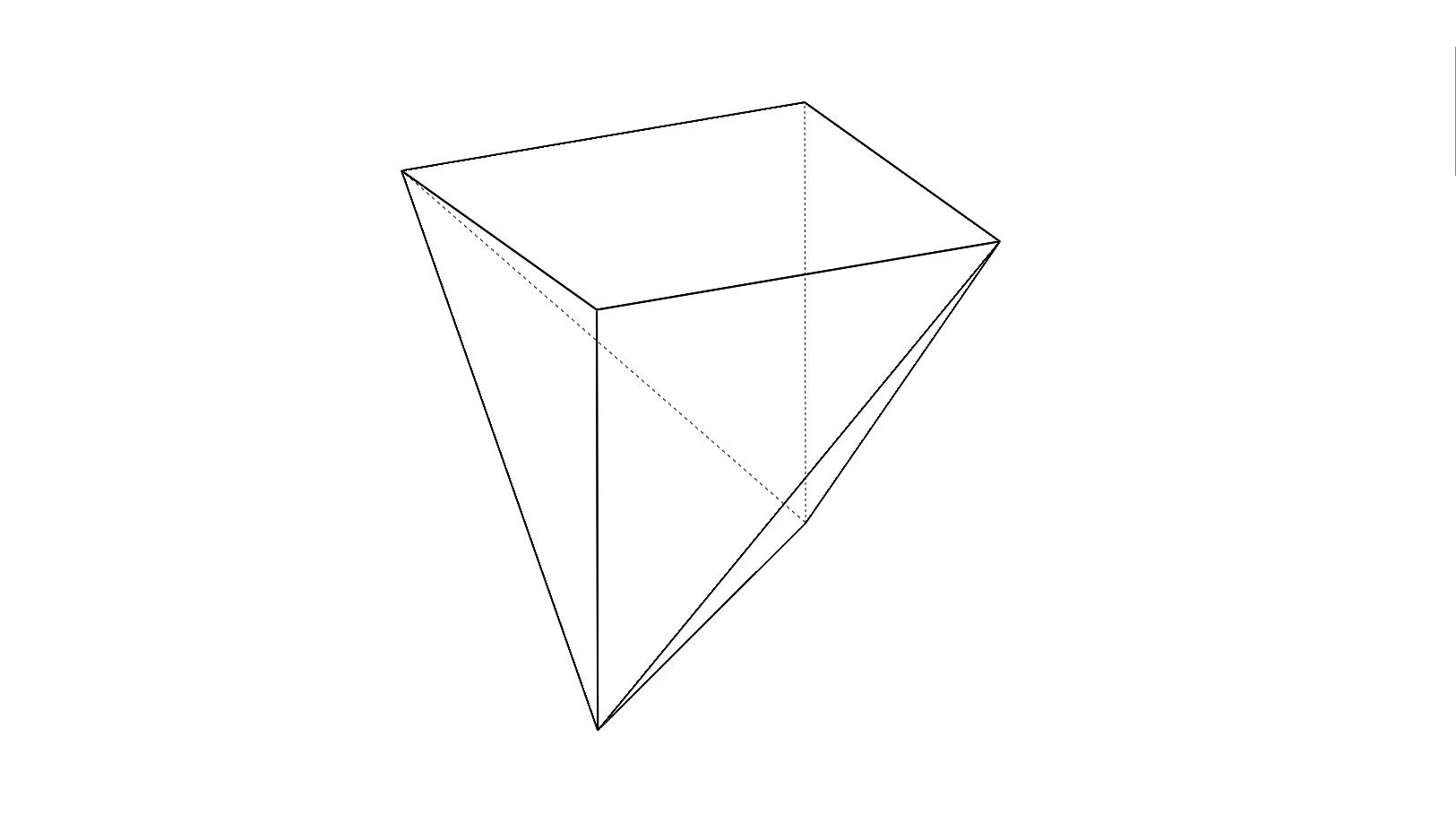

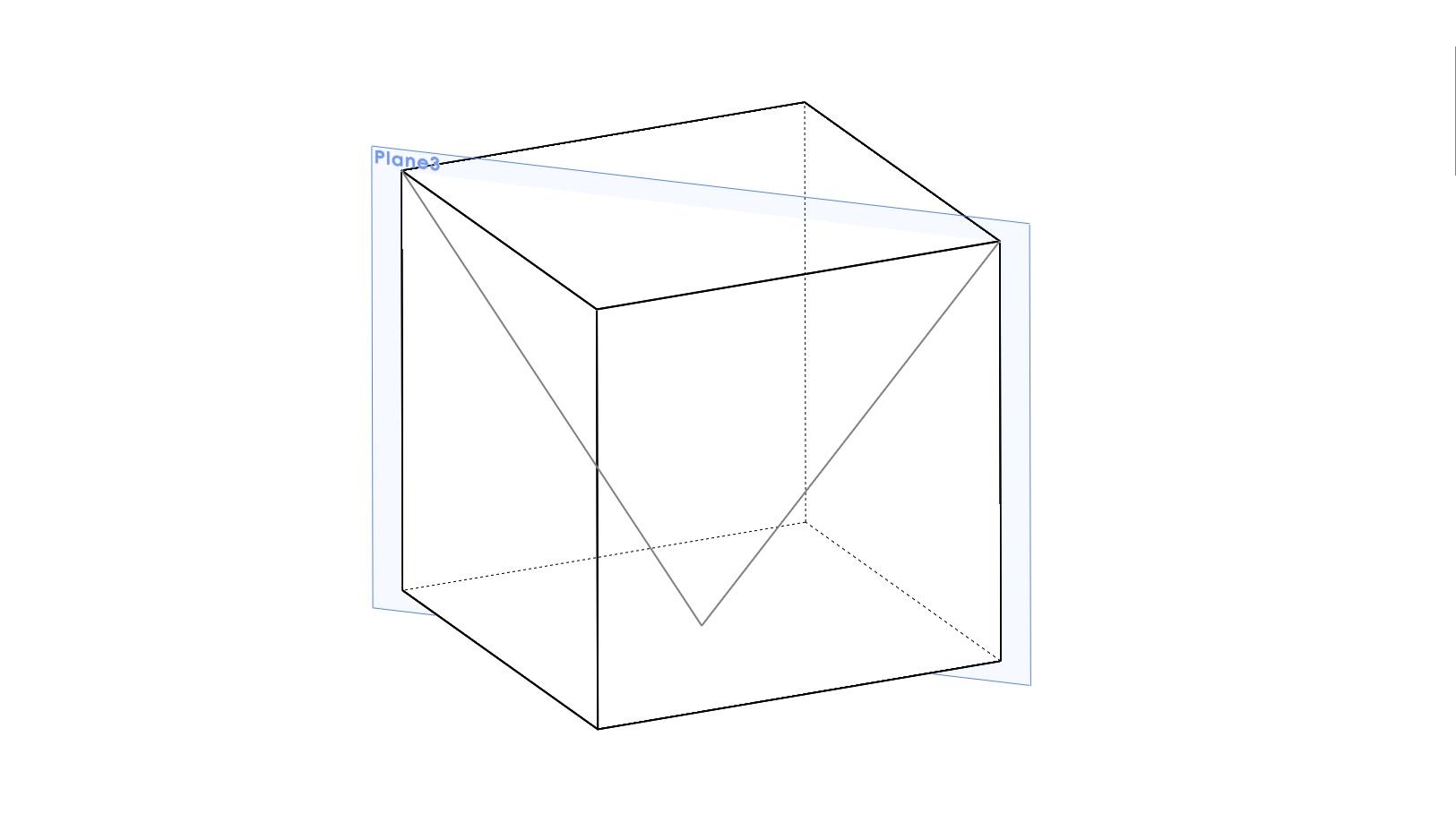

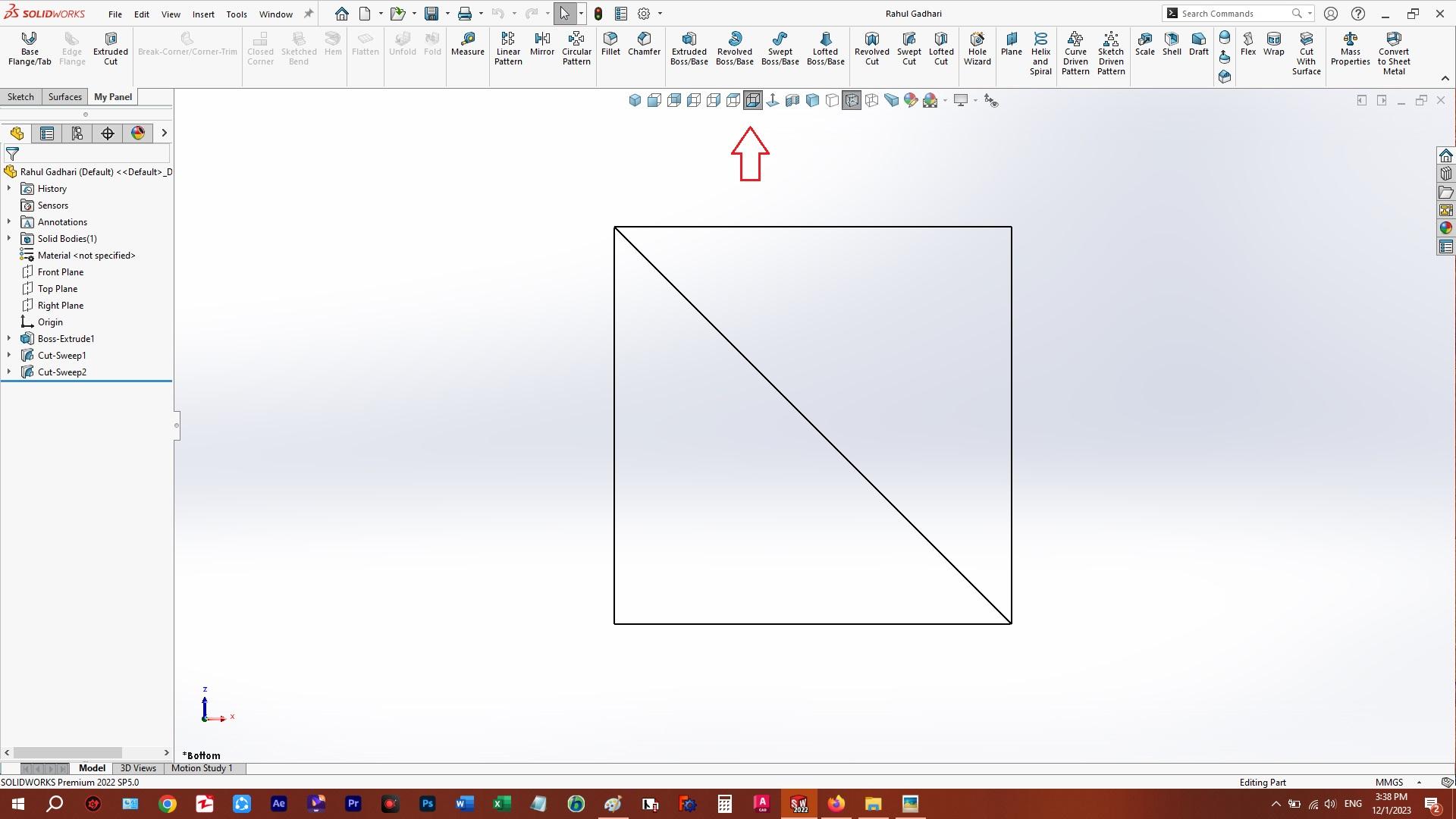

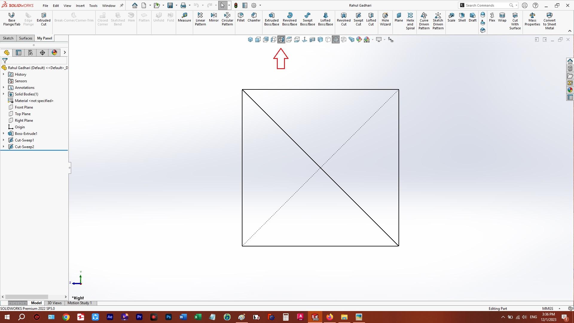

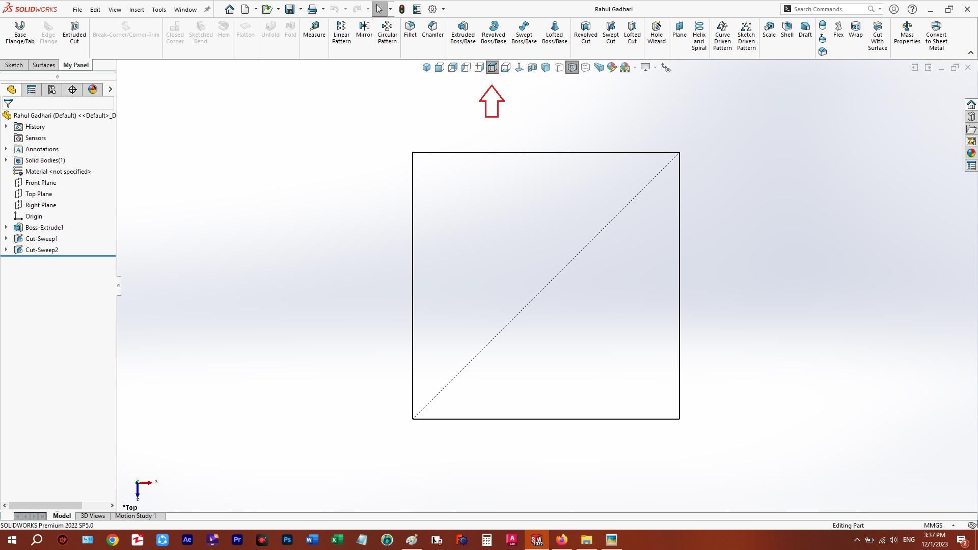

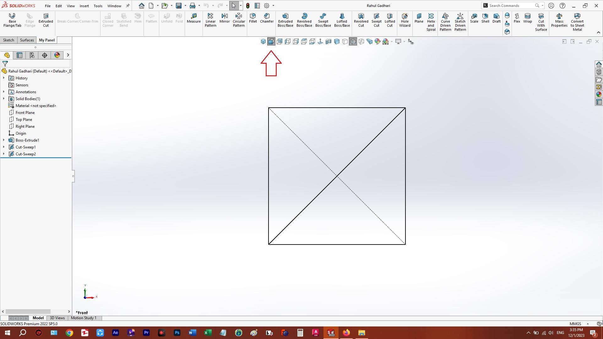

The solution (Vahid), explained on a cube with two cuts through inclined planes.
Greetings.
PS: for a next challenge it would be better if you explain a little what it consists of (example: draw it with the fewest operations possible, or interpret possible shapes that generate the views shown - do not forget to say if they are ISO "A" or " E", etc.)

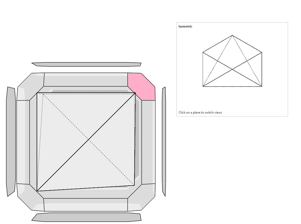

When you look at it from the isometric point of view highlighted in pink, you get the view that @Vahid showed
