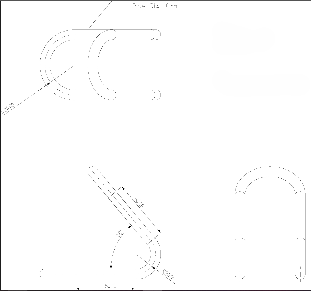

Sachin Kumar 16 Jul, 2024 11:12 AM Not that challenging but hope you like the challenge.The challenge is to make the 3d of above DrawingWithout Using :--3D sketch-Extrude cut-Sweep-Reference plane

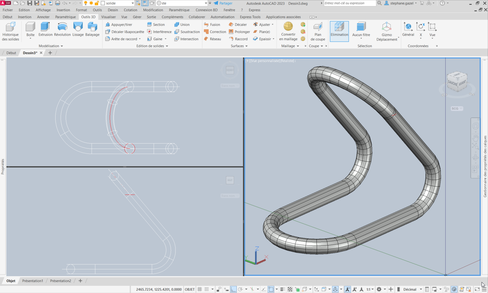

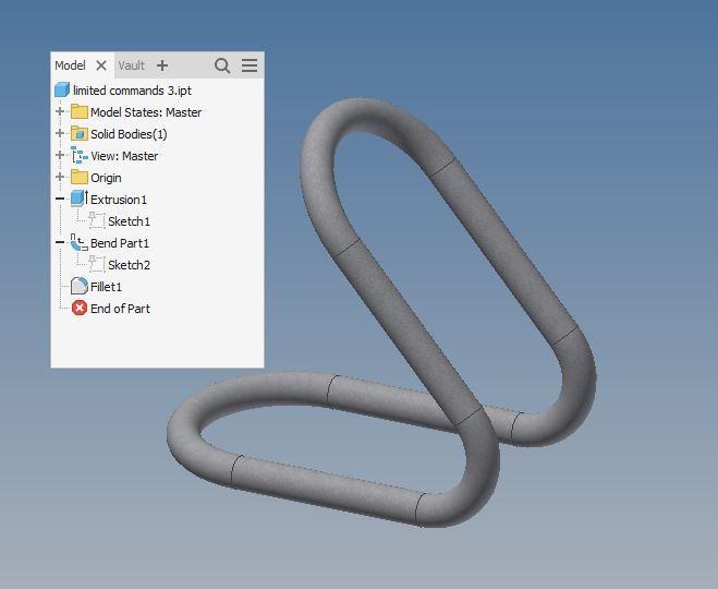

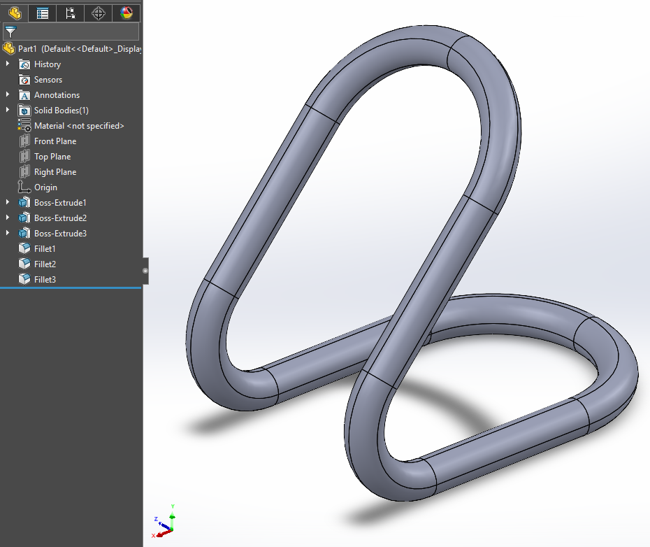

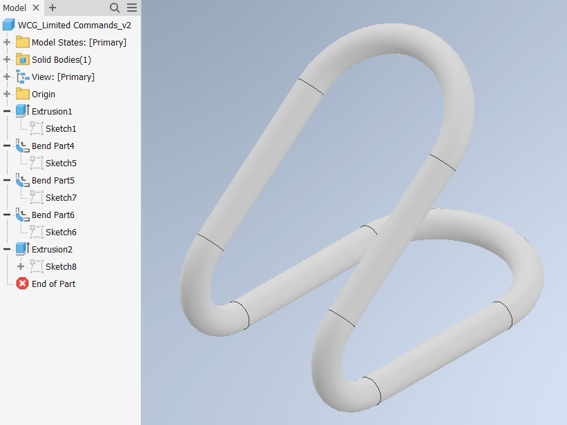

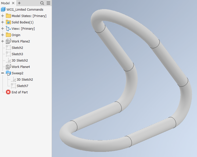

Bob Wiley Jul 16, 2024 Simple extrusion, bend and filets using Inventor. Carlos J. Veloso Jul 16, 2024 I am thinking... should I use my drafting table, or shape it using 10mm flexing tubing, or just 3D print the thing. Maybe I can avoid all of the above if I can find a 2D scanner to yield a 3D image. Steven Kiley Jul 16, 2024 Extrusions and fillets: Jeroen Jul 18, 2024 Done (Inventor)Question:I have a lot of trouble constraining a 3D sketch, does someone have tips or tricks for this? I usually make a few 2D sketches and connect them with 3D ones. This works but not in challenges like this where minimal steps are required. Sachin Kumar Jul 18, 2024 Jeroen Done (Inventor)Question:I have a lot of trouble constraining a 3D sketch, does someone have tips or tricks for this? I usually make a few... But the challenge is to make the part without using 3d sketch, sweep or reference plane. Jeroen Jul 18, 2024 It turns out reading is difficult, so here is version 2 Stéphane Gazel Aug 9, 2024 HiOn AutoCAD:cylindreTore-soustraireTore soustraireMrroir Log in or sign up to post a reply
