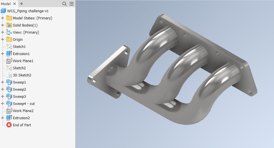

My goal was to make this model as efficiently as possible. Total time from firing up Inventor was 22 minutes. Secondly, my aim was to place the flange faces on two of the base workplanes. This would make subsequent constraints in an assembly a little easier. No dimensions are fudged. All dimensions are exact or parametrically derived.
I made a couple of assumptions.
It was a good challenge that turned out to be simpler than I originally thought. I too needed more than 22 minutes but practice makes prefect, and now I can strive to improve my speed.

The key to the whole design was this first sketch. It serves as part of the path for the sweep and sets the angle of the 50mm curved section. Note the odd reference angle but it produces a perfect tangency.
[edit] The way I have it only works if you do a true 50mm radius and not a projected 50mm. If you do a projected radius then the 50mm dimension in my sketch would be the vertical distance and not the angled distance. (Not sure if that makes sense.)
A projected radius adheres strictly to the challenge sketch but it produces a pipe with a spiral shape rather than a simple radius. That's something unlikely to be done in the real world. I think the way you have your path generated, you used the projected radius.
If you do a projected 50mm radius then it would look something like this. Note the different reference angle.
This is with the original drawing overlayed on the projected dimension. Doesn't match.
And with the true radius. Looks good.

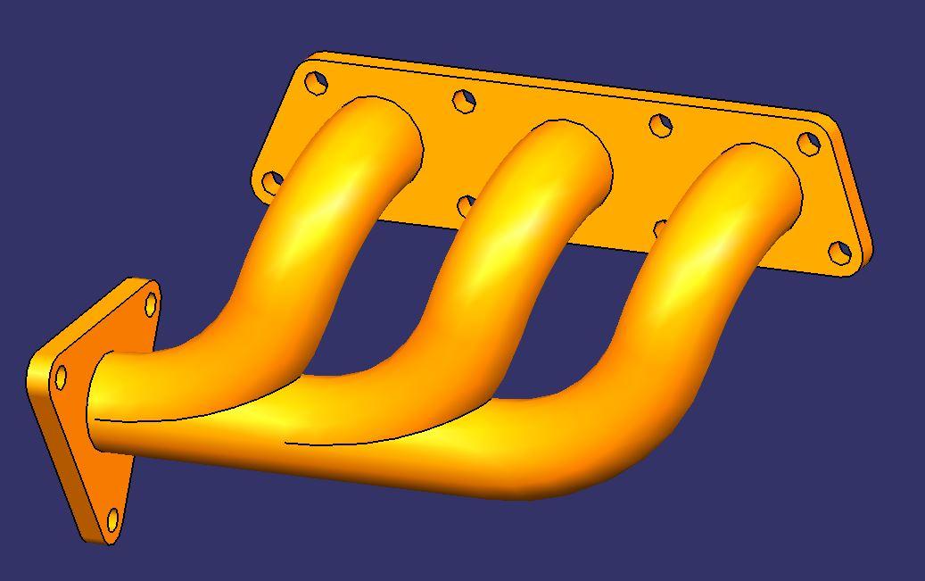

HI Steve, you are right I got the long flange backwards. I also was happy to see the input from Bob about the double tangent. I too had that issue and it took some work to get things right. These things are what makes these challenges very useful. I am using FreeCad, I am not sure if it is a good platform compared to Autocad, but it is what I have. The good news for me is that there are many tutorial videos out there that really help to improve my skills.

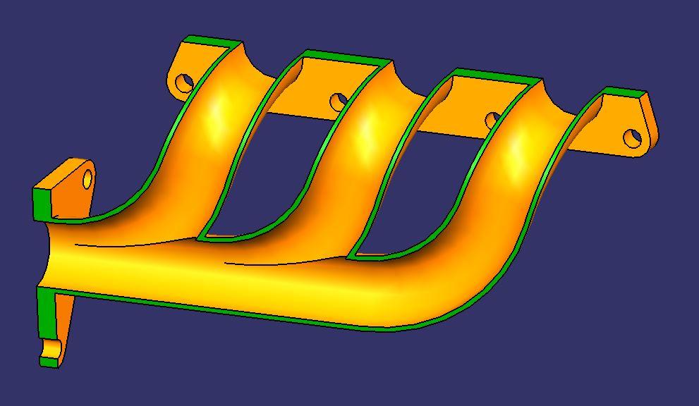

I started this a couple days ago and just finished it up tonight - obviously more than 22 mins with CATIA V5. Nice little exercise with the pipes being something I haven't done for awhile.

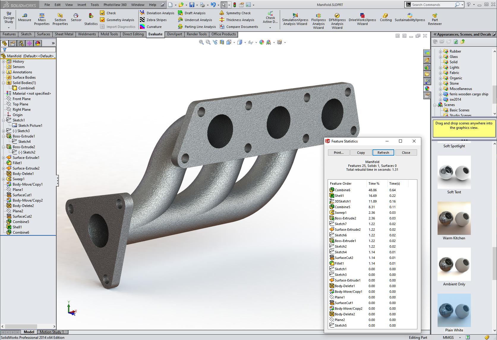

53 minutes in Solidworks. The main sketch took a while... and then I got an error when trying to merge the 3 swept pipes. Nice challenge.
