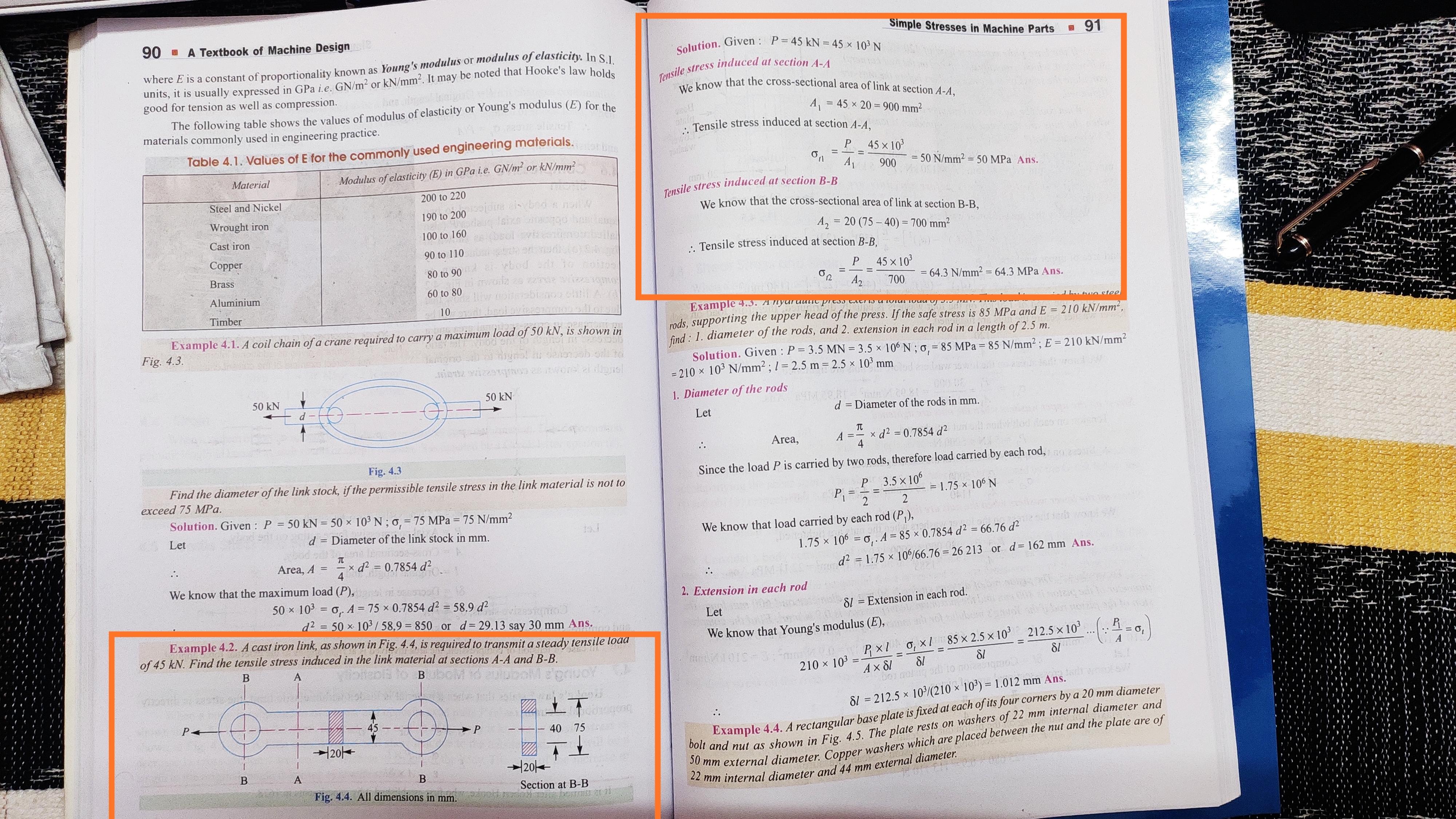

A cast iron link is required to transmit a steady tensile load of 45kN. Find the tensile stress induced in the link material at sections A-A and B-B. Avinesh jain 17 Mar, 2020 04:46 PM How to find near result using SolidWorks? Question and answer attached! IMG_20200317_221347.jpg
