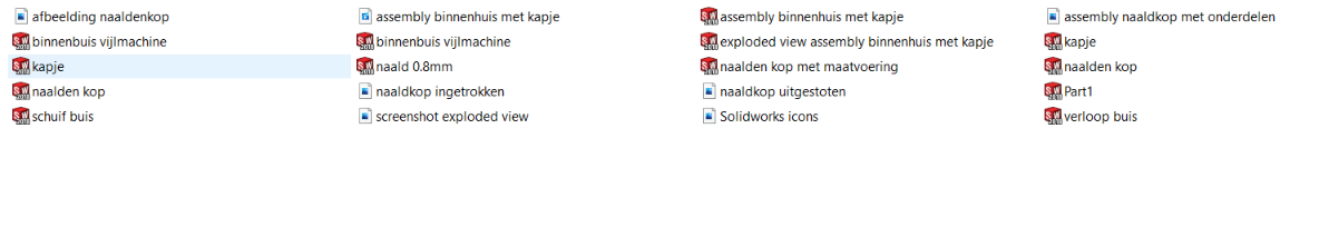

In Solidworks 2018 all my part/assembly/ drawings files have the same icon,
this makes finding part files difficult without first opening the file,
I can only recognise the different files if i change the folder view settings to large pictograms
Has anybody a solution for this problem ?
As long as you have both the file name extensions hidden and the layout set to one of these three (Details, List or Small Icons), it'll be impossible for you to differentiate between the files...
Start by changing one of the 2 things I mentioned, then make sure you allow SW to show a preview of the models:
