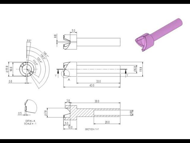

Anyone can give some difficult parts drawing PDF to design in SOLIDWORK, UG NX and AutoCAD ?
I am practice during this lockdown. So please send me drawing so i can increase my drawing skills.

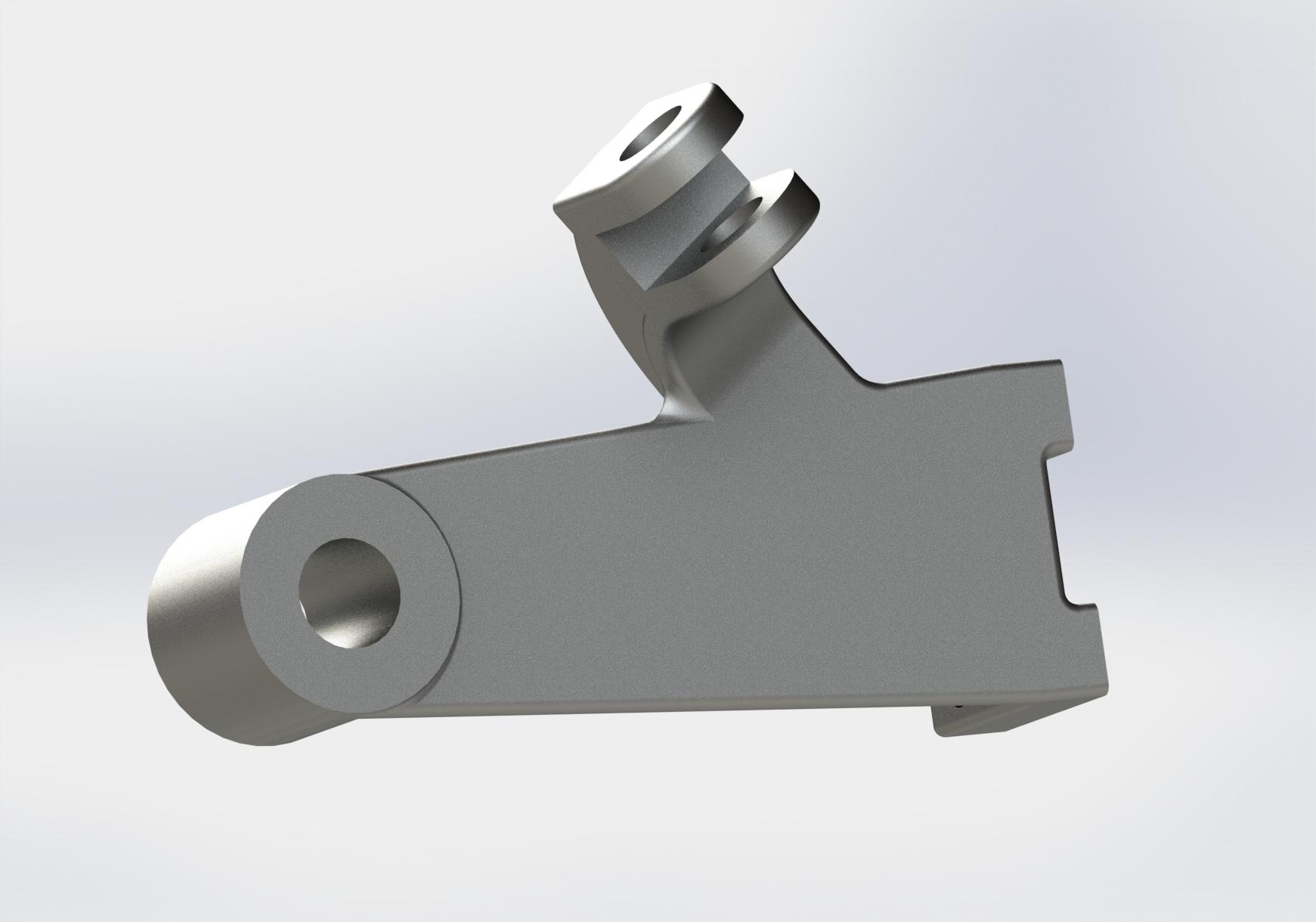

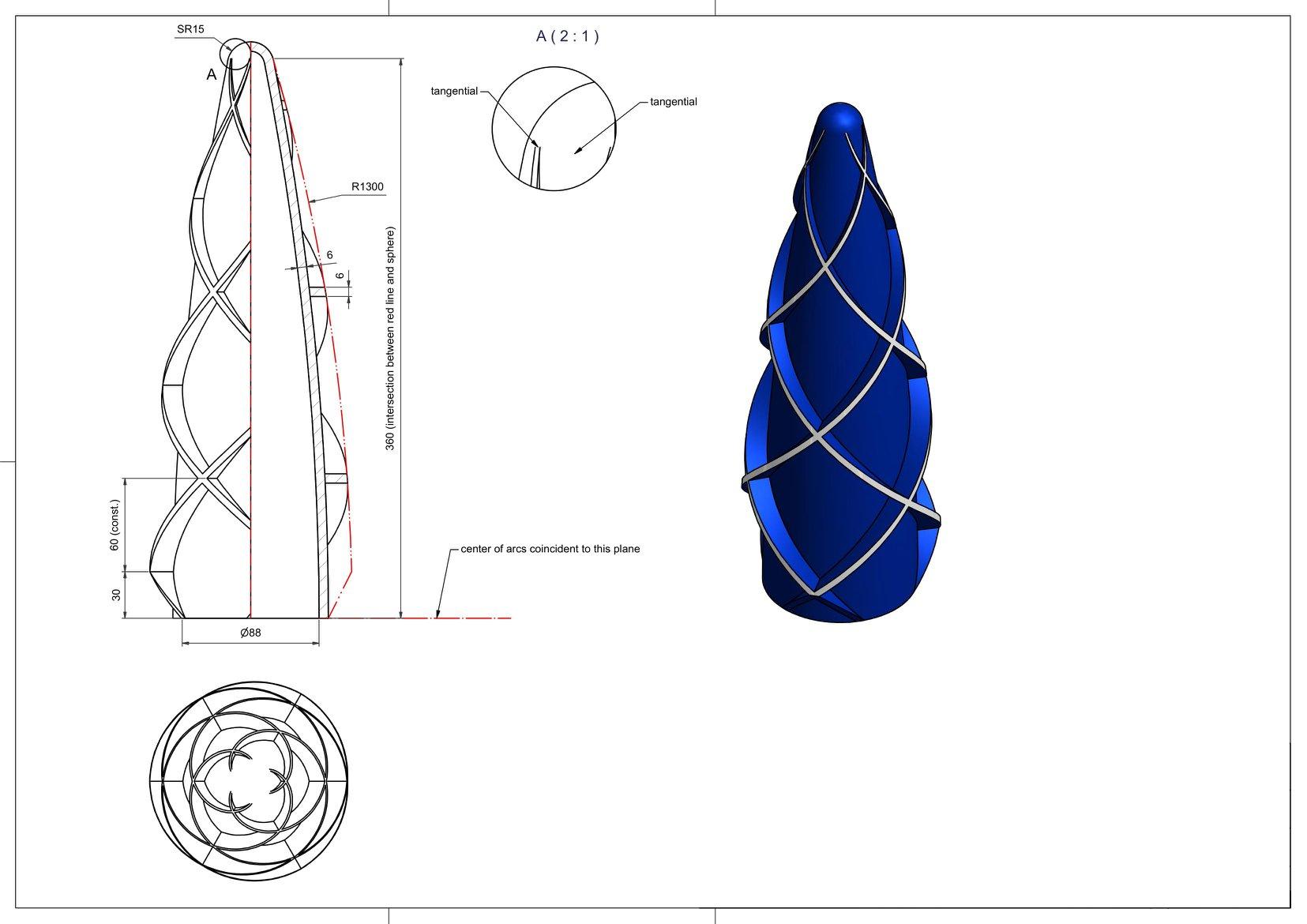

All dimensions per (Original.png) drawing, modeled with SW2019.
Part1a.step, SW Standard 5mm Radius.
Part1b1.step, 5mm Radius done with SW surfacing.
Basic SW Radii are on (Part1a) are probably not what you would send out for production.
Making the R19 & R8 smaller by 5mm or so, would help improve the geometry at the R5 junction without changing the 70mm dimension.
This one does not look difficult at all, but I've never been able to get the model built to the dimensions shown. Give it a try, see what you get.
The problem area for me is where the 19mm radius intersects with the rest of the model near the R5 fillet. I can make it work by changing the 70mm value to be 75mm or so, but at the shown dimensions, the model does not work (for me)

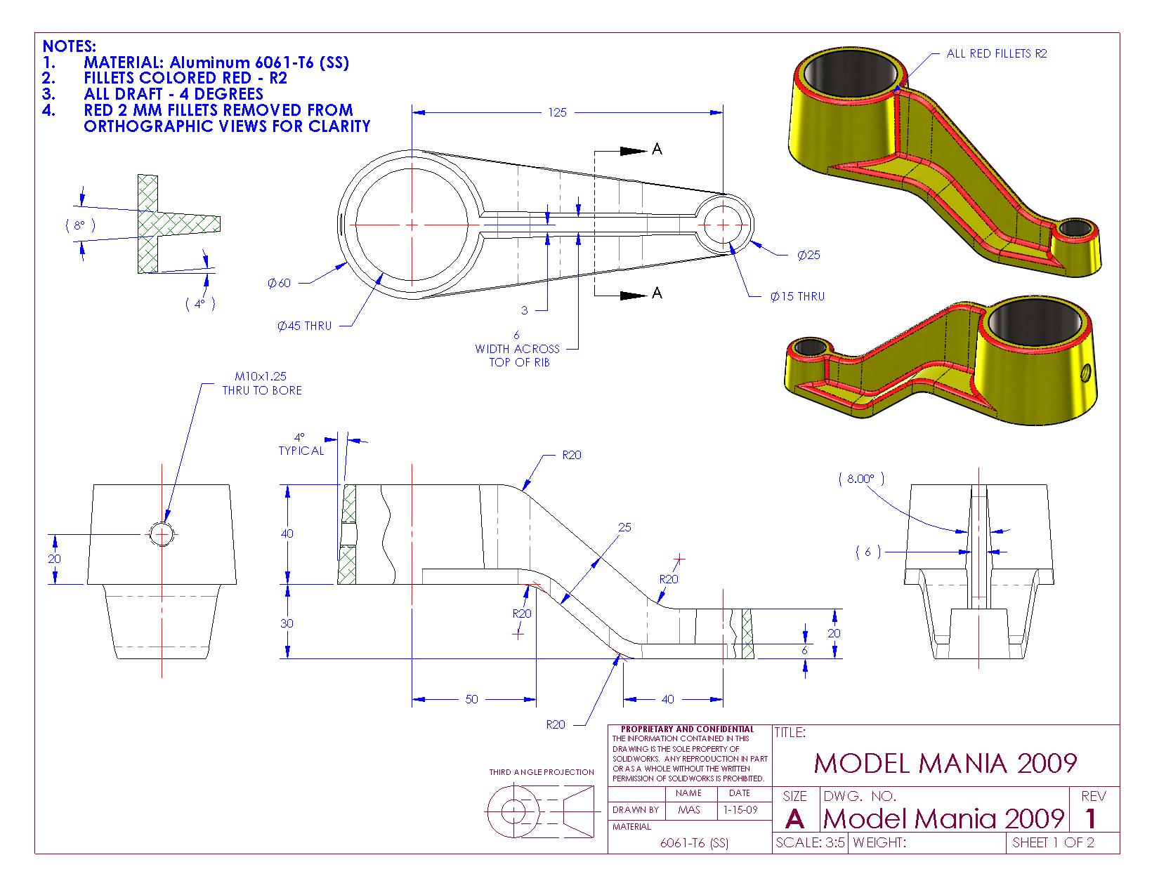

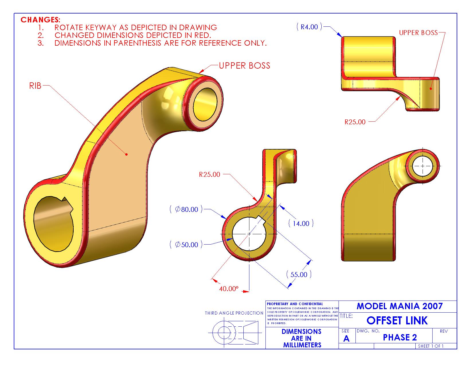

Any of the "Model Mania" stuff SolidWorks has done over the years is good, though some are more challenging than others. I've used the 2009 model as an assessment for a while now.

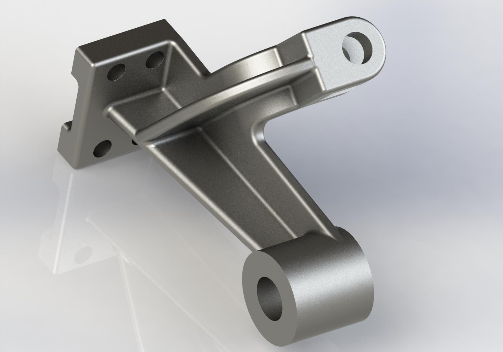

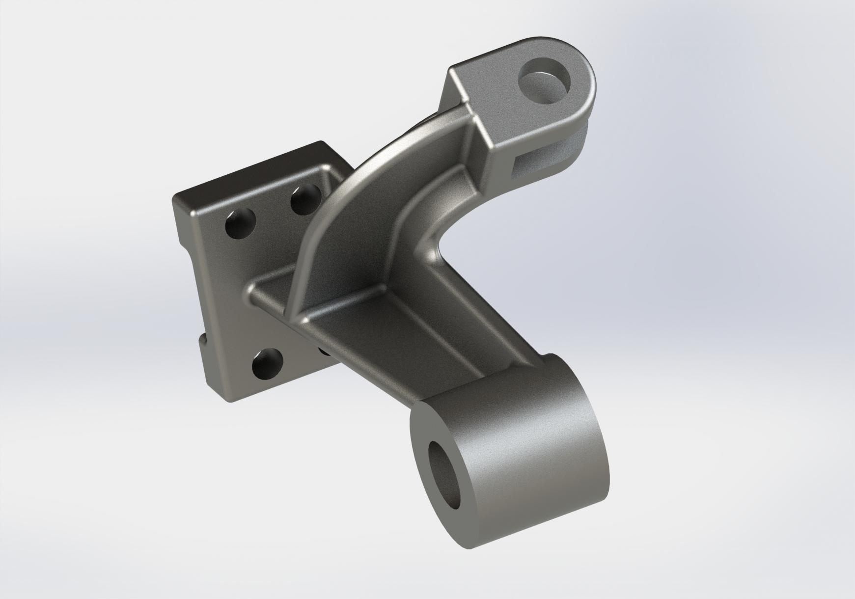

Maybe you can try this one, all dimensions was there.
