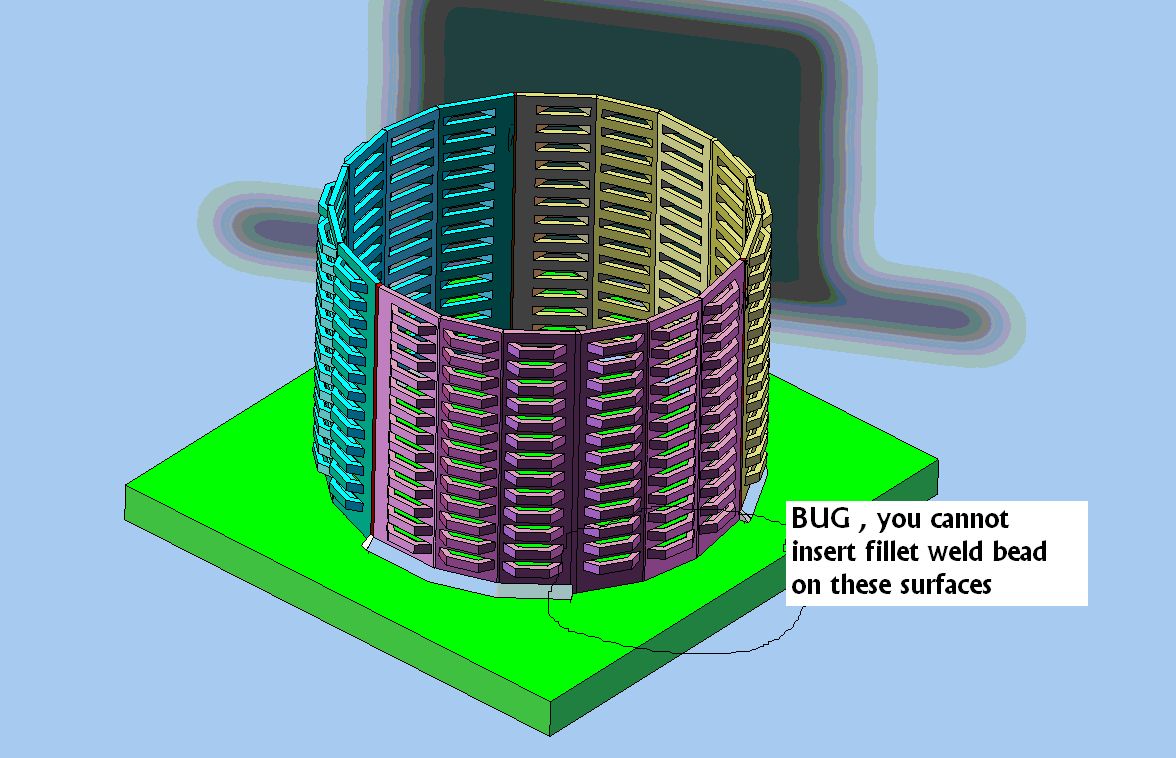

BUG in assembly feature weld beads in SolidWorks
I cannot make a weld beads on some pieces of parts in assembly stage.
You see a model on my page -Assembly100.stp
This is made in SW2007. Perforated plates is first mated and welded (Y-weld). Then is all put on green plate and mated. then I tried to weld plates on outside but unsuccessfully. Then I tried inside and it works but with little tricks. After that I suppres some features on perforated plate and I was tried to weld again on outside. Only what I can weld is piece of sheetmetal part whic is not mirrored- that is clearly seen on attached picture. whether such a problem occurs in the SW 2012.
