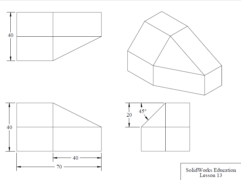

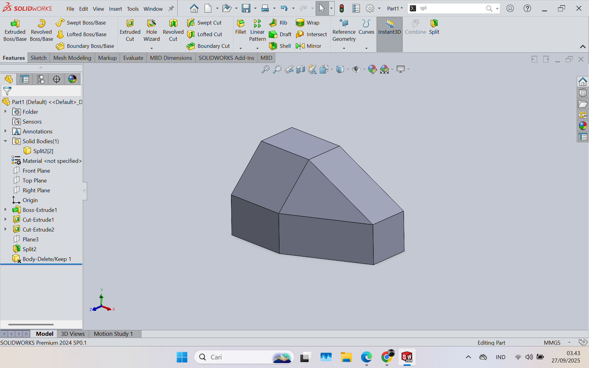

Can anyone explain me how to do this model i am uploading the picture kindly help me Keerthi S Kumar 26 Sep, 2025 05:00 PM I am finding this difficulty in modeling this component the i have started the modeling from top view explain me which view would be good to start. Screenshot 2025-09-26 222641.png 2 Answers APRYAN ENJANG PANGESTU Answered on 26 Sep, 2025 08:44 PM you start with the extrude and split the body same with me Cuplikan layar 2025-09-27 034355.png time rain Answered on 28 Sep, 2025 07:46 AM One stretch, three cuts. Imagine a piece of rectangular clay, then cut it into this shape, and then use the appropriate commands to achieve this process. So you need to have spatial imagination and be familiar with the commands. 零件1.SLDPRT
