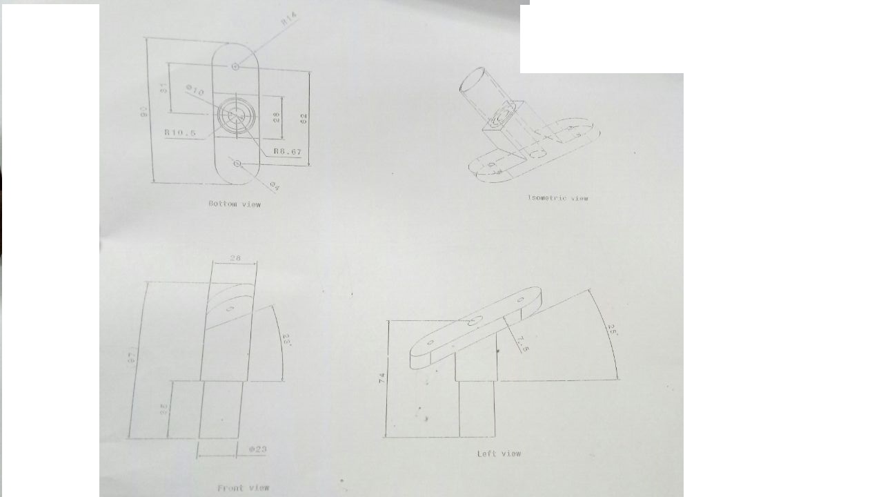

can anyone help to model the following part.. i dont know how to create the bottom area to the angle given.. Jagadeesh Kumar 2 May, 2018 06:25 PM can anyone model the attached file? model.jpg 3 Answer Nabil Elbadri Answered on 2 May, 2018 06:33 PM what software??? Robert H. Answered on 2 May, 2018 06:47 PM Eww! 1st angle projection! Anyway, if you're using Solidworks, here's a quick model to get you started. The trick is in setting up some sketches and reference geometry ahead of time to build off of. get u started.STEP get u started.SLDPRT edward private Answered on 2 May, 2018 11:18 PM create the pad for the flange on a construction plane at the set angle in one axis then create a draft in the other axis to create the compound angle
