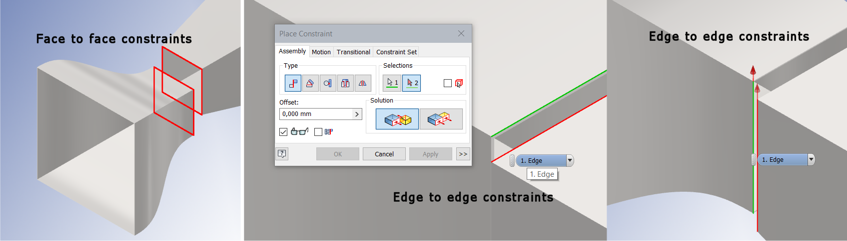

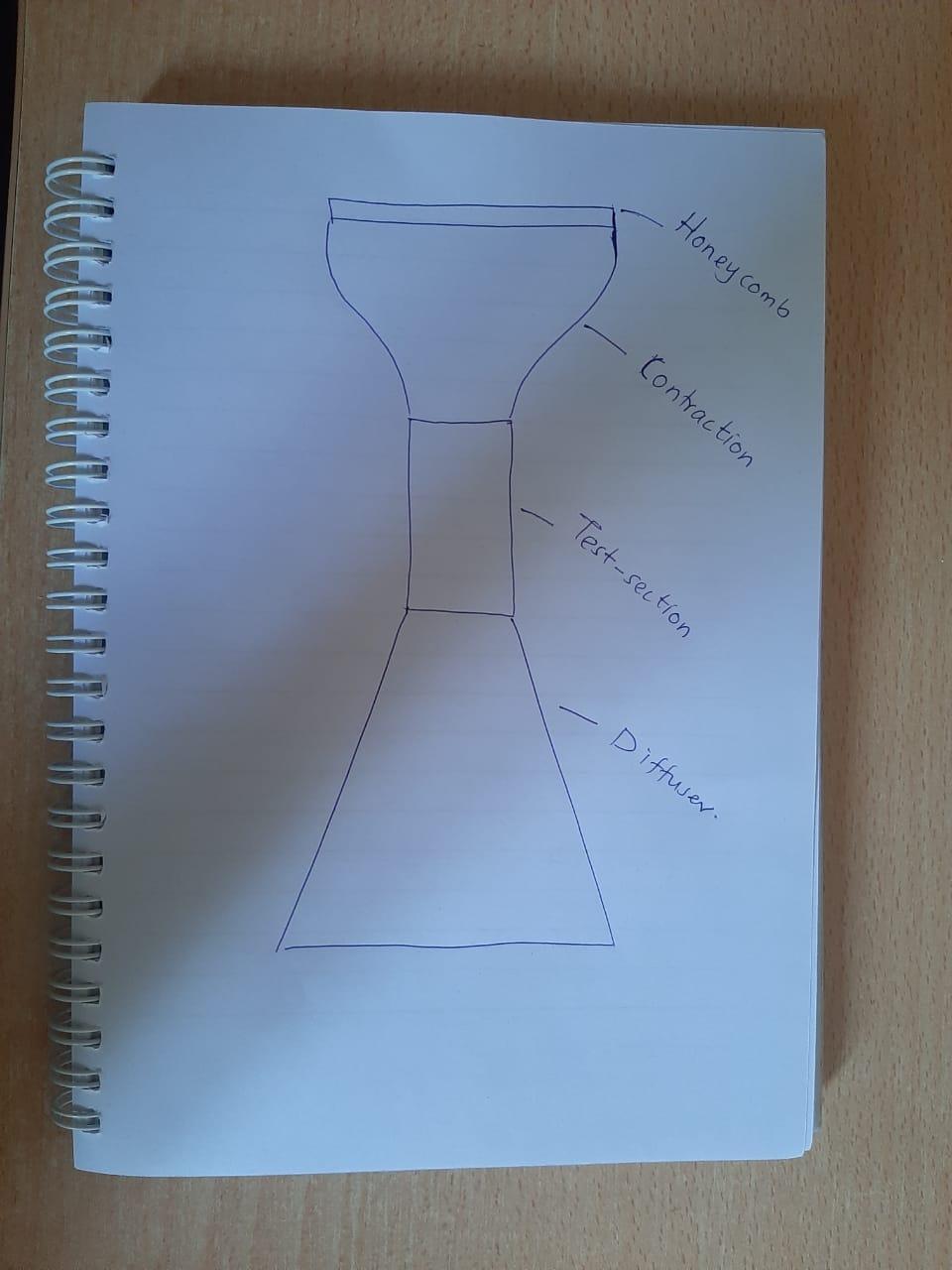

Can someone assist me in assembling design parts for my project? Goswami Vivek 13 Oct, 2020 10:06 AM I have been working on my final year project based on the wind tunnel. I have designed the parts in Autodesk Inventor software. I have difficulties in assembling it. WhatsApp Image 2020-10-13 at 3.48.59 PM.jpeg Diffuser_0.5.ipt Test-section_0.5.ipt Contraction_0.5.ipt Accepted answer CadCloud Answered on 13 Oct, 2020 12:42 PM Ok this is a step format Constraints.png With Honeycomb.step Assembly1.step 0 Other answers
