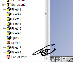

I made a mistake when building that I can't go back to fix without deleting my current progress, so I want to download it. The steps are in this link:

Just move the "end of part"to where you made your mistake make the changes and then move"end of part" down to the bottom.
