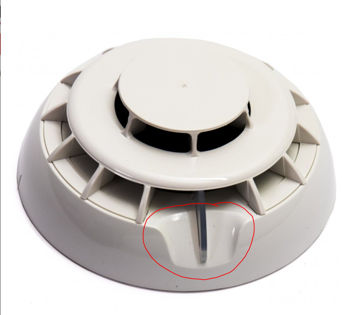

I am trying to model a smoke detector from an image. (I have it IRL also so all dimensions are correct) But the "cut out" feature I just can't figure out how to do. Does anyone have any ideas?
I made it in inventor 2016 so I will attach a part file and a step file. And the image.

It is revolve cut. Make axis away from model and draw sketches to cut out. Later fillet edges
well i am just starting with soildworks >> if u ask me to do tht shape (cut) its like upsite downs bell (half) u can draw that bell sahep and revolve it .. then cut it
