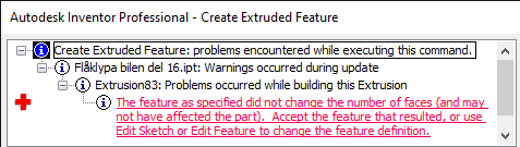

I have created a car body inside of a ipt file. I am trying to make a hole through a lofted part however it does not work. Creating a normal extrustion works but not the cut. When i try to cut it the sketch disappears and i get a notification saying that it did not change the amount of faces.
If anyone have any solutions or reasons behind the problem please share.
All help appreciated!

The real problem seems to be features "DeleteFace19" and "DeleteFace20".
They turn the front cowling area into a solid with no interior volume. As if it was a surface model only. Then when you attempt to extrude Sketch210 as a cut, since the front cowling has no solid volume, you get the error that it had no effect on the part.
Suppressing "DeleteFace19" and "DeleteFace20" allows Sketch210 to be cut through the part. However this results in many surfacing operations being orphaned. So the DeleteFace operations need to be corrected.
