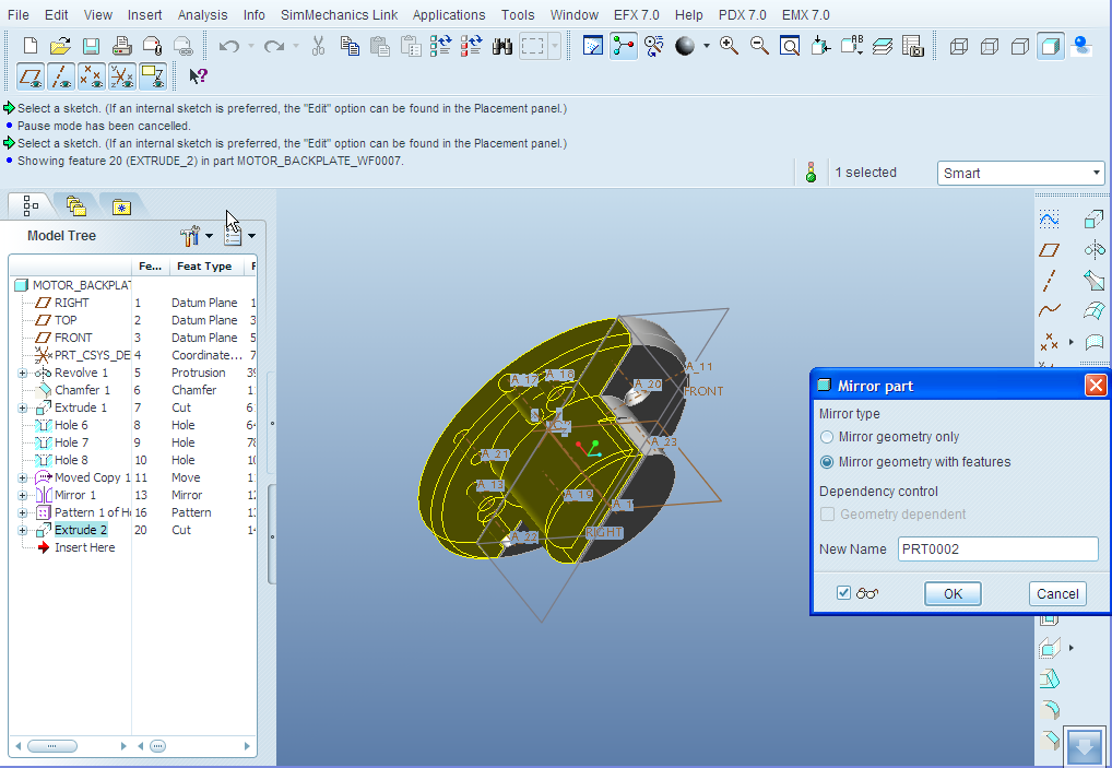

see if mirror part option works for you use extrude to remove material from original part then under filemenu>mirror part.
