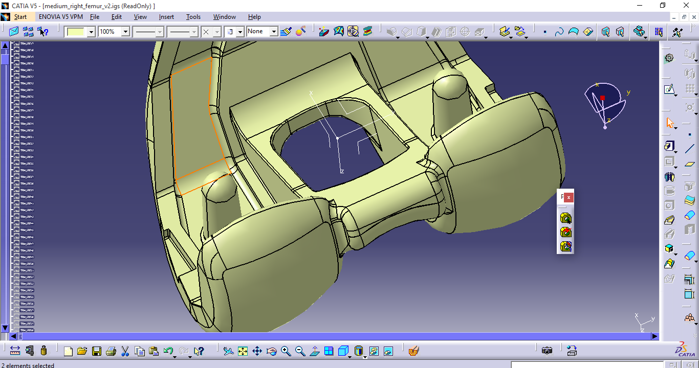

my client was send some iges file to create solid. i try to fix that problem on catia v5. but i cant create solid. because major problem is surface gap is there. but i cant find out surface gaps.
And also i try to fix this problem on transmagic software but it cant rectified. what can i do now friends... can you any one help me guys please....

the surfaces(two) highlighted in saffron you need to modify them as they are overlapping with other surfaces. because only this two surfaces having the problem to merge or heal. once you do that you get solid body first to healing then joining then part design then close surface command
