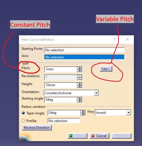

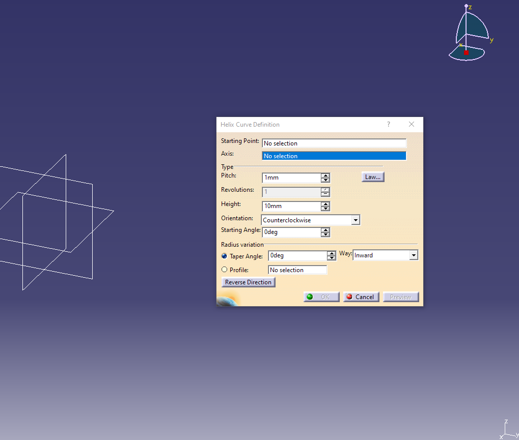

command , options missing in catia Vinoth Irudaya Nathan 21 Jul, 2023 04:29 AM I'm using Catia v5 I'm a beginner currently. in helix command of generative shape and wireframes.. where I find this tools missing.. variable pitch ? constant pitch....??!! whereas while using multisession solids. I find. AREA LAWS MISSING helix command.PNG 2 Answers Jack K Answered on 21 Jul, 2023 06:17 PM constant pitch is just PITCH. Use a Law to define a variable pitch helix.jpg Jack K Answered on 21 Jul, 2023 06:20 PM The Multi-Section SOLID tool does not have a Law option. Instead, make a Sweep Surface (does work with Laws), and then make a solid from the surface with ThickSurface or CloseSurface tools.
