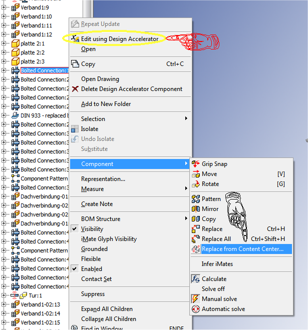

after formatting C and re install windows & Inventor 2016 my old projects don't open the placed parts from content center (flanges, bolts,....)?

but from the best of my understanding, if you were using 2013 and lower versions before now, you will find it difficult to locate the flanges and bolts and all, because they are later found during assembly
The only way I know is to load the assembly and skip the items that are missing.Inventor should load your missing bolts etc but are greyed out.
Right click on your missing files and use edit using content centre when this comes up hit "OK" and this should reinsert your missing components.If they are single parts then do a search in the content centre and click replace all.
