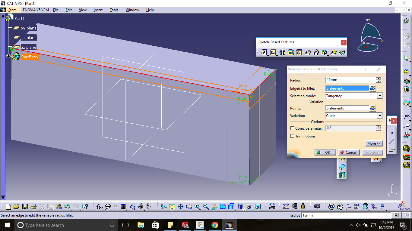

how to give different edge fillet at once on catia v5??
thanks in advance
IS THIS WHAT YOU ARE ASKING??? If YES it is simple plot points on edges where you want to vary the size and use Variable fillet. If NO let me know.. :)

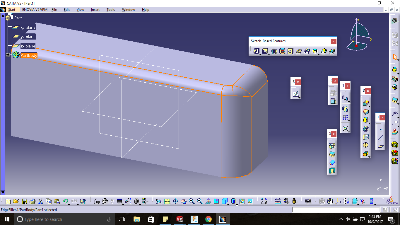

I guess this is what you are asking for.. you can still use that same option "variable edge fillet" and select different edges and can change its dimensions.
you can use VBA to give different edge.
you can do by the variable radius fillet,
there you have to click on points then click on edge where you want various radius
