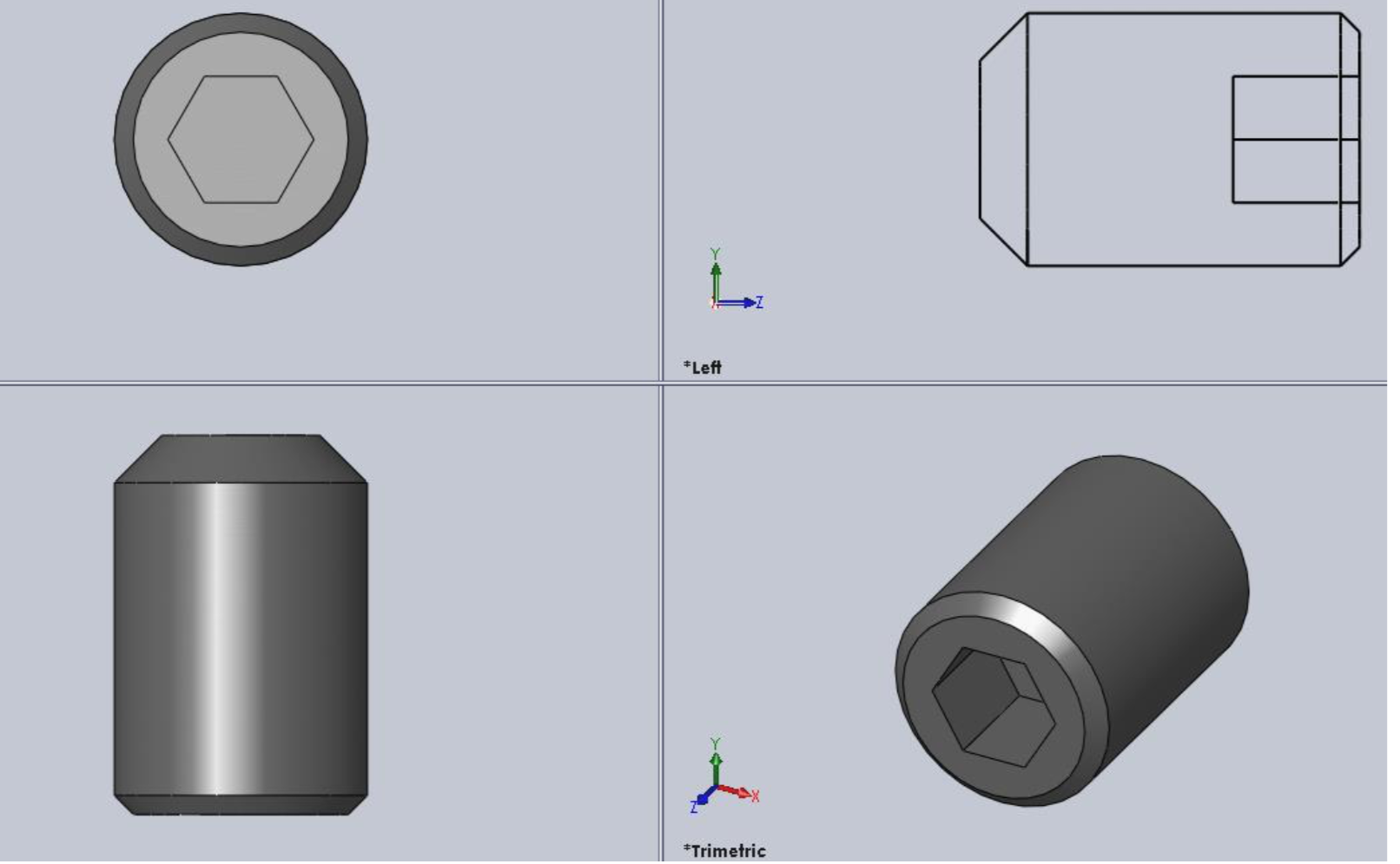

Hex Socket
This is my first course and we have to do hex socket in solidworks, if any can help me and tell me the steps to do so
2 Answers
Begin with a cylindrical slug and remove material. There’s two chamber operations and a cut extrude on the other side.
It's a great idea about everything in the beginning, to design the modeling according to the manufacturing steps
