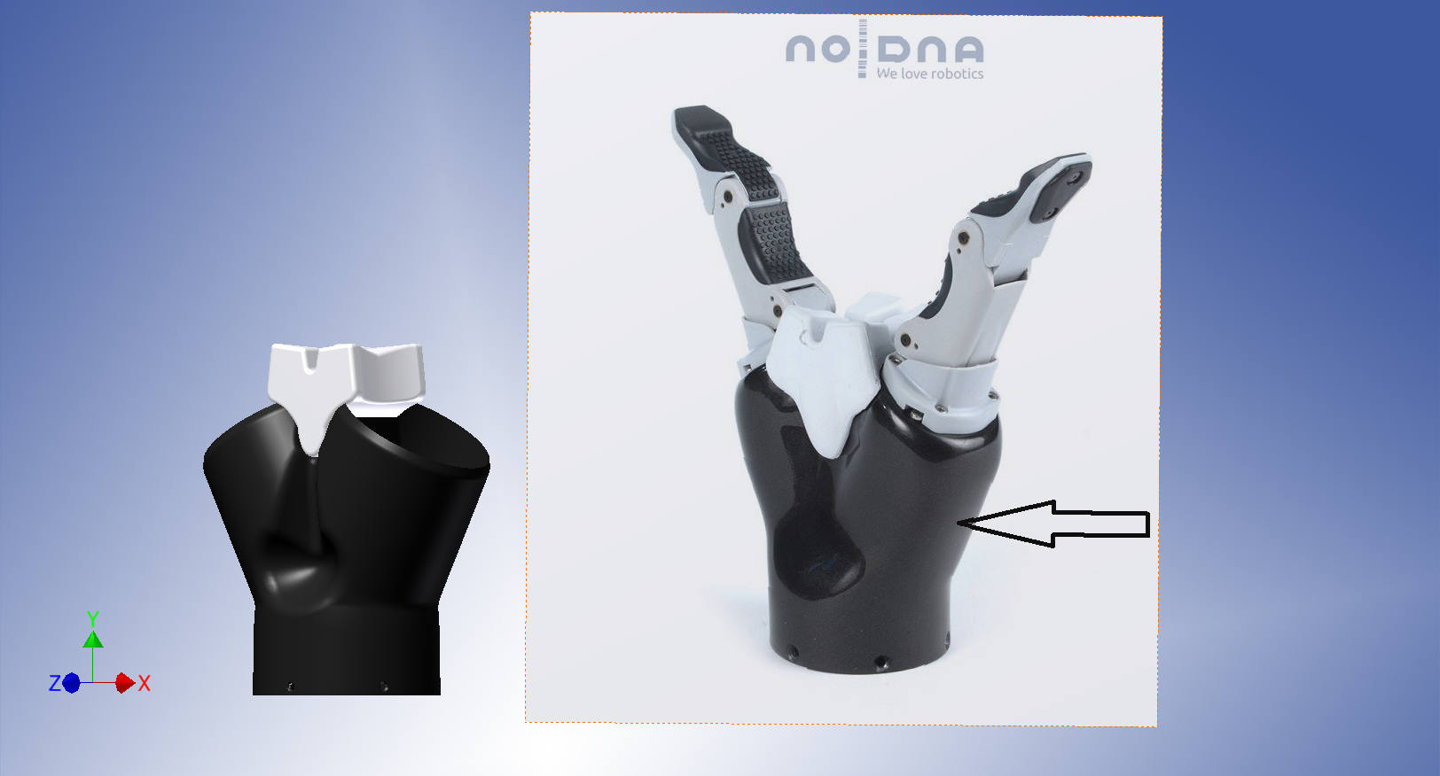

hi every one how can i model this surfacing part
it's for my final project, i need your help

Hi Zaidi
I can help if you can send me a little bit more specification
cara@zetarmold.com
1, Loft Circles in "Y" shape
2, Loft Shapes and remove from part.
3. Use various fillets to soften your edges.
4 Hollow out your part to the thickness required.
5. place screw holes.
6. save as STL (3D Model)
** A few diamensions would help.
** Check to see if the part/design is copyrighted !!!
