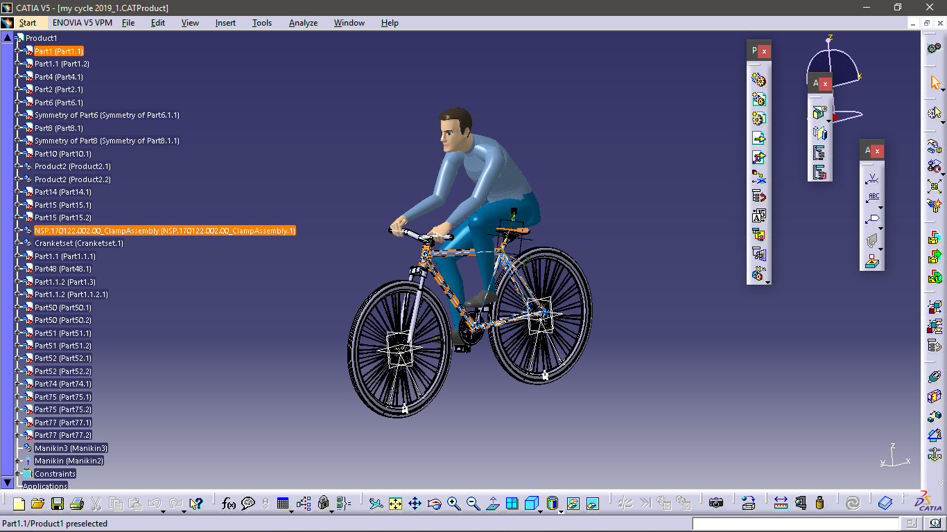

how do i assemble manikin with my cycle so that the two model turns into one model
if i use fix command constraint and so on it wont work...please help

I had the same situation a few years back. I documented my results to share with others. Attached are two documents which should help you with this challenge. the 1st is a simple solution only showing the manikin feet moving with pedals (no ankle flex). The optimized solution shows a more realistic foot movement that includes ankle flex. Have a look at the documentation and please feel free to contact me with any questions.
