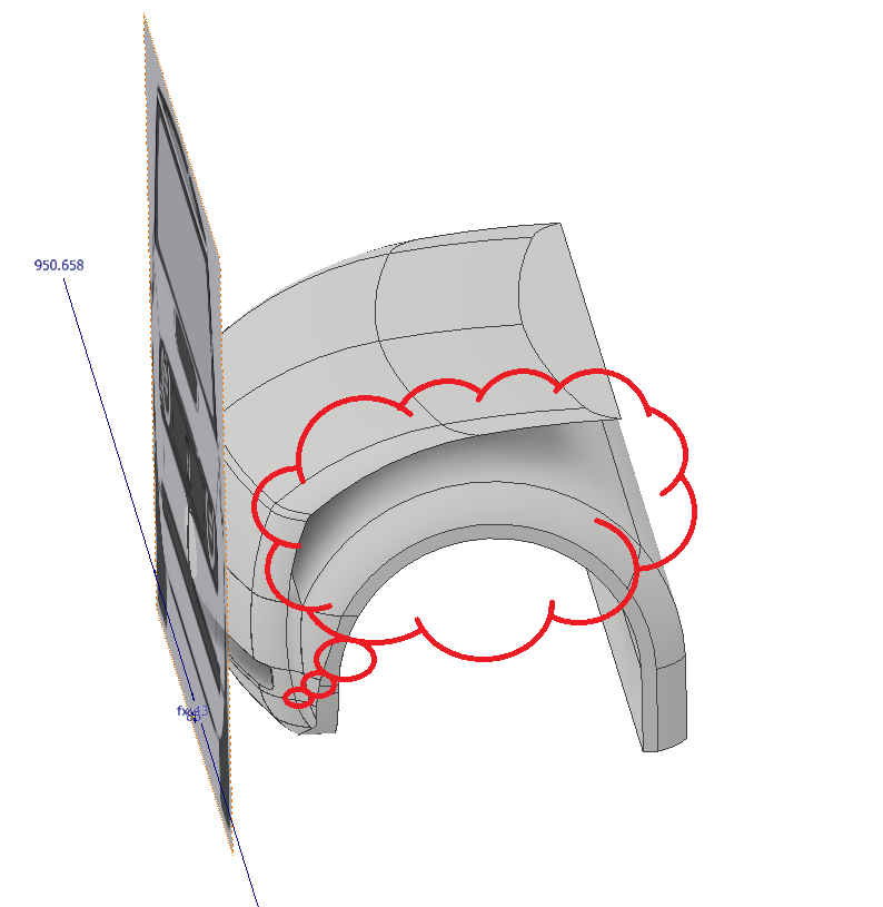

How do I patch this up? Surface? Freeform?
Hi everyone,
I would like to know the steps into patching this area up. I know that I have to divide the fender/wheel-well in to several surface sections to match the surfaces on the side panel and hood but don't know how this is done. A guided example would be appreciated. Thanks for your time. (Files were done in 2018).
~Ruben
2 Answer
You need supporting curves from the wheel arch (g0) to the upper surface (maybe g3). An intersection curve, created by a datum plane at each end of the curve, can be used as a means of construction. You'll need some type of bridging curve that you can control the continuity of; g0 from the wheel arch section curve, g3 at the upper surface's section curve. That leaves you with a 4-sided patch to construct a mesh surface through.
I don't know the tool-sets available within Inventor, but this is a 'general' workflow.
