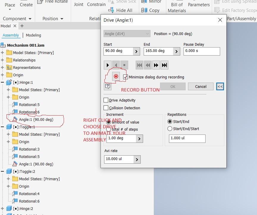

Hi there, If I understand you correctly, you are talking about recording an animation of moving assembly in Autodesk Inventor. You can simply press the button in the drive GUI
