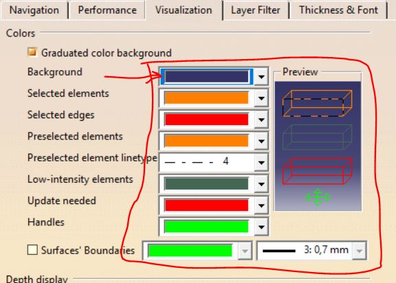

For background. go-->tools-->options

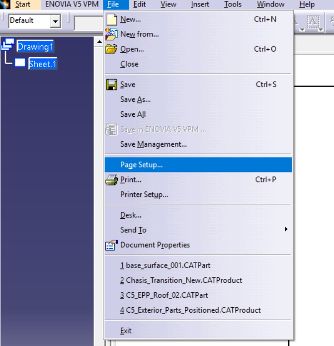

For drawing standarts. go-->file.
