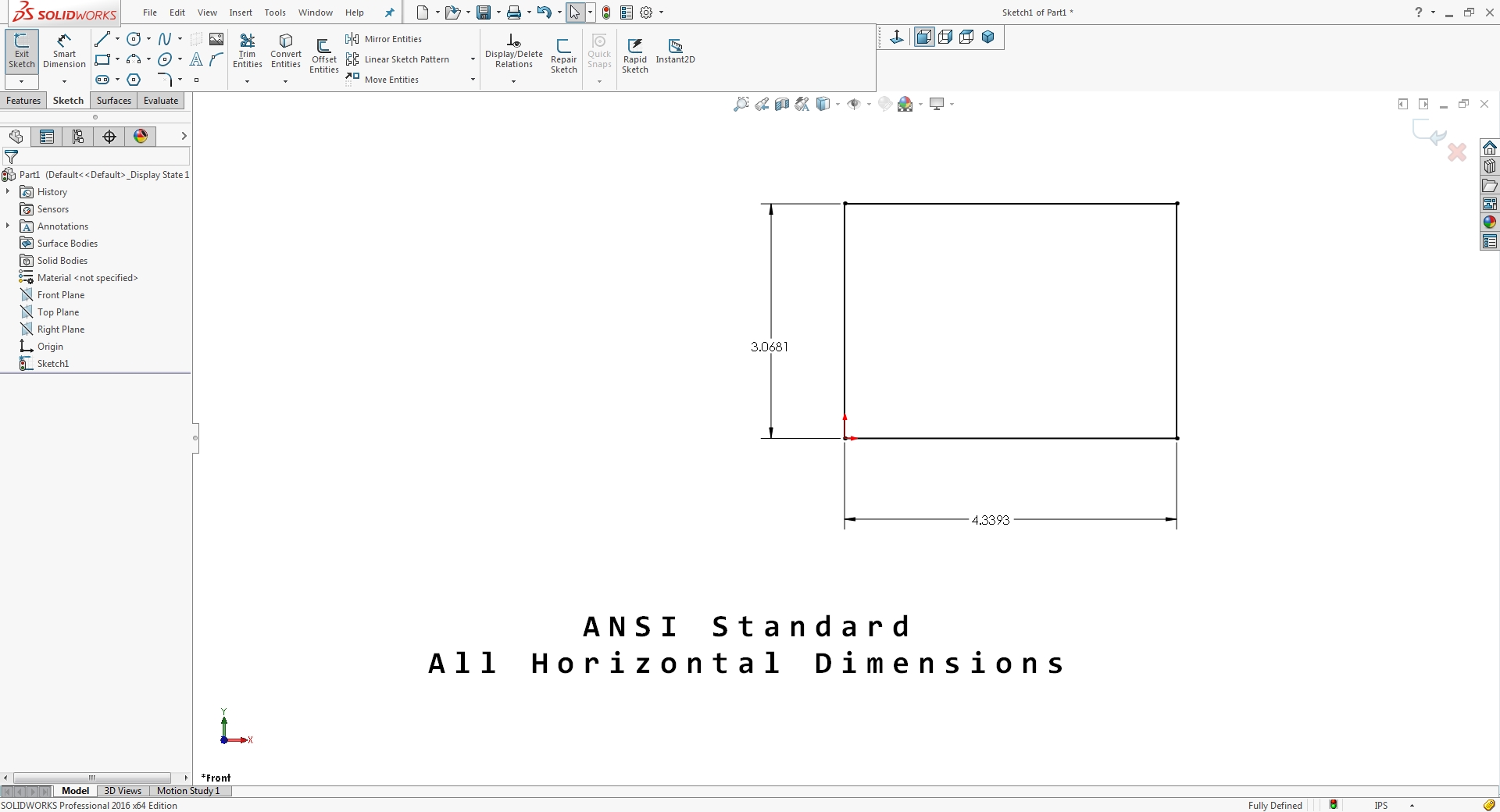

Switch the drafting standard to ANSI.
Two screenshots showing the difference are attached. ANSI places all dimensions horizontal. ISO allows both horizontal and vertical dimensions.
