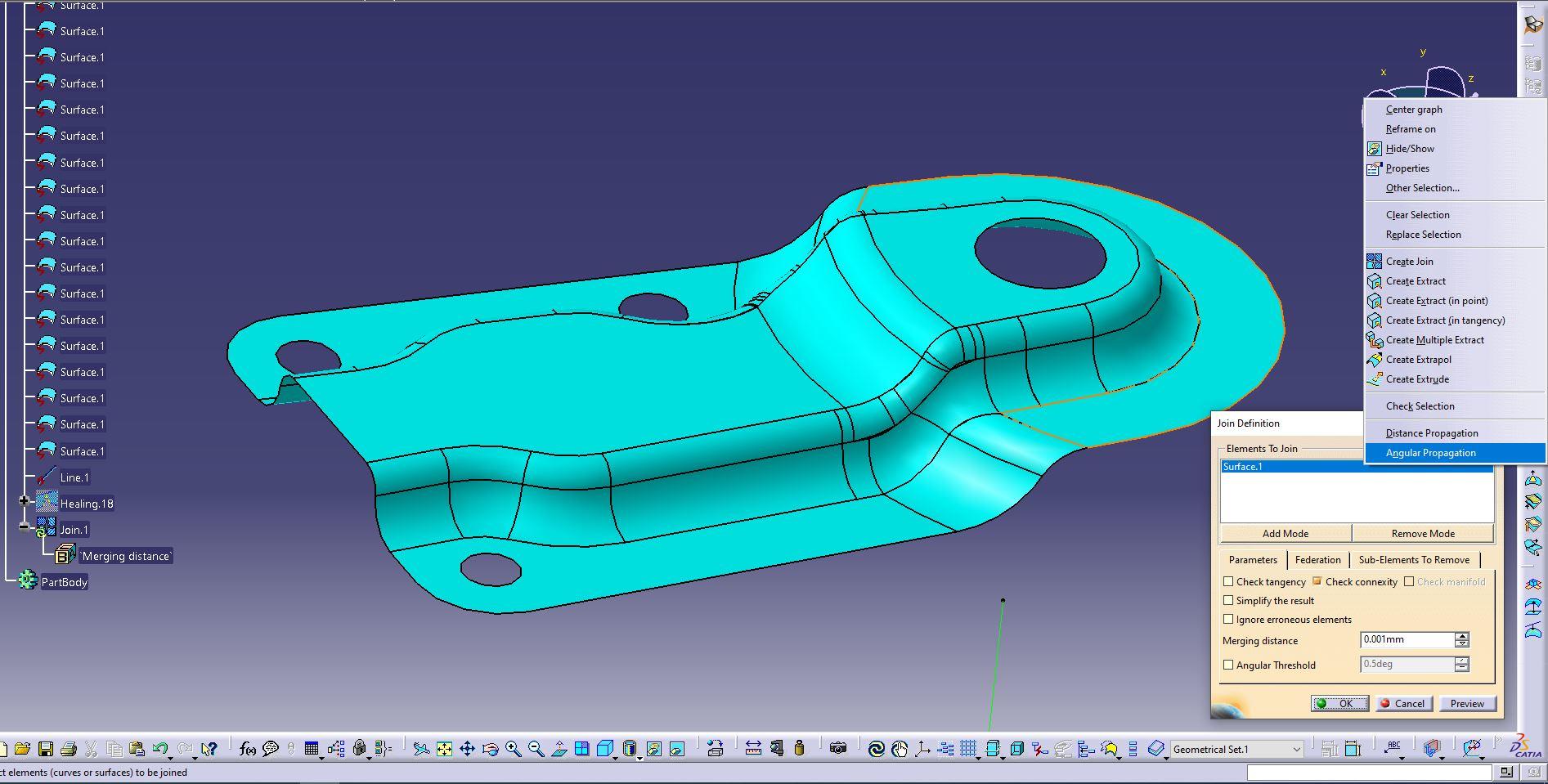

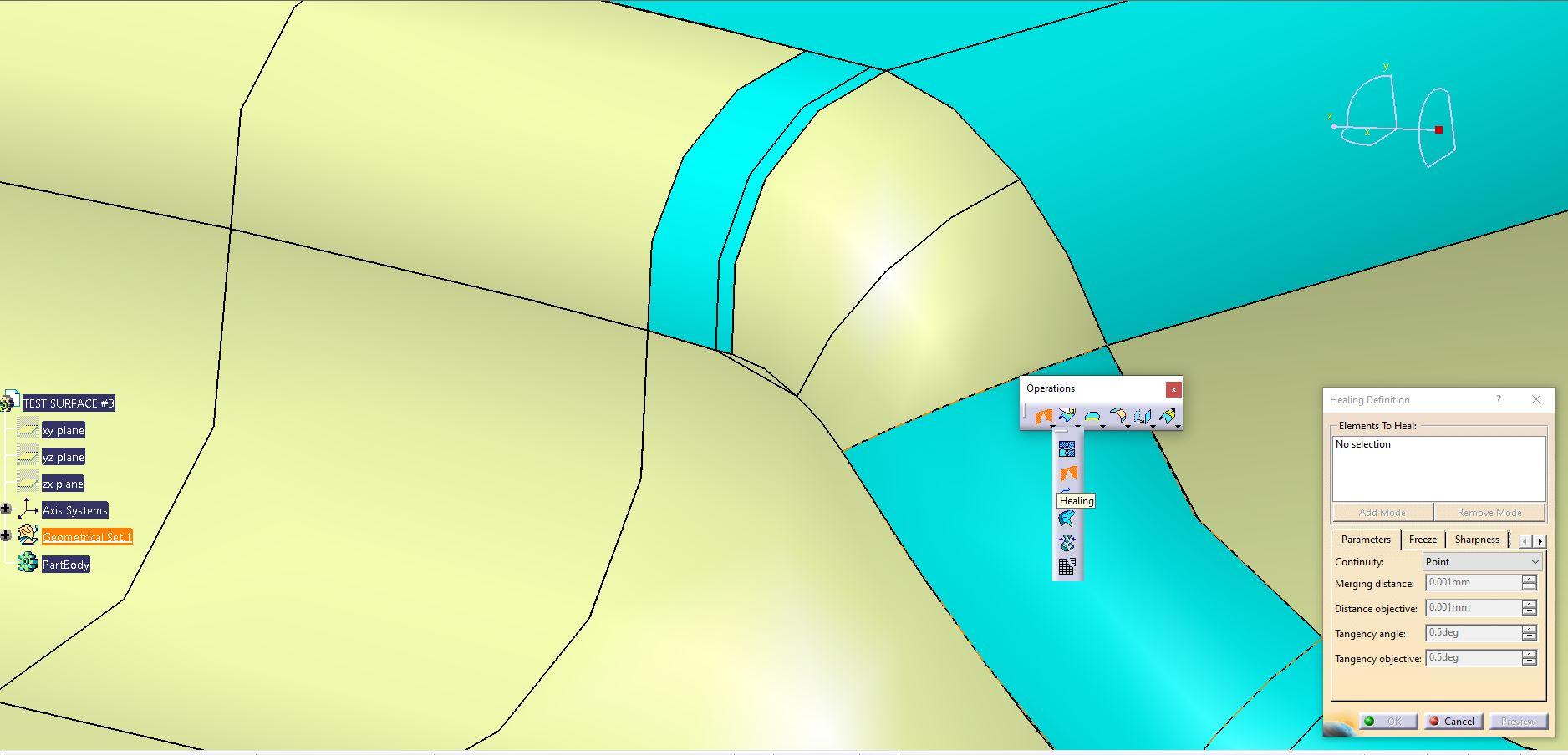

How to close the patches in this part after offset? OFFSET DISTANCE 2.5mm upside
Gokul Krishnan
Gokul Krishnan
13 Aug, 2021 02:00 PM
CATIA OFFSET PATCHWORK
3.TEST SURFACE - IGS - 3.5MM upside.igs
C Bogdan
C Bogdan
Answered on 13 Aug, 2021 03:58 PM
Heal command or Join- select surface - right click - angular propagation
