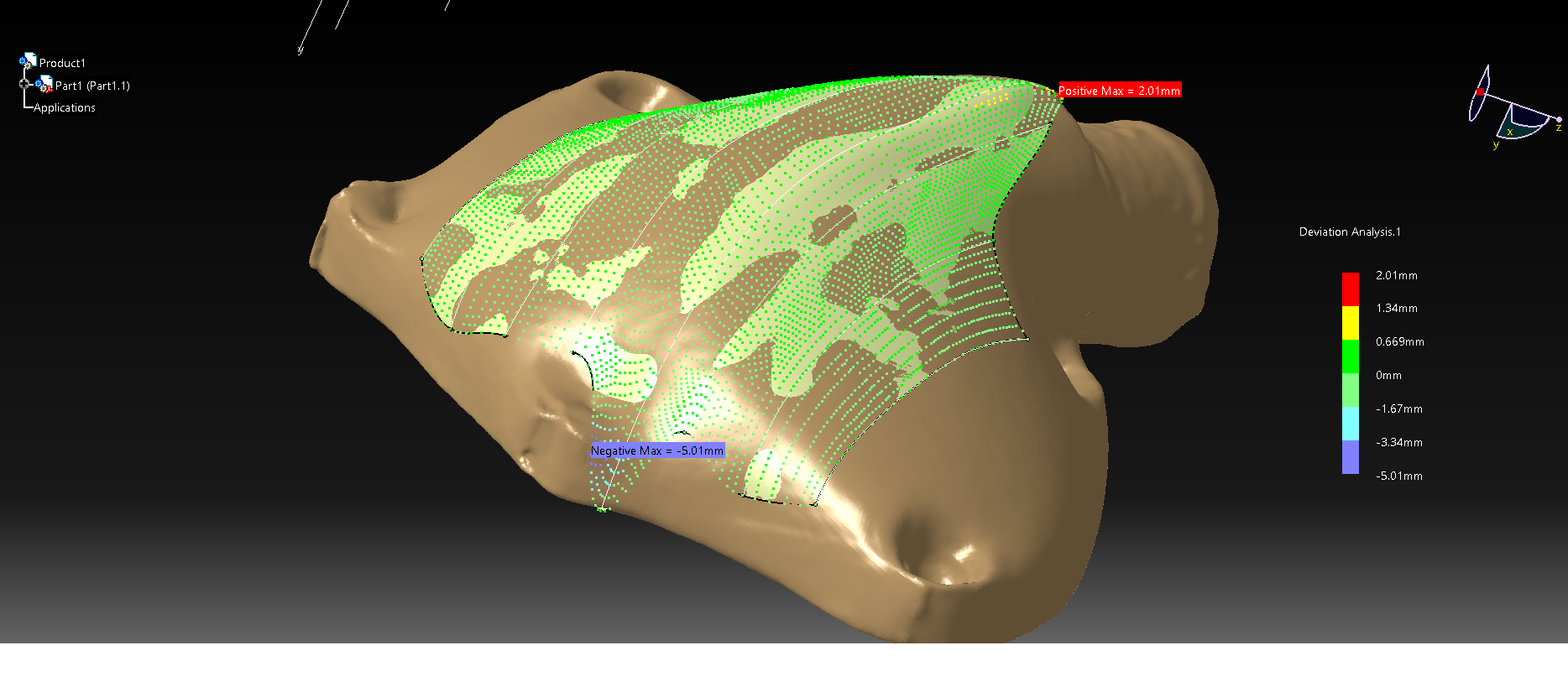

In this picture I try to create simple reverse in catia (brown - STL, Yellow - Surface) with deviation analysis.
