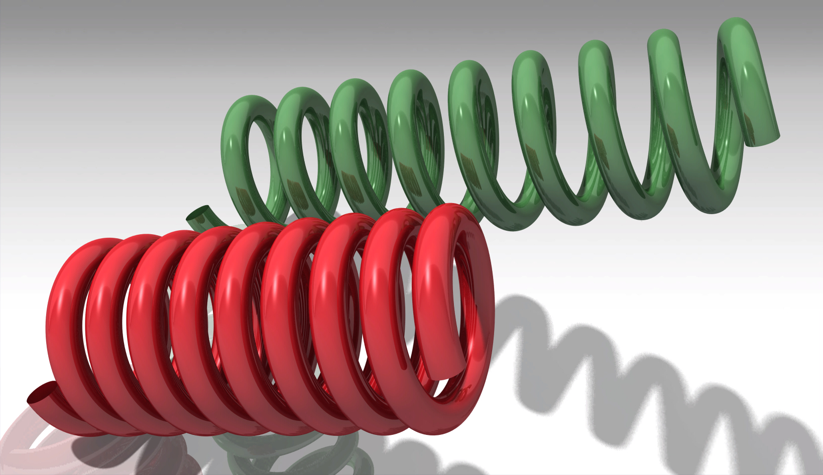

The easiest way is:
- divide the spring in two parts (half length)
- twist these halfs into each other to change the length

Twisting the two springs in the Kinematic Workbench is only a fake. But AFAIK the simplest method:
- create a cylindrical joint between the axes of the two springs
- crate a point-curve joint between the springs
The upper spring is turning to change the hight.
