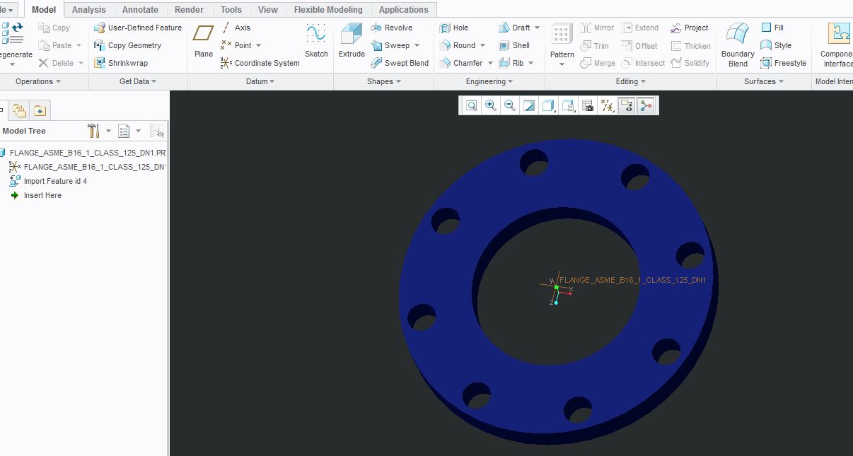

How to extend or move a feature of IGS model in creo Amritpal Singh 1 Aug, 2016 12:40 PM Bottom bracket, fork 2 Answers ABHISHEK SINGH YADAV Answered on 14 Oct, 2016 09:12 AM At the time of saving the model save it as SAVE AS in the file format the default option will be prt format. Click the drop down menu and select igs or iges format and save it at your desired Location. dread Answered on 10 Jul, 2017 08:42 AM steps are simple just import the file to be edited click on flexible tab and ur done..now u see the move command and many others move the feature.JPG go to flex tab.JPG import file.JPG
