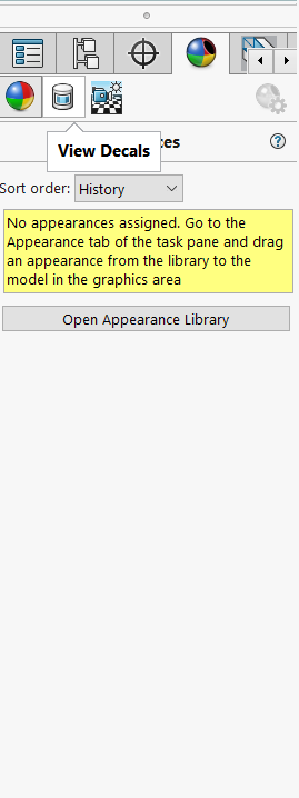

how to import the decal image in solid works plz tell me? Ranjith 5 Nov, 2021 03:28 PM when I try to work on pattern design i have faced this problem in solid works 2 Answer Yahya T Khedr Answered on 5 Nov, 2021 04:45 PM The easiest way is to drag the image and drop it on the face/feature/body/part you want to apply it on. Aakash Devani Answered on 10 Nov, 2021 04:44 PM The other method is by clicking on DimXpert Manager and click on symbol of Decals as shown in images. Screenshot (132).png
