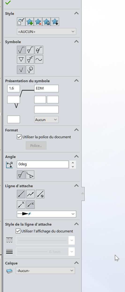

How to include the process on drawing sheet? Ko RG 19 Apr, 2021 09:29 PM Where can I include a note on the drawing that suggests a machining process that could be used to achieve the desired roughness. 2 Answers Patrick Answered on 20 Apr, 2021 03:55 AM You may use surface finish anotation, including the machining process capture.png Jack K Answered on 20 Apr, 2021 12:11 PM Describe the process in the Notes. If the process is very detailed and lengthy, make a separate document (with Word) and assign a PN to it. Then add a note on the drawing that refers to the Machining Process document.
