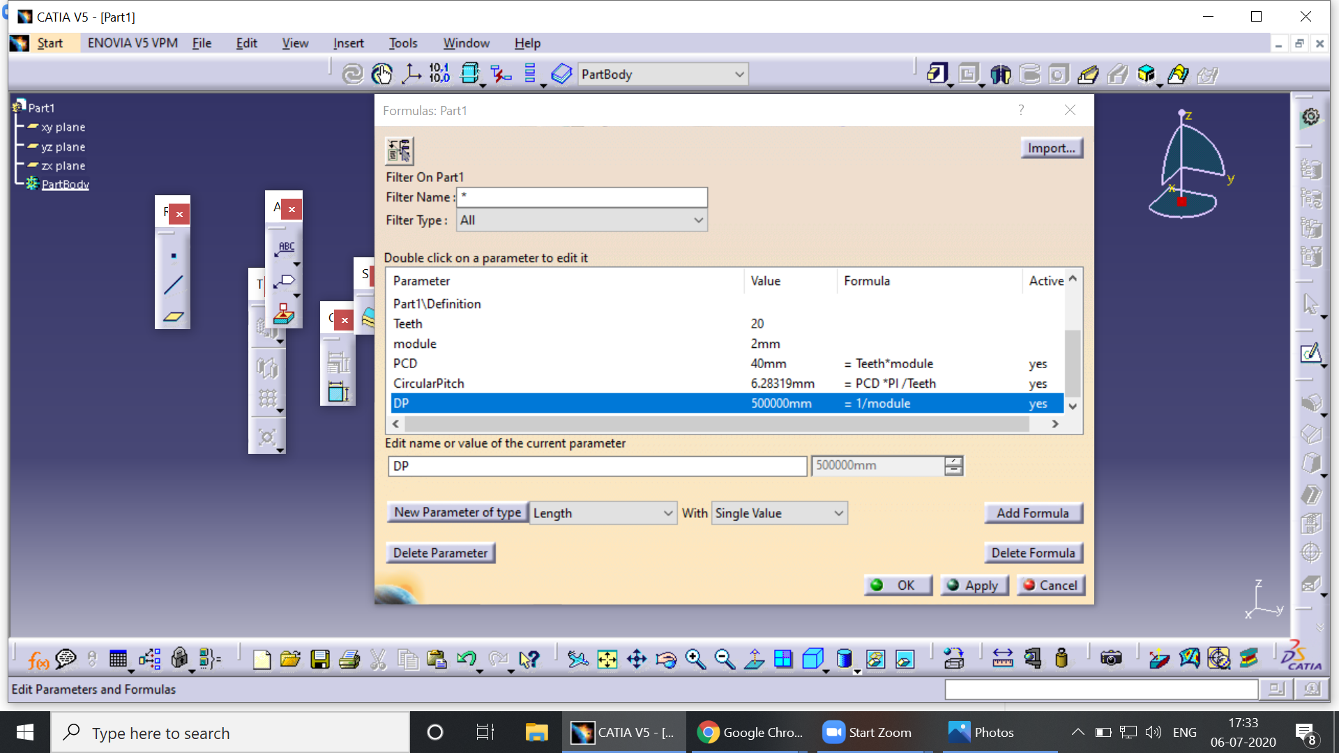

DiametricalPitch=1/module=0.5

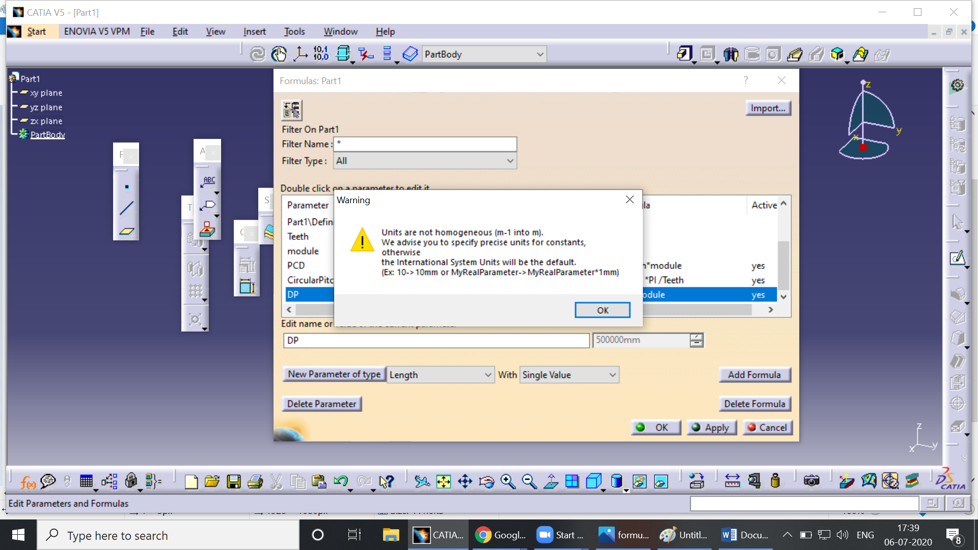

but as i enter the value i get 500000mm instead of 0.5...
my units are set in mm but still i think the default unit for 1, its taking metre.. plz help me out
i have attached the image of input as well as error

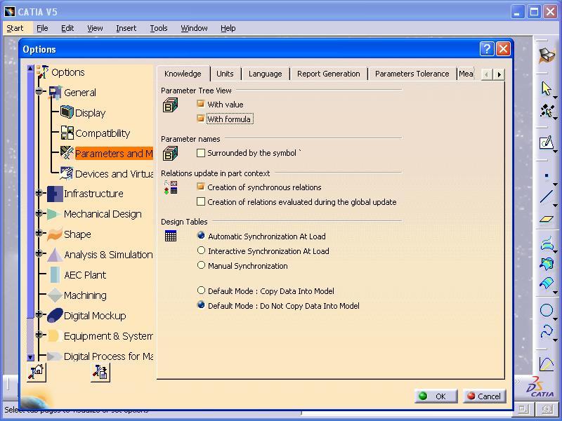

change your Tools Options to show branches in the spec tree of all your parameters and formulas

add units to the formula like this:
DiametricalPitch=1mm/module
