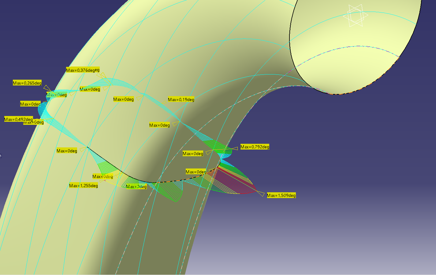

How to use Angular corrcetion & Deviation in Multi Section Solid in CATIA ?
Hellow friends. I have been trying to find the correct use of angular correction & Deviation in multi section solid command of CATIA. But still i am not able to findout. If any one Knows the answer kindly post your answer.
3 Answers
Angular Correction:This parameter is related to the angular tolerance of the moving frame
Deviation:This parameter defines the gap authorized
By adjusting the parameters above, you can reduce the tangency constraints along the edges and reduce the number of patches for the Nurbs surfaces underlying .
NOTE:Those parameters should vary from companies, and designers may not allow to changes those parameters in companies..
