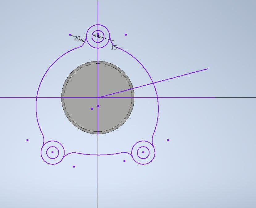

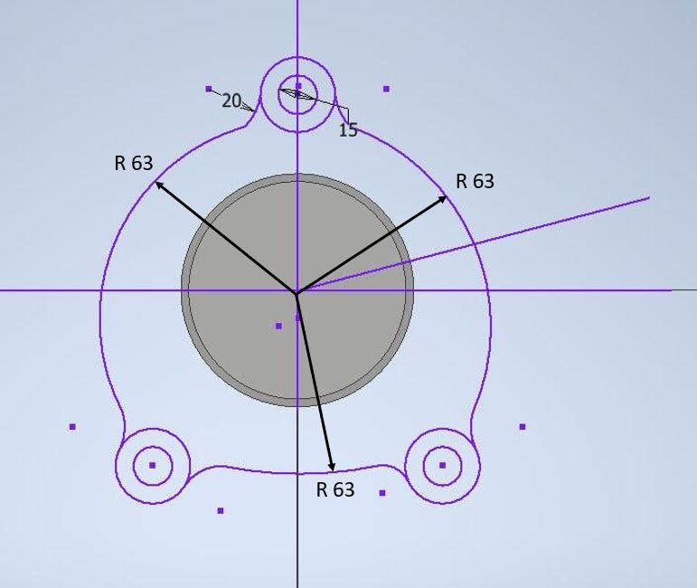

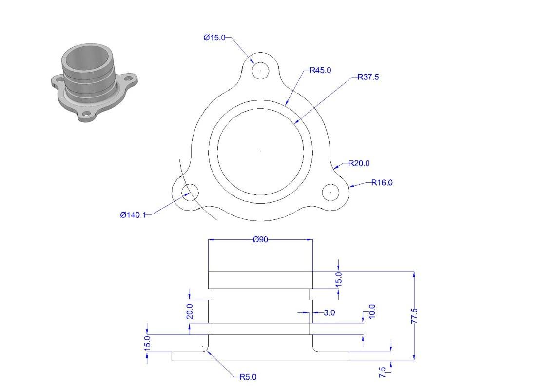

I been trying to draw this lower part but I can seem to get the curves John Lewis 19 Mar, 2023 09:03 AM I was able to revolve the upper part, but failed to draw the part with curves. How do I best draw it u help will be appreciated. IMG_20230319_110214_061.jpg IMG_20230319_110213_859.jpg 2 Answers Jack K Answered on 19 Mar, 2023 05:24 PM John, You have a good start. You just need to set the size of the 3 arcs and make them concentric to the center hole. I guessed at the R 63, like Carlos said. Then do a little trimming and you got it! lewis.jpg Carlos J. Veloso Answered on 19 Mar, 2023 06:06 PM here is a little more help. Do some trimming and you should be all set. Outer Circle Tangent to 15mm Holes.png
