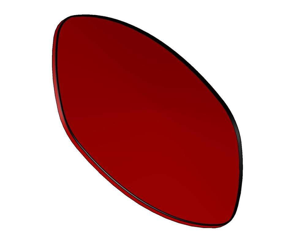

I need help to make this part
I get this image in my group
I tried to create this but failed i need some approach for this , in solid work softwar

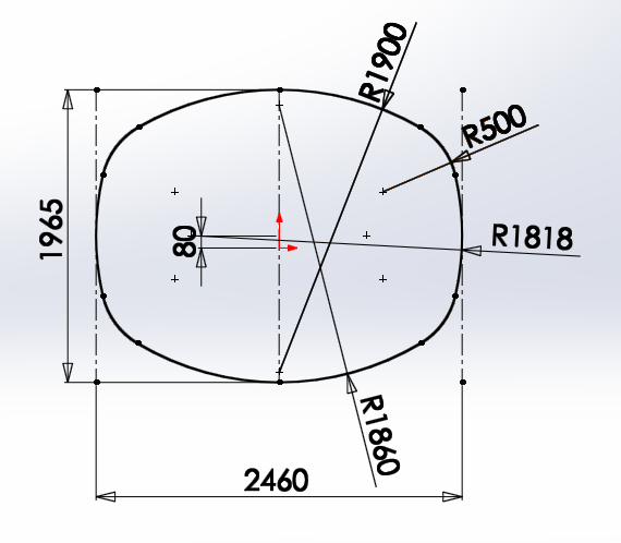

This is a screenshot of what I did:
BTW, I made an assumption that the width is between the mid-points of the 3rd arc (whose radius is 1818).

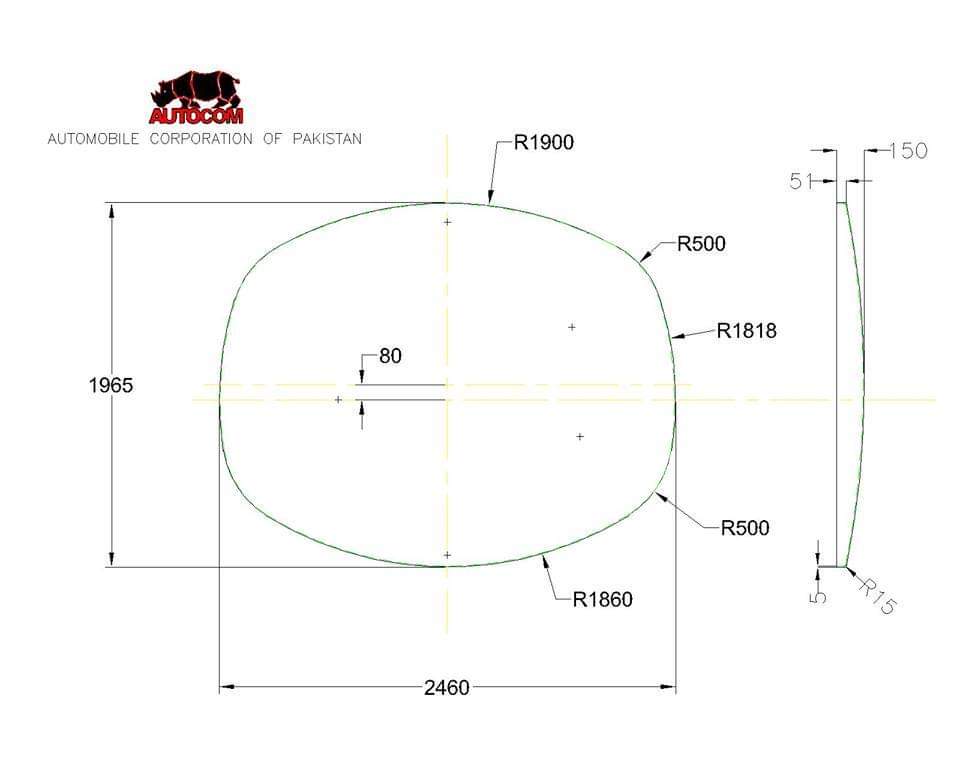

Trying to figure out the original drawing. We have to assume the curve in the side view is circular since no Radius dimension is given. But is that surface cylindrical or spherical? The two centerlines in the front view might indicate spherical

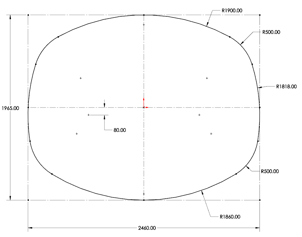

Attached is an image of how I read the drawing.
I also attached an image of the base sketch. It is very similar to what Yahya posted, but I made a "box" to help contain mine, but it is not needed.
