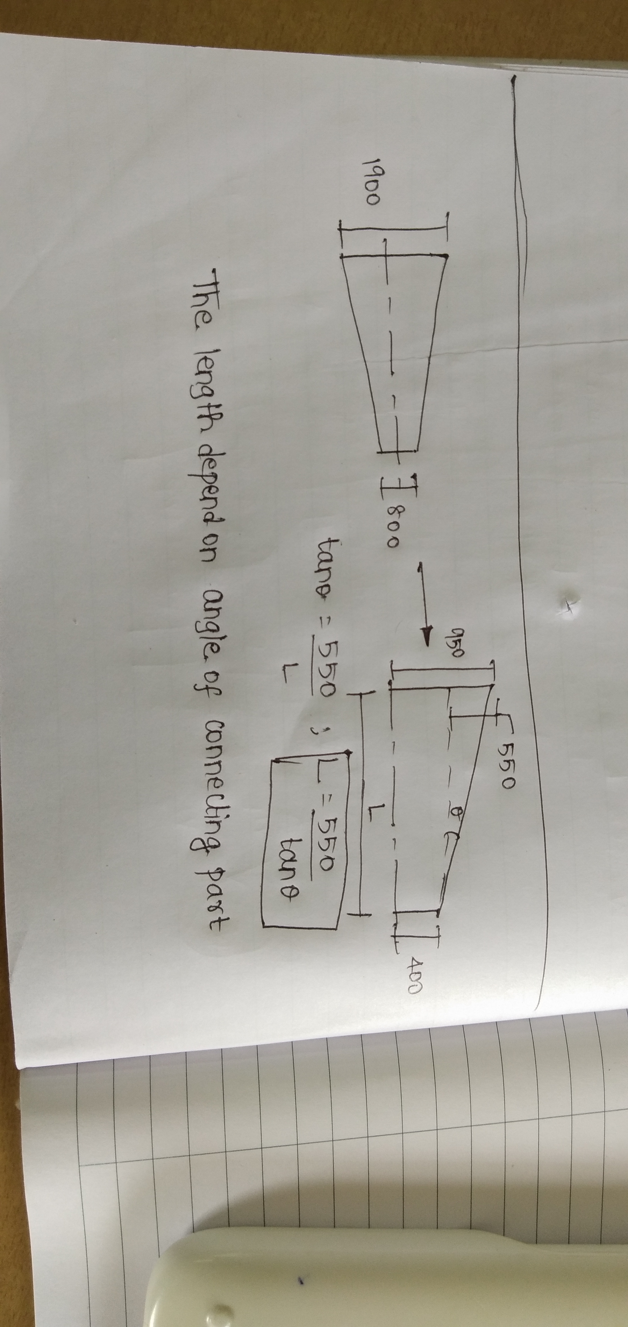

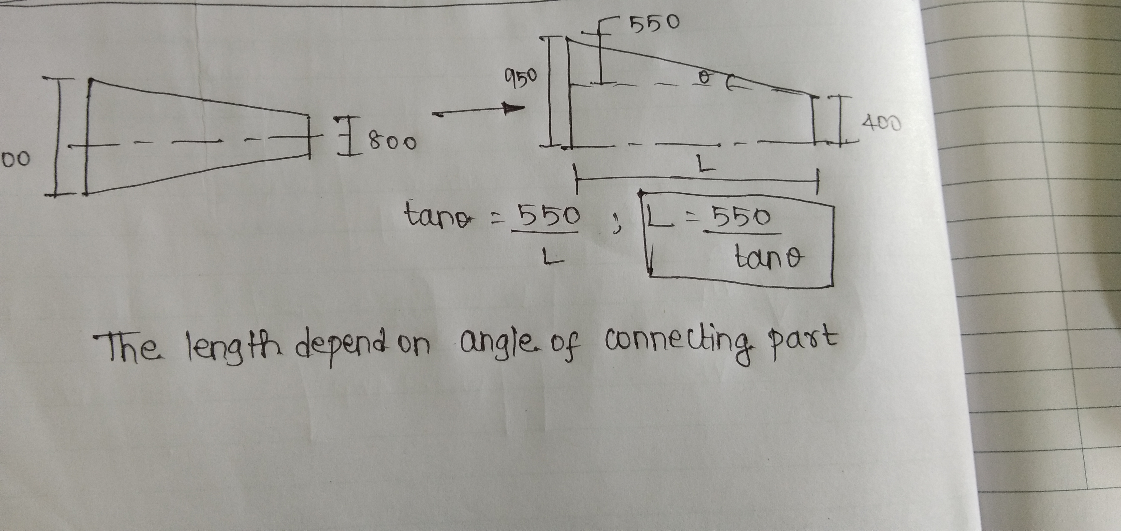

This is a general and it's a try. You have insufficient condition to explain the length of taper part.
The amount of taper depends on how/what flows through the pipes. I recall that a total taper of 15° or less will prevent turbulence in air flowing through a duct.
