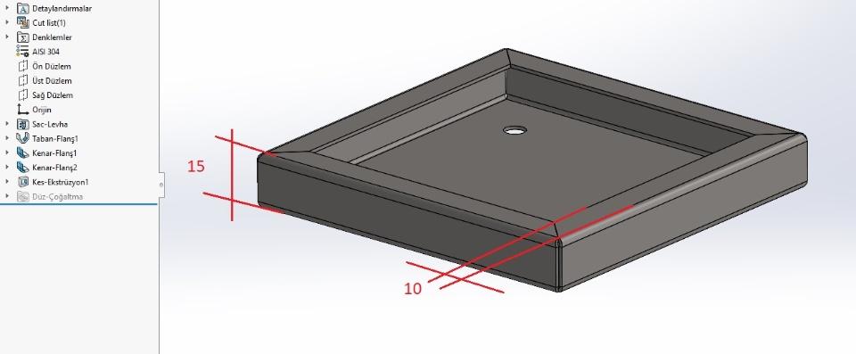

Macro Edge Flange Help
Hello
I typed the macro code for our standard sheet metal parts but still I couldn't finish it. Could you help me to add edge flange to my sheet metal parts. You can see picture and codes below
Macro Codes;

' Edge Flange
End Sub
