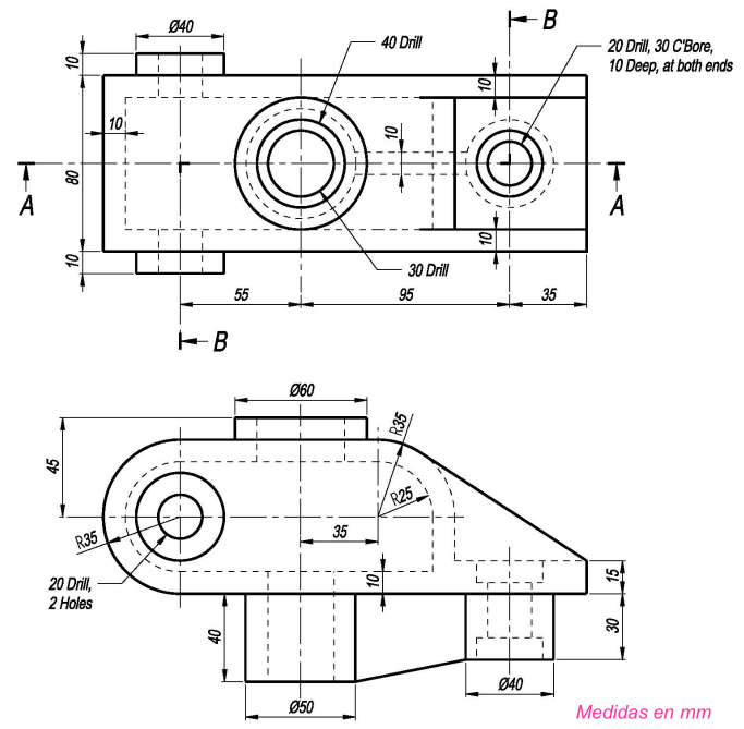

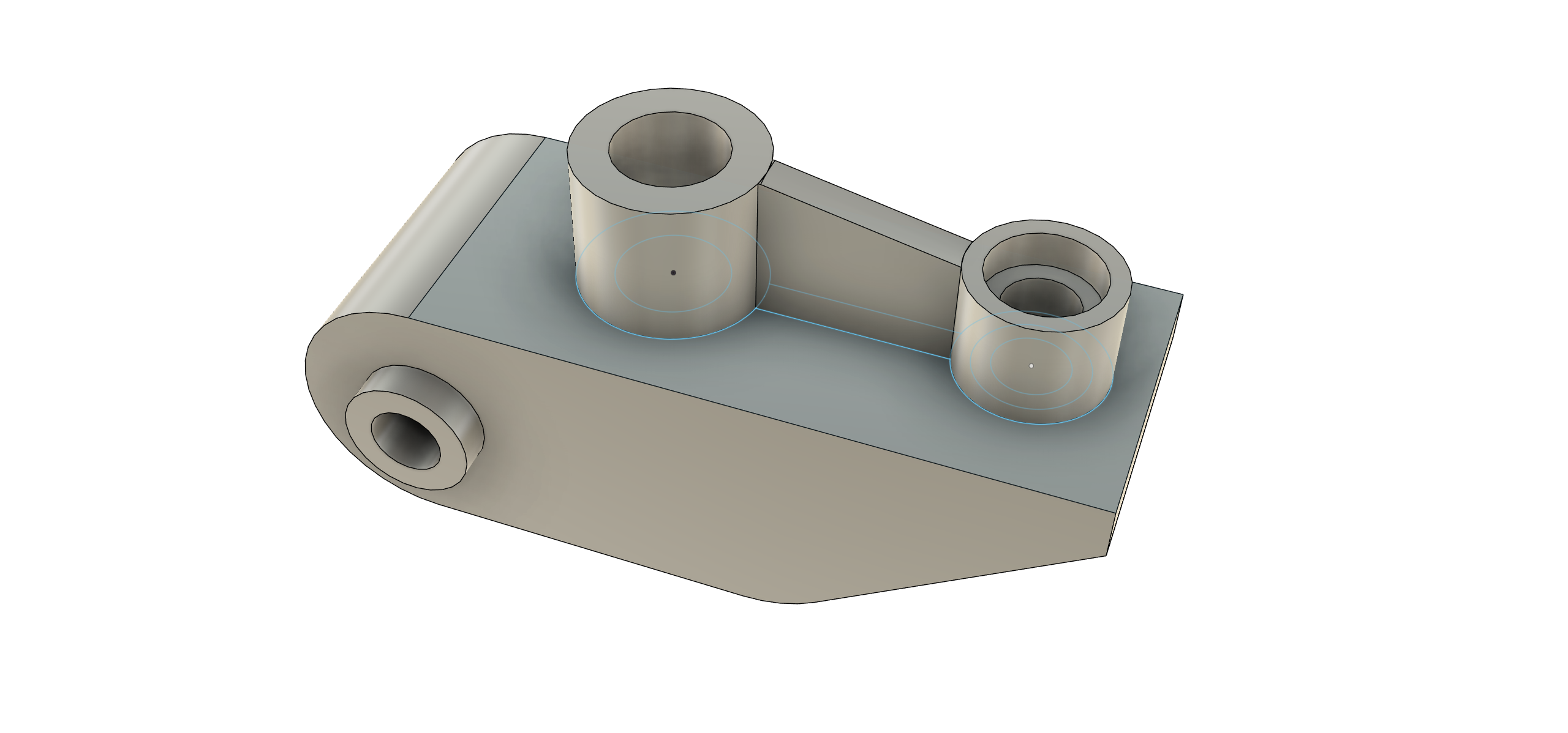

Could someone model this piece and explain to me how to do it? I'm a little new and want to learn about modeling. (The measurements are in millimeters)
Is this a complete drawing? The cross-sections A-A and B-B are missing

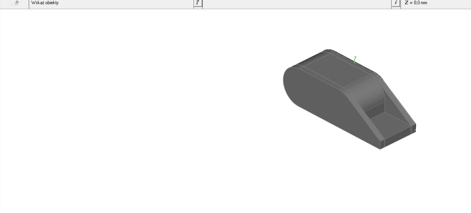

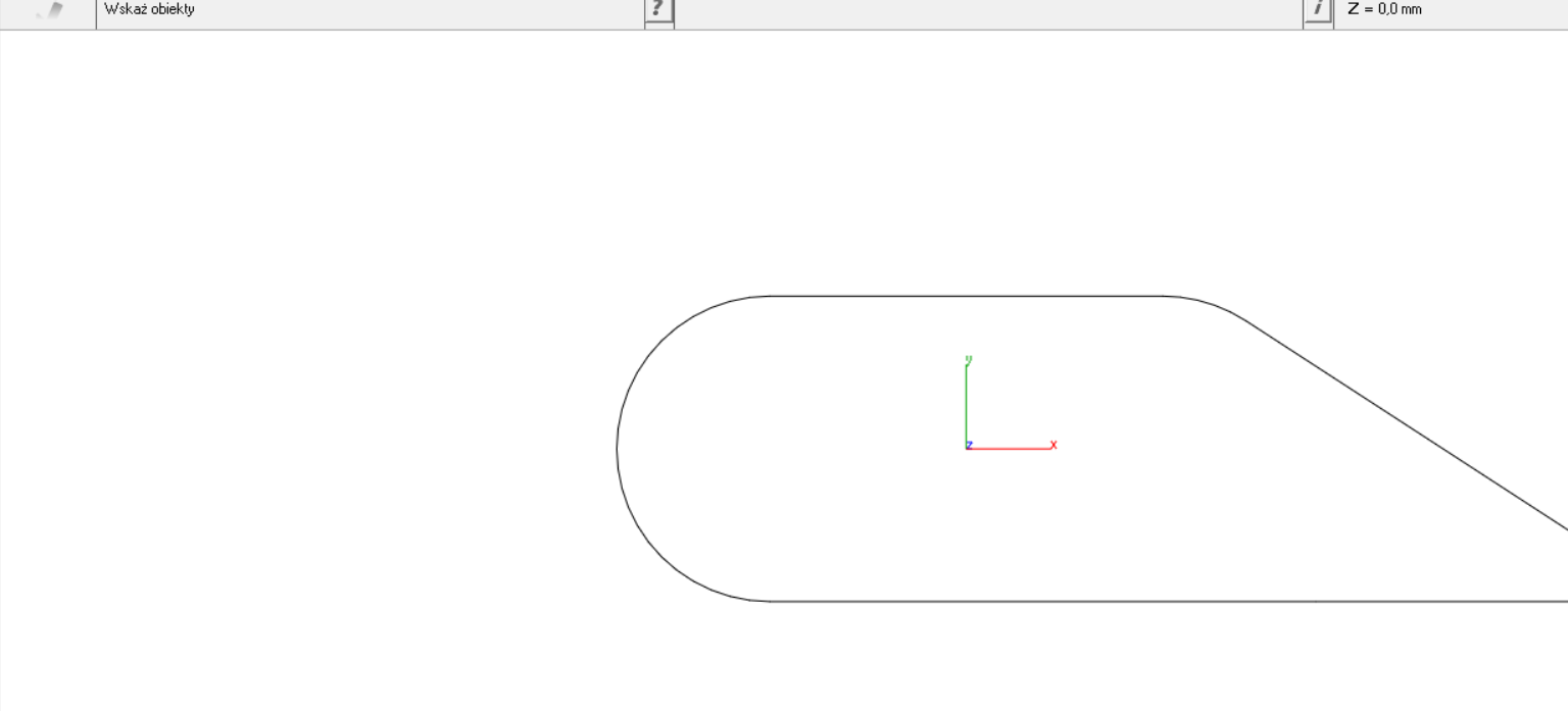

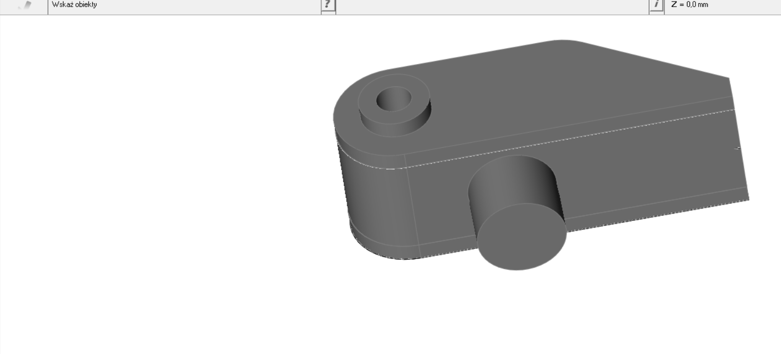

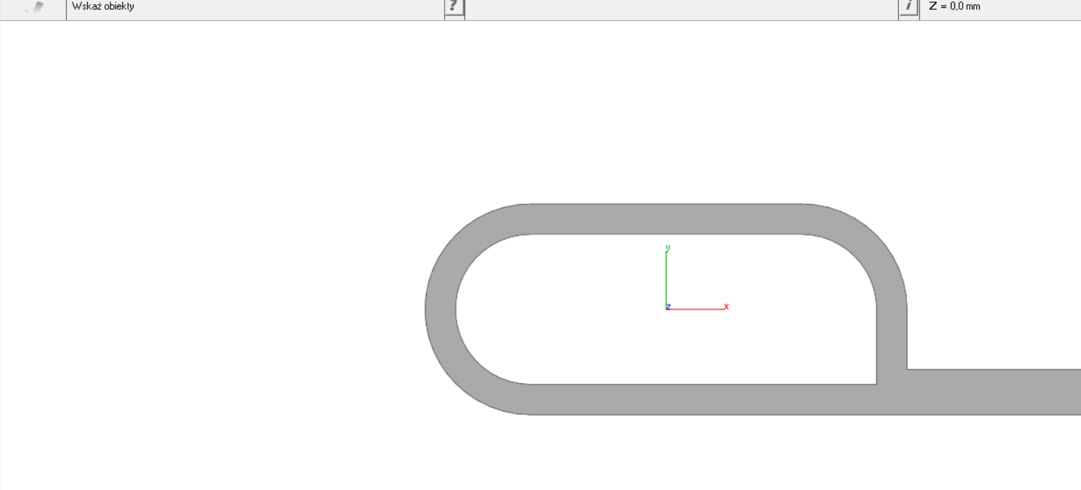

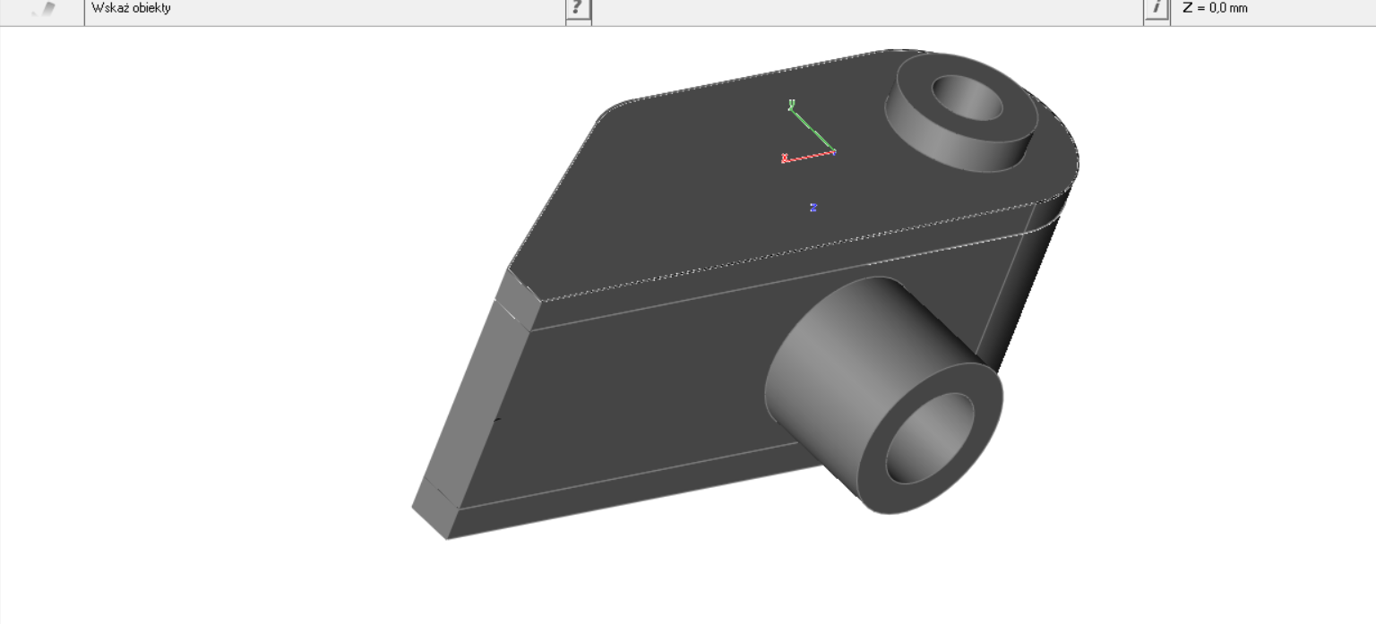

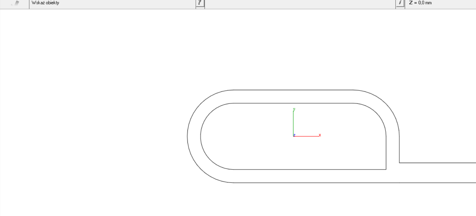

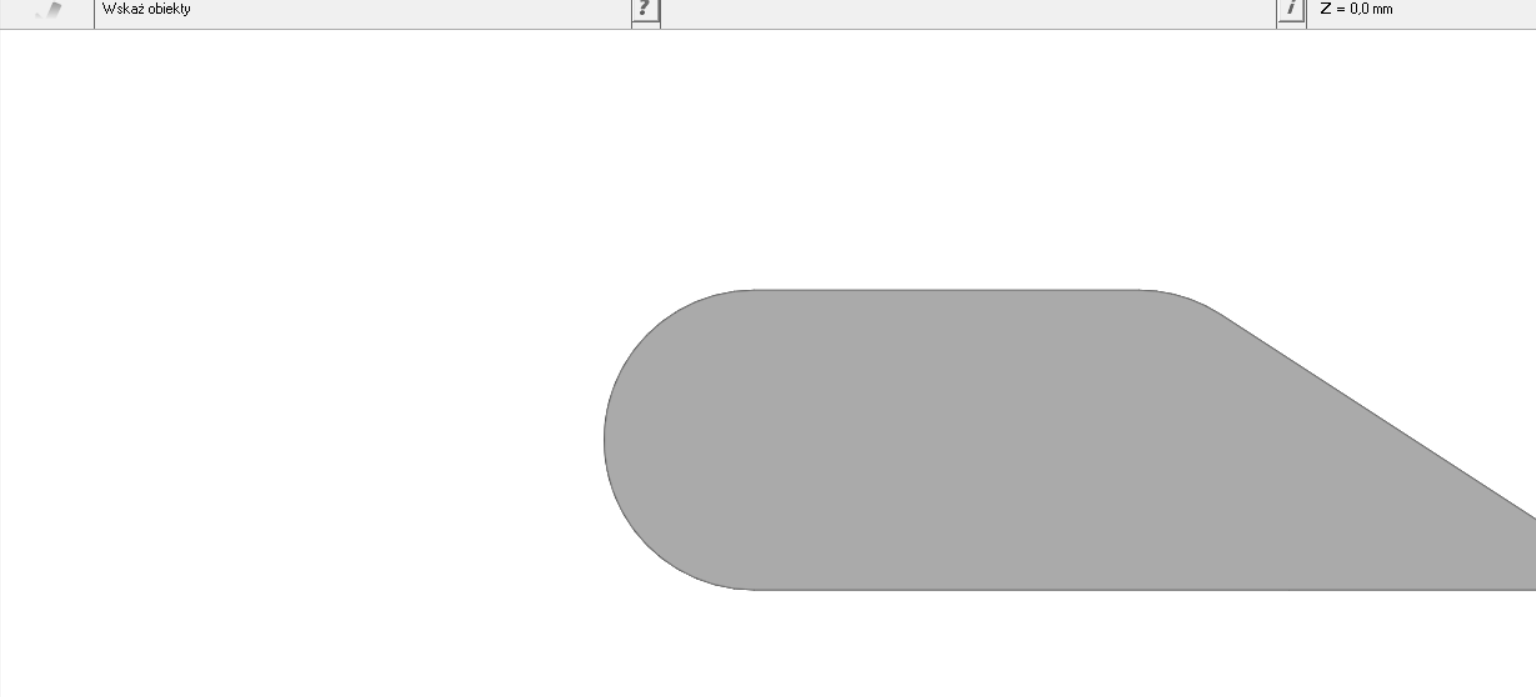

Front Sketch
Front Body: Symmetrically Extrude Boss, Extrude Body, Extrude Cut inside.

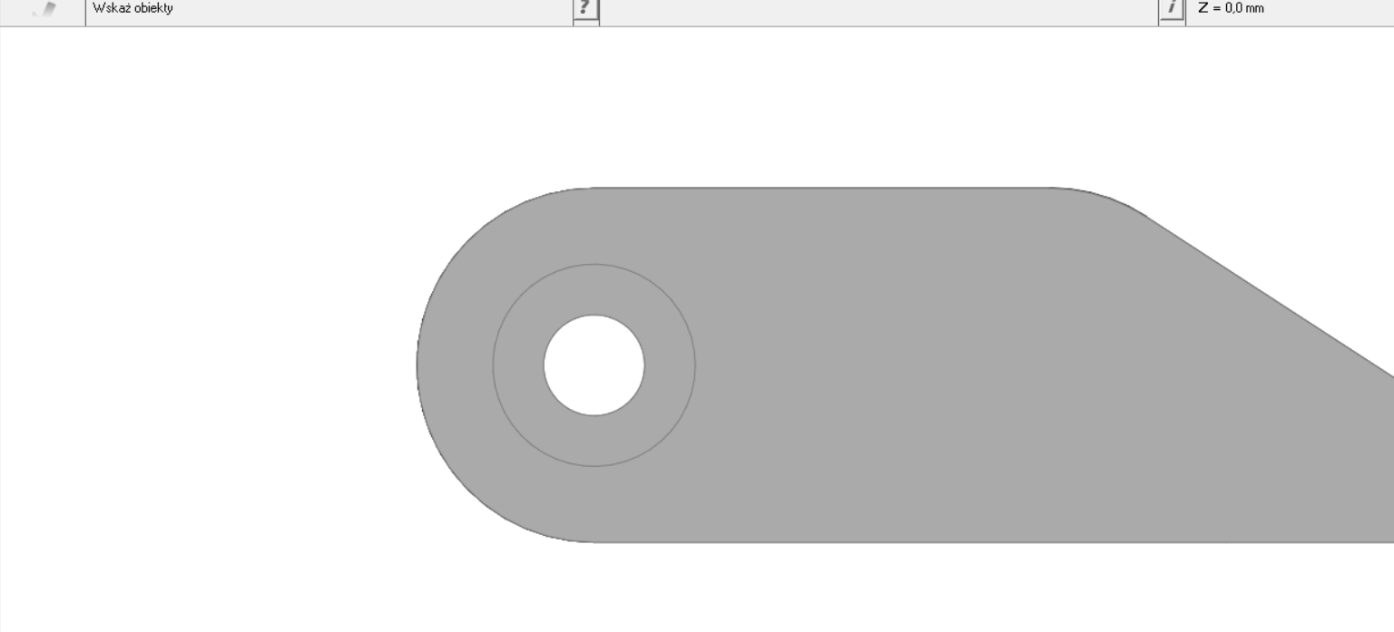

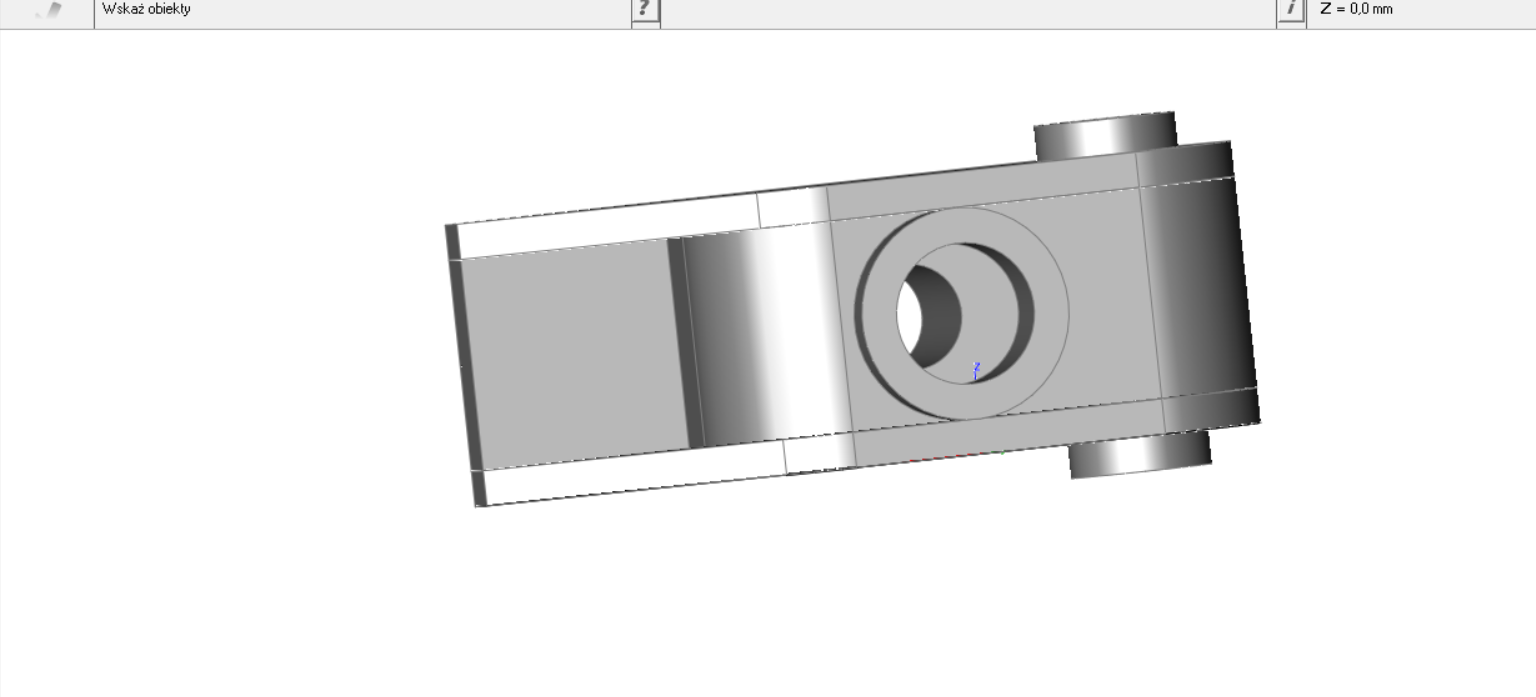

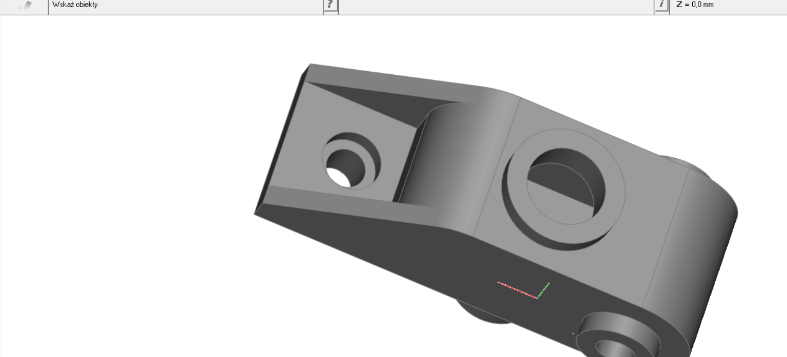

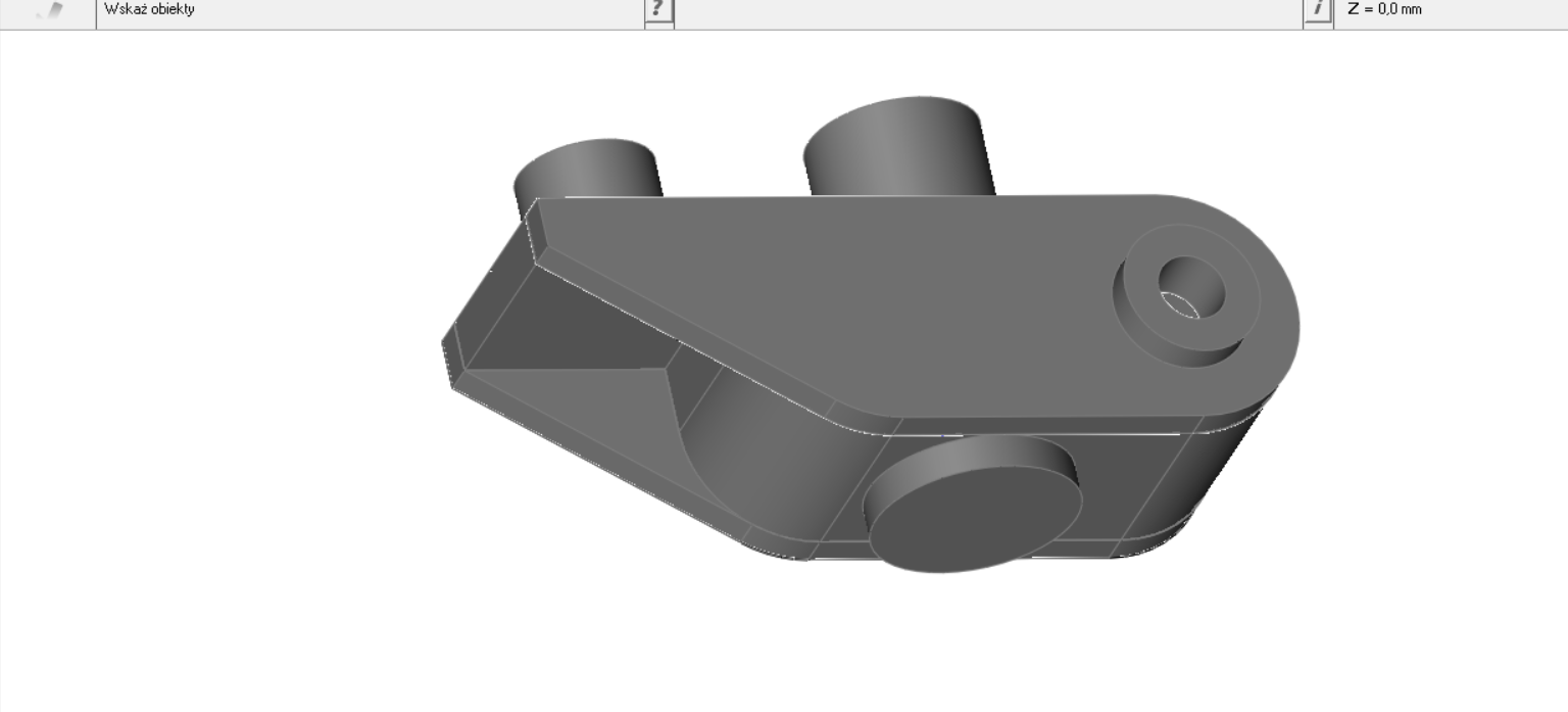

Bottom Sketch
Bottom Body: Extrude Cut holes, Extrude Bosses, Extrude Rib, Chamfer Rib, Extrude Cut C'Bore.

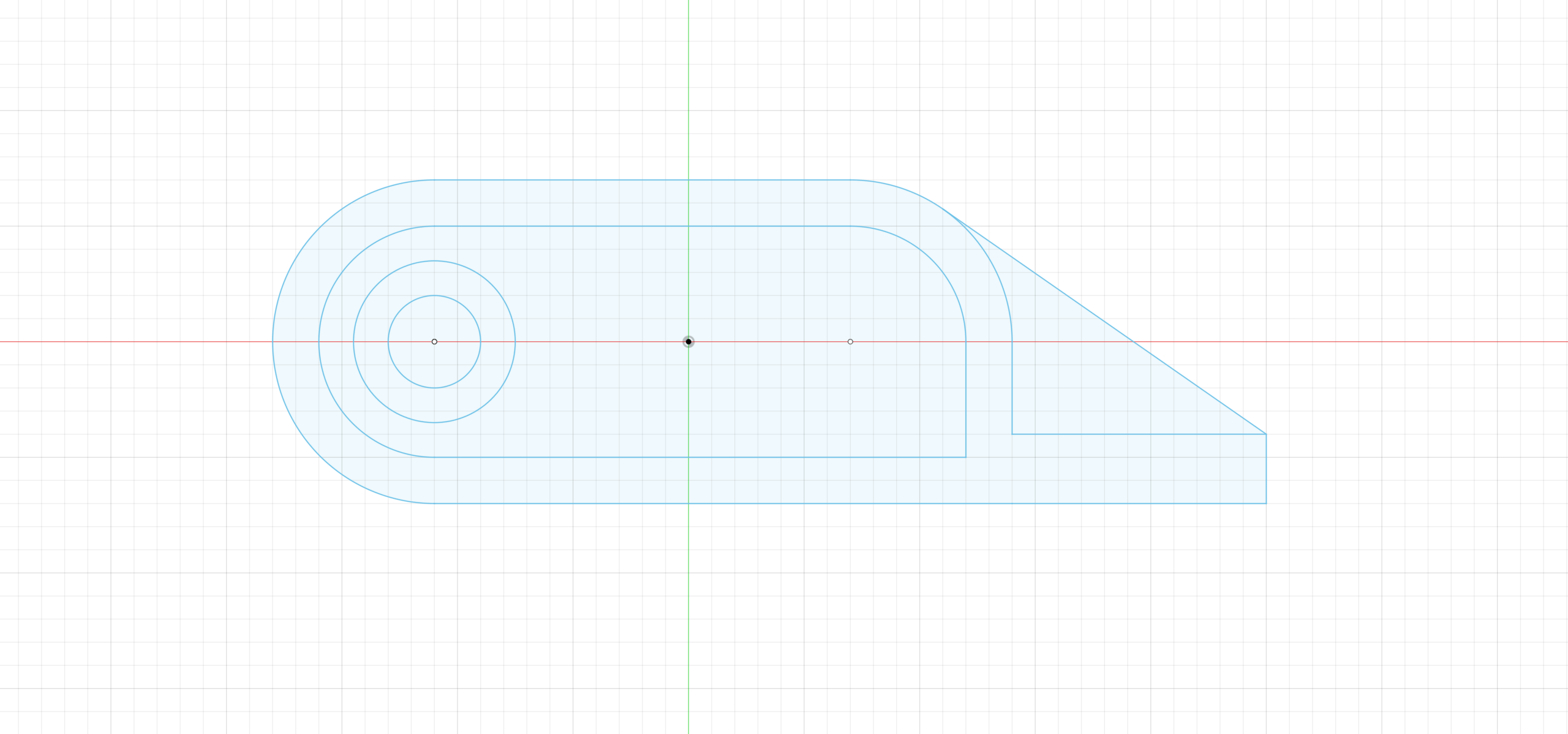

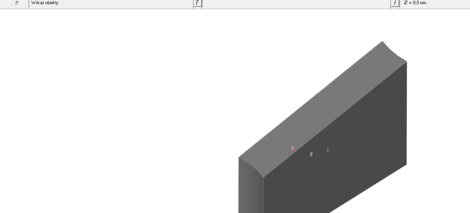

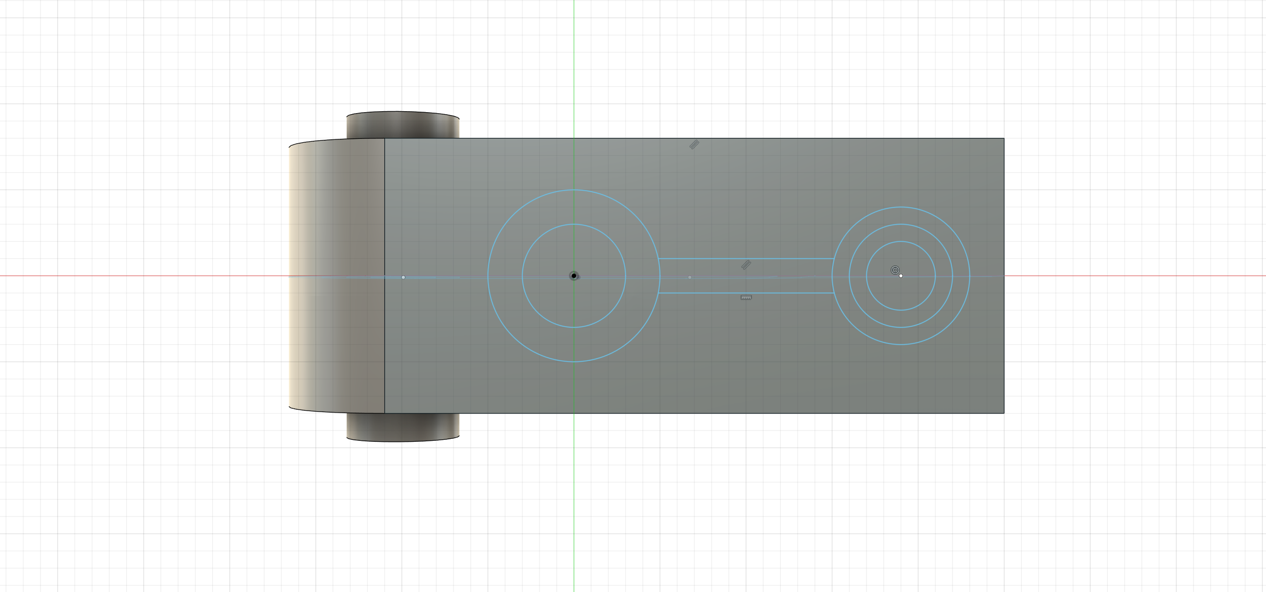

Top Sketch
Top Body: Extrude Cut Hole, Extrude Boss, Extrude Cut C'Bore.

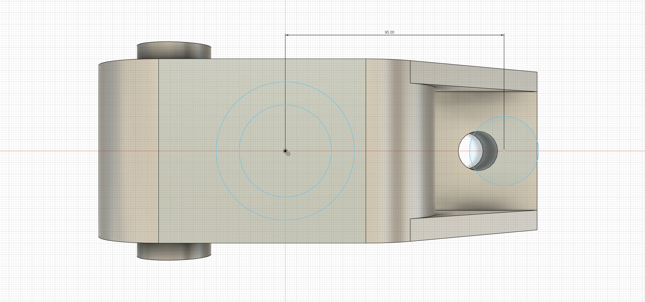

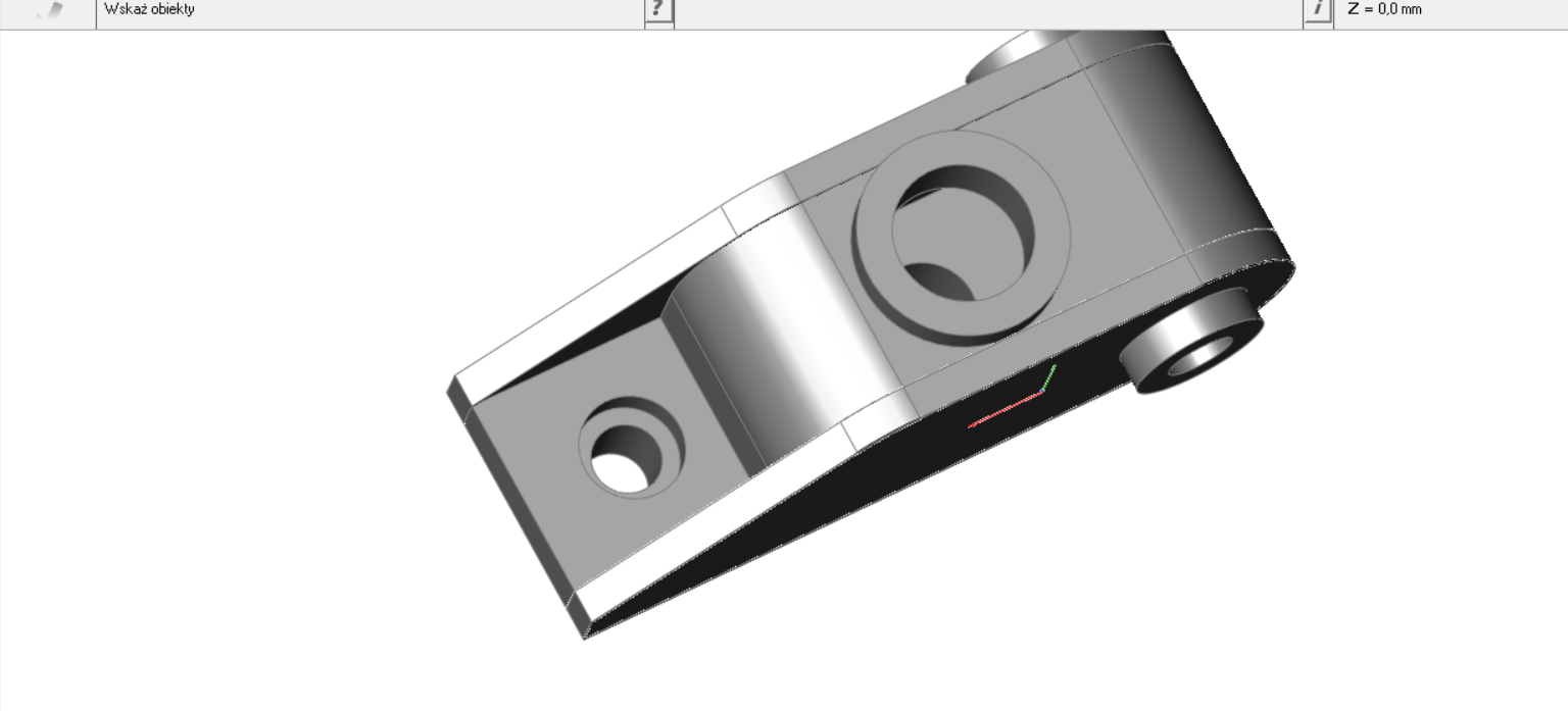

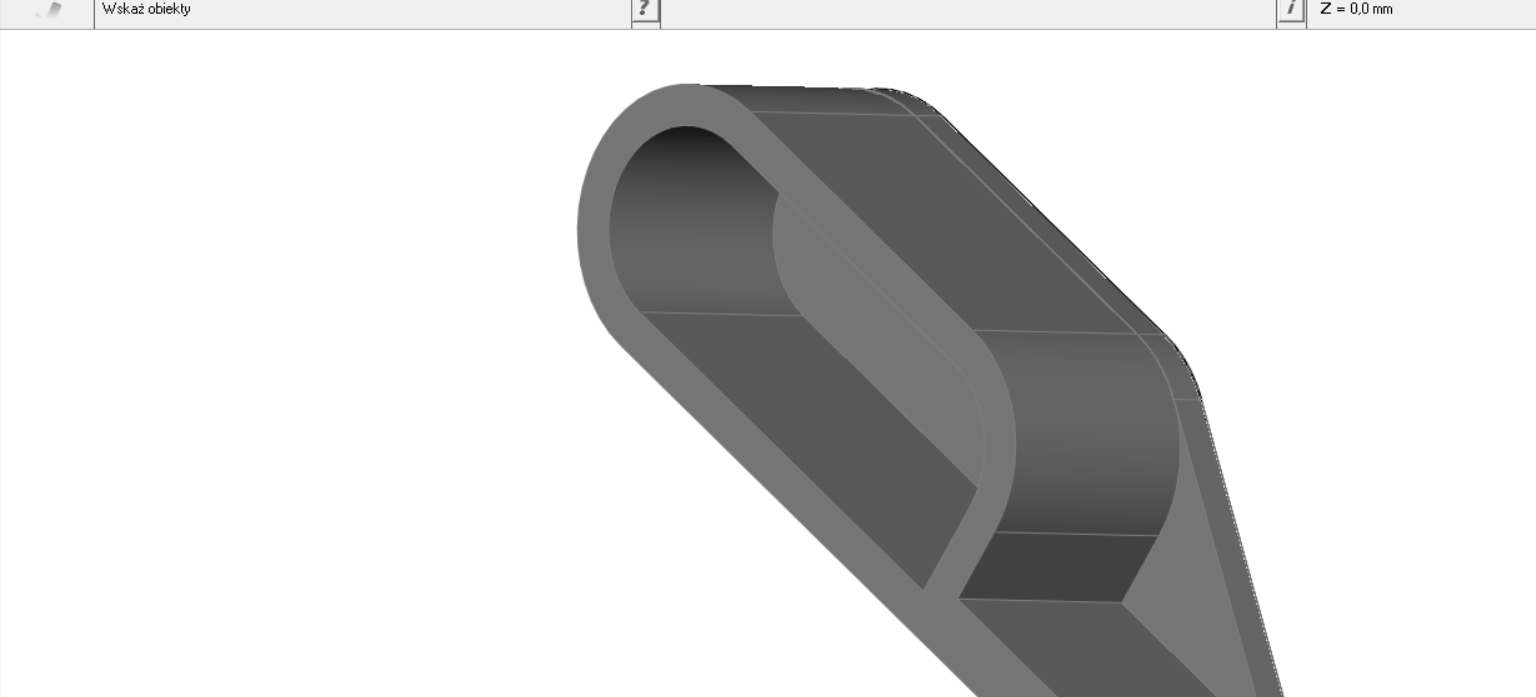

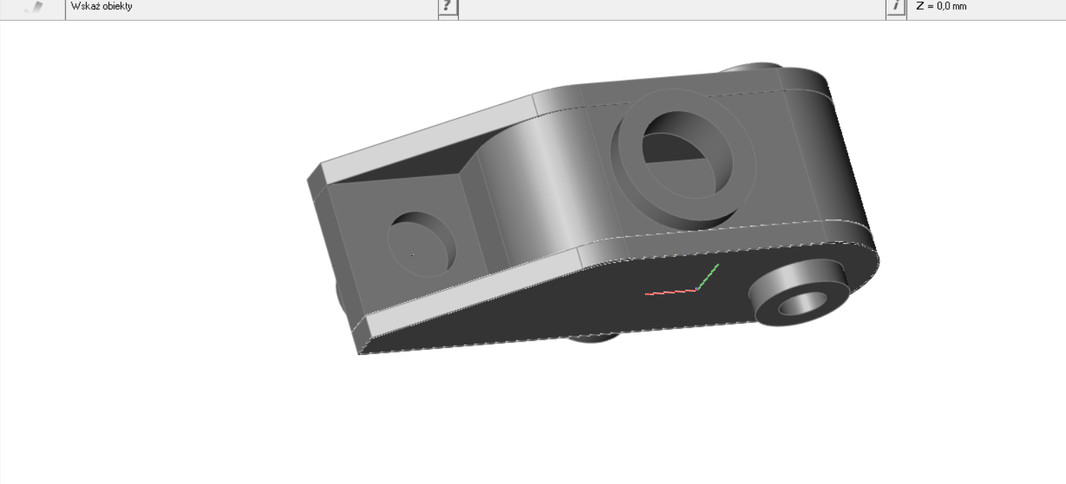

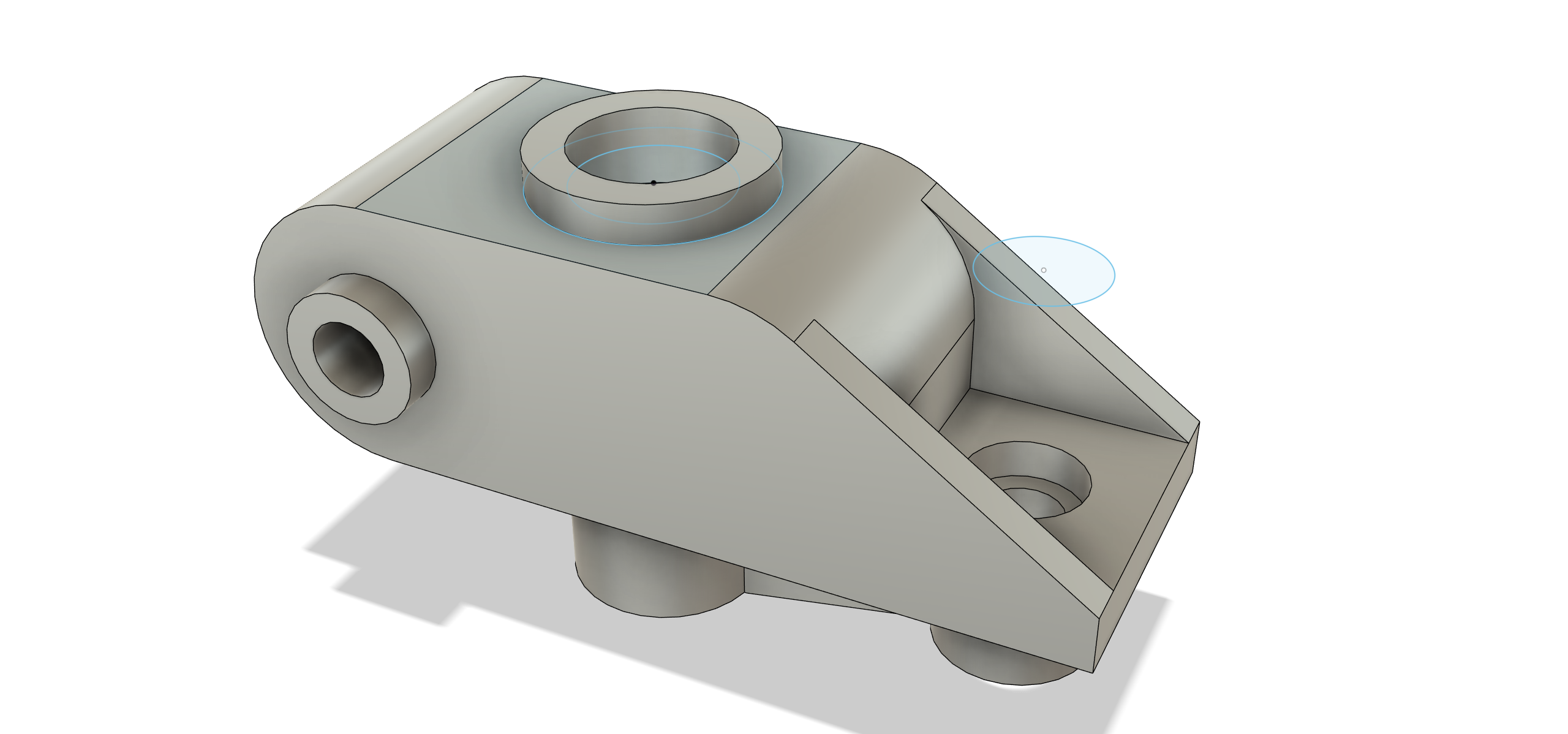

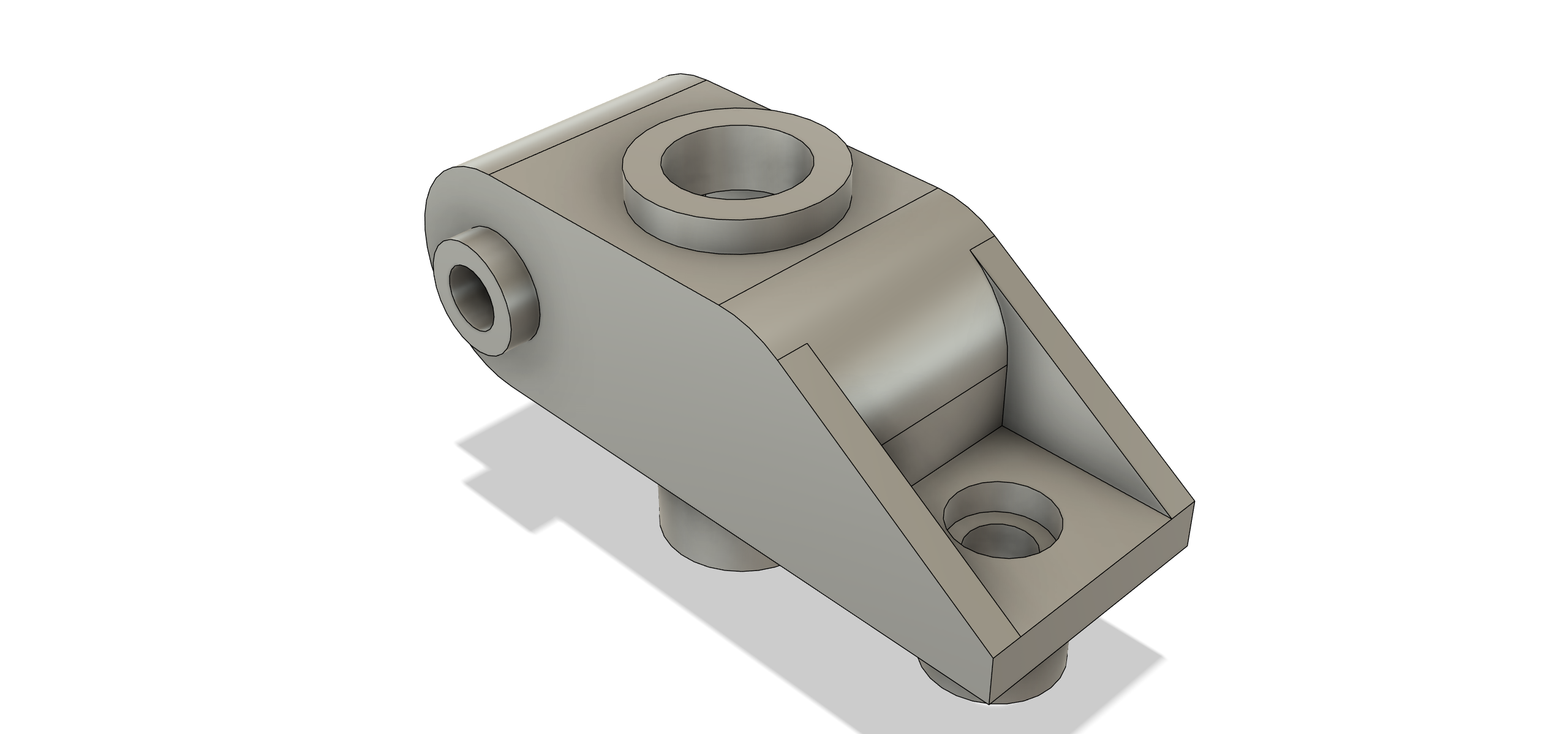

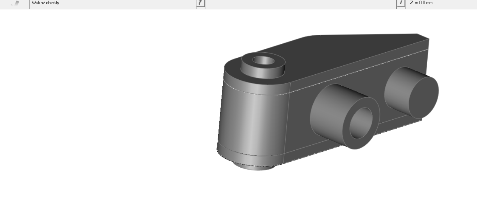

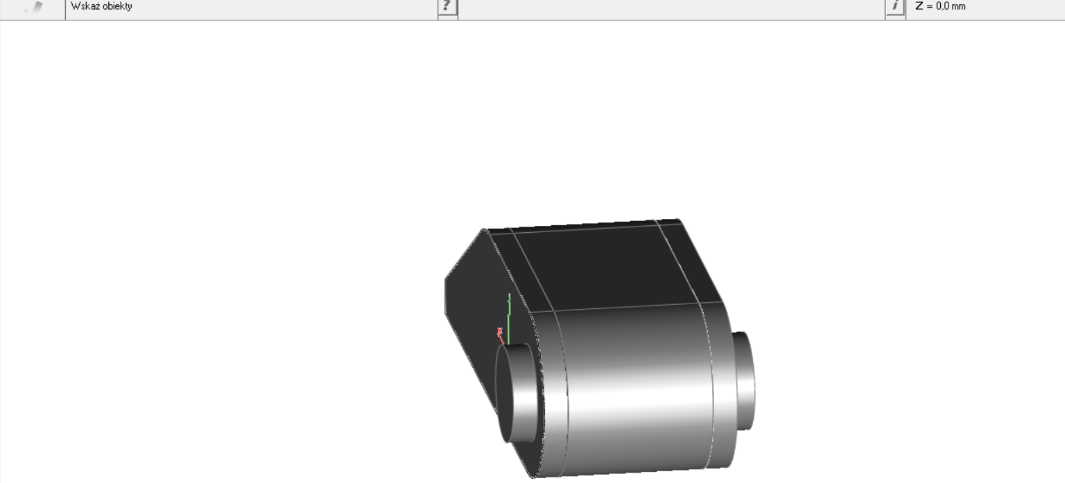

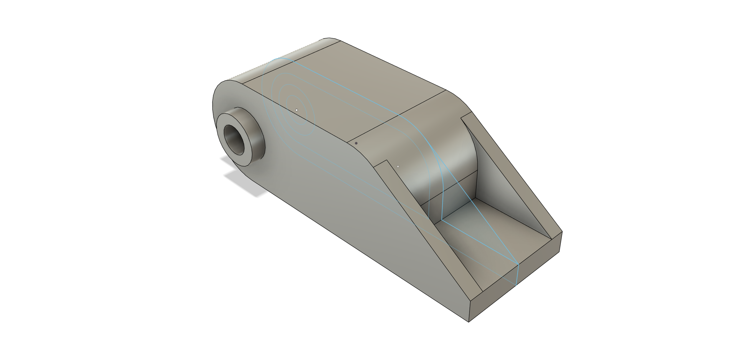

Finished Model.
Model Drawing.
