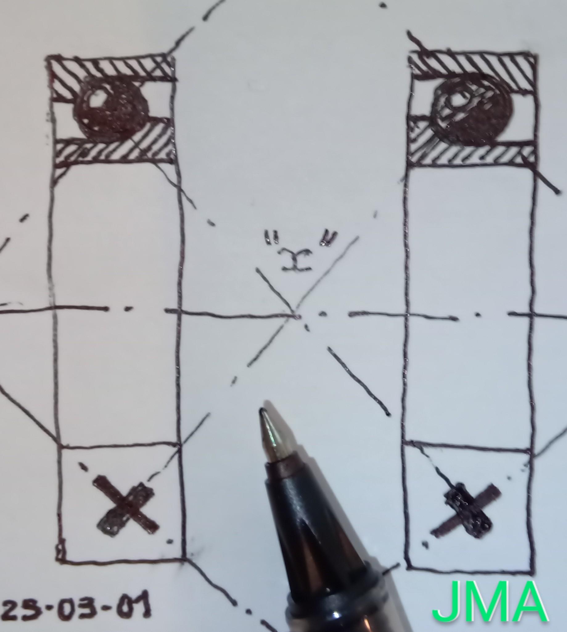

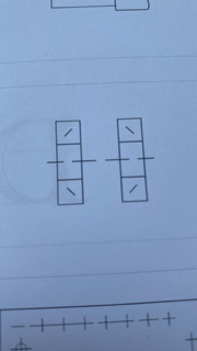

Need help in understanding what is this drawing means Hari Prasad Ravichandran 1 Mar, 2025 05:08 AM A mechanical assignment, what this symbol represents. What is it called. unnamed.png 1 Answer JMA Answered on 1 Mar, 2025 12:48 PM Excuse me Mr PRASAD, I was mistaken, your bearing assembly is in "X" and not in "O". What defines this configuration are the axes connecting the points of tangency and not the axes (of your symbols) of the junction planes of the rings. IMG_20250301_134014_245~3.jpg
