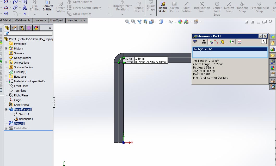

I attached the image. If you can solve this it will great help. Solidworks always showing . 5 mm radius even if thickness is changed. Help. Thanks

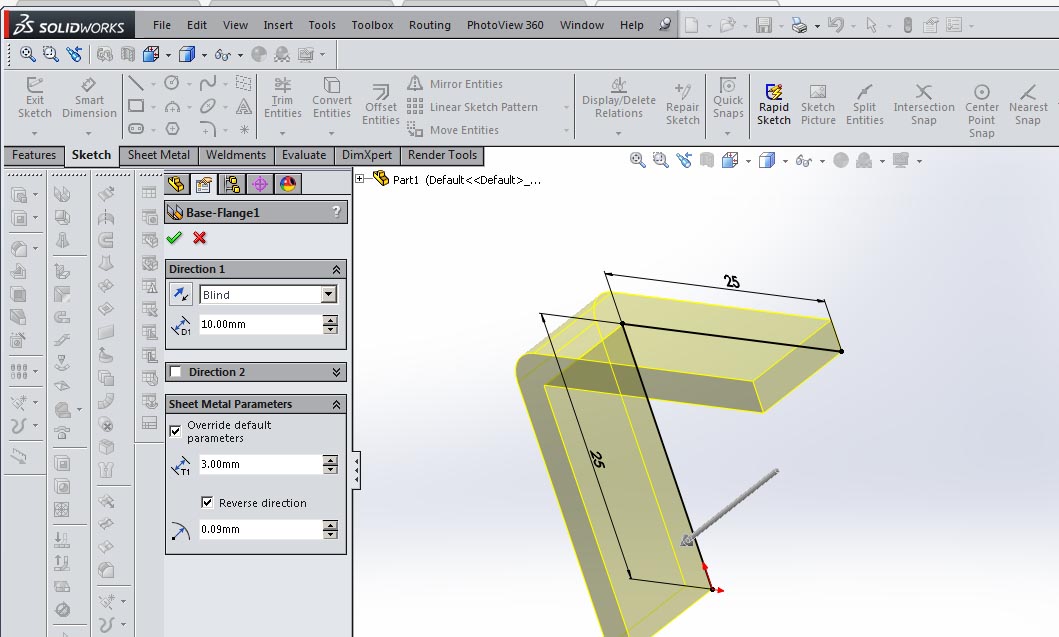

The radius is 0.09 mm, this is in a theoretical case.A sharp radius as this is difficult to make in practice. I took a K factor of 0.5, an usual value.
Surely, local deformations appear in your case
