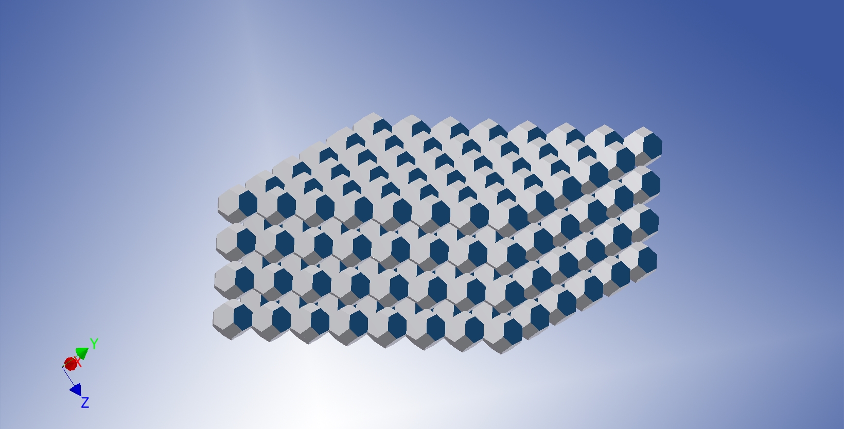

Hi I have one question is it possible to create more unit cell in one large cube? or should i assemble each unit cell to create a cube like structure?
you can adjust the Patern till you get what you want

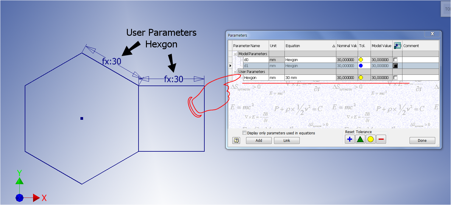

You can use Userparameters so that both sides are equal
