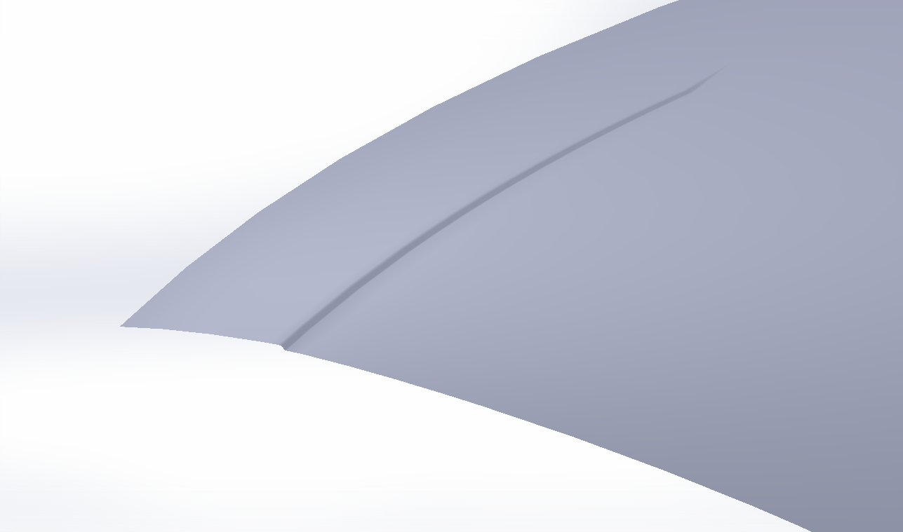

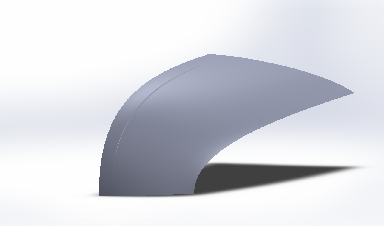

O.K. guys! This is my first request. How can I reach effect like wave (see pictures attached as an example) with a maximum control regarding to one surface only. If you know any possible way please let me know.

Thank you for your time Applied Rapid Technologies. It is maybe useful tool but in the future version of SW. I am thinking how can I get this effect what is on view on image attached and don't create additional surfaces.I am very close to believe that it isn't possible. But I am very curious as well, what is your way to have this shape use surfaces as many as necessary?

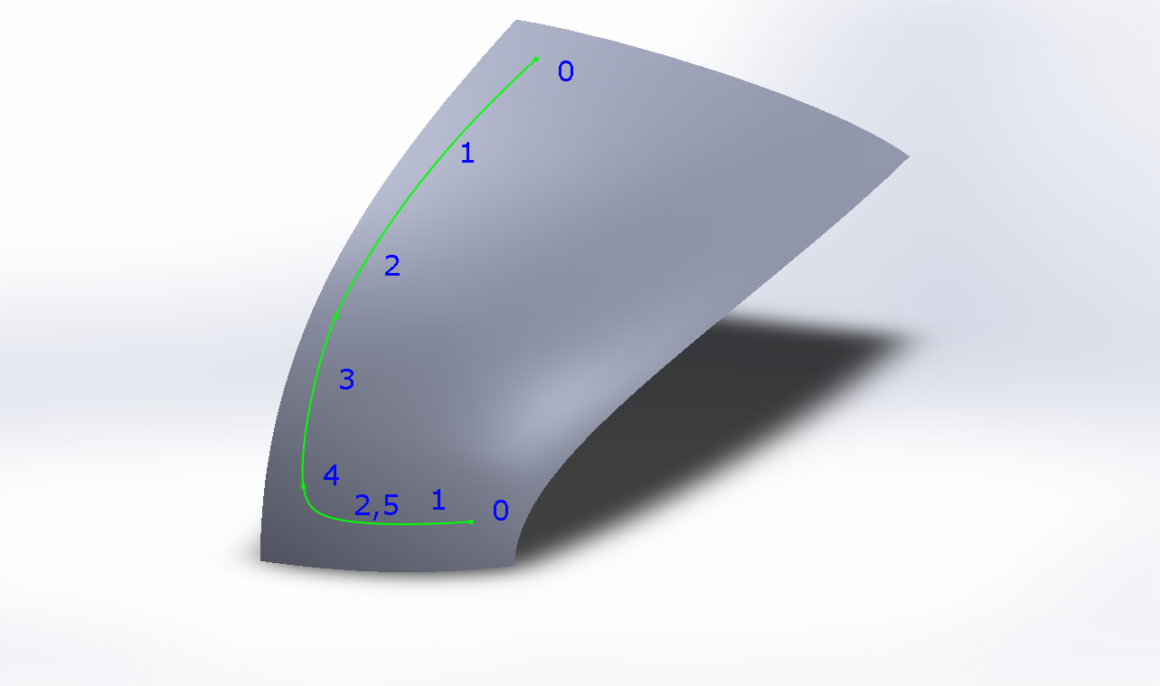

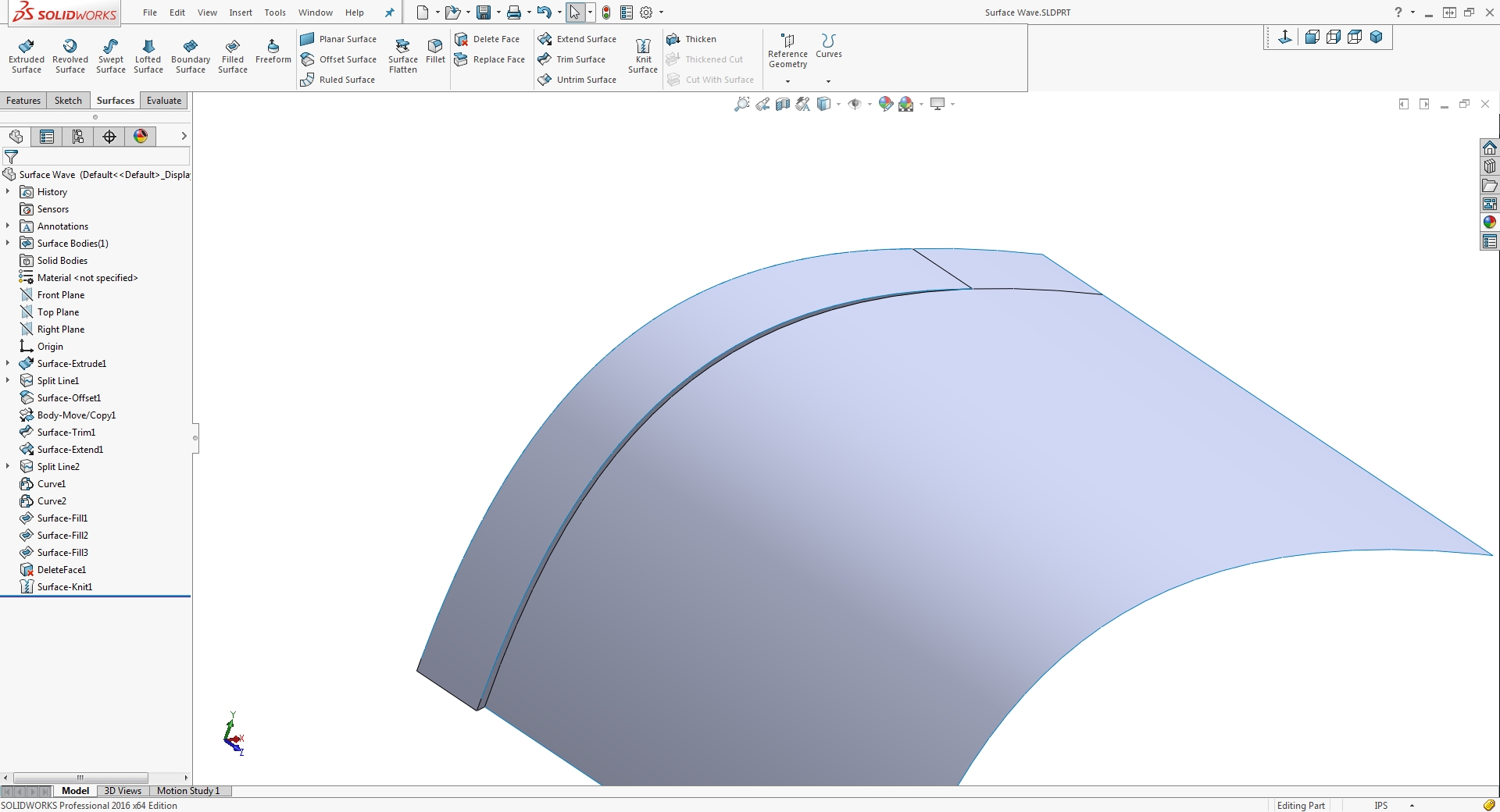

A SW 2016 model is attached that looks like what you are trying to create. I've also attached a screenshot and parasolid model.
I'm not sure that this is the "best way" to create the shape, but you get good control of it.
The Indent command could also be a good choice.
