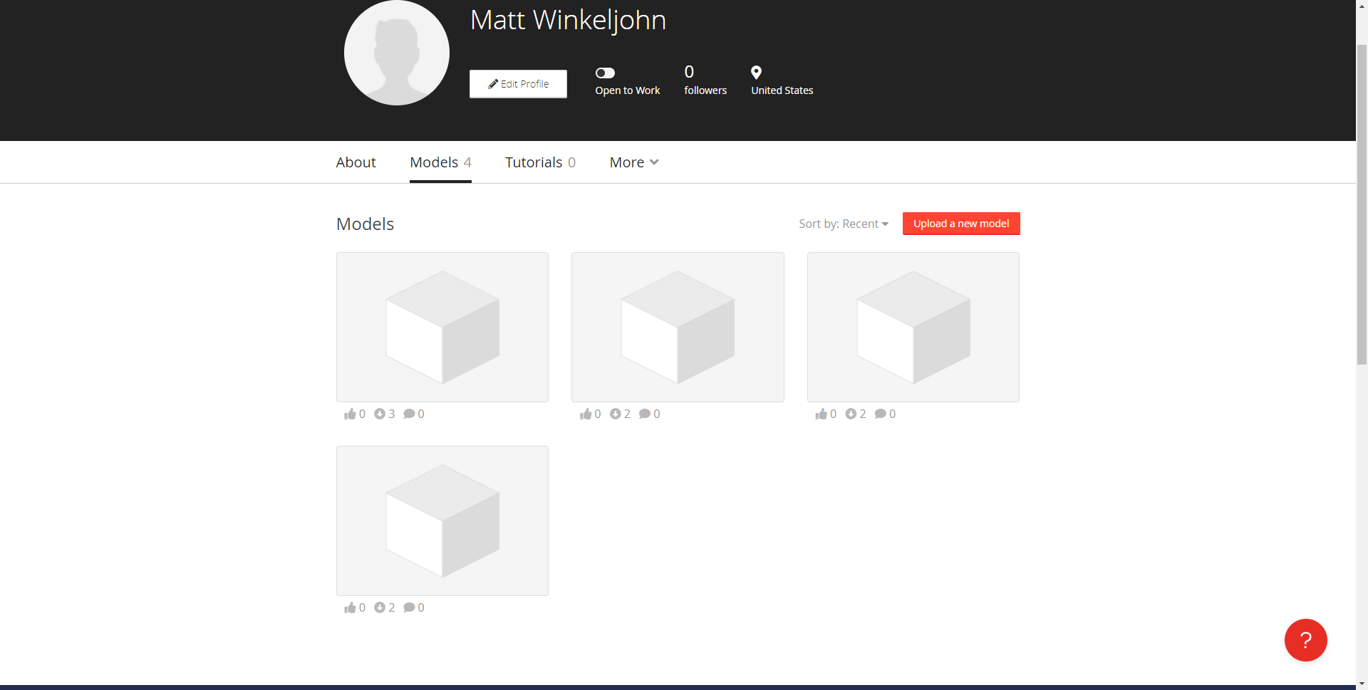

Why are my previews or model views not showing up on my uploads?
It's been three days since I uploaded files and PDF's, and am getting thumbs down votes because the 3D model isn't showing up, or any of the previews.
