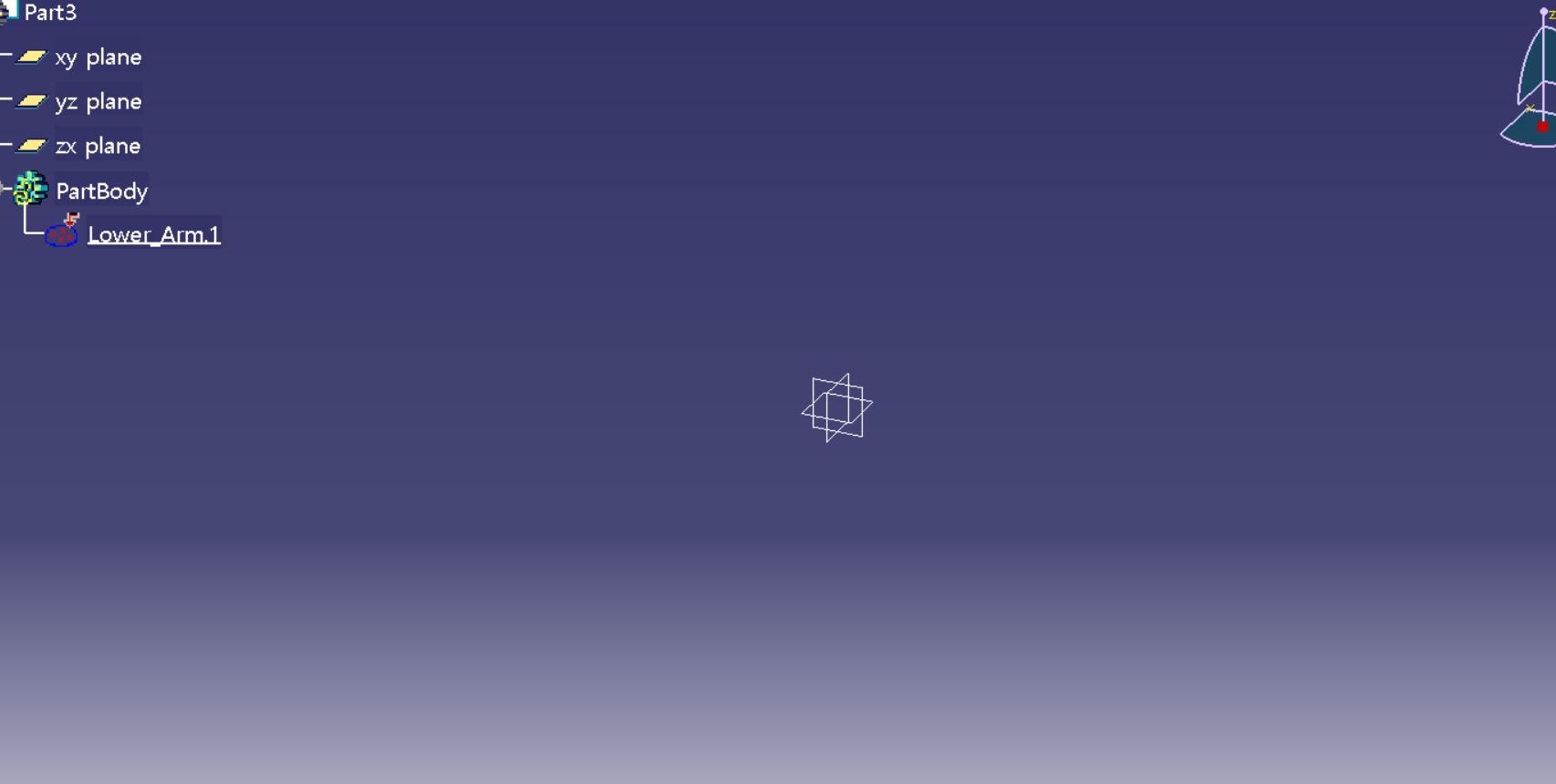

Why stl file does not appear in Catia V5?

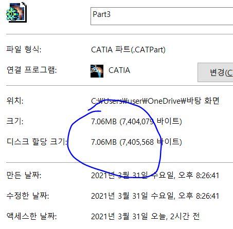

I got stl file from 3D scanner and when I open it in part design I can see the model but it does not work with Digitized Shape Editor. When I save the file with Digitized Shape Editor, according to it's size, Catia definitely have data of it but it does not appear. Is there anyone who knows how can I fix this problem?
Try the FIt-All-In viewing tool. Maybe the point cloud is outside the screen? Also try right-click on cloud in the tree and choose Reframe On to see it. The tree shows the part also needs to be Updated.
